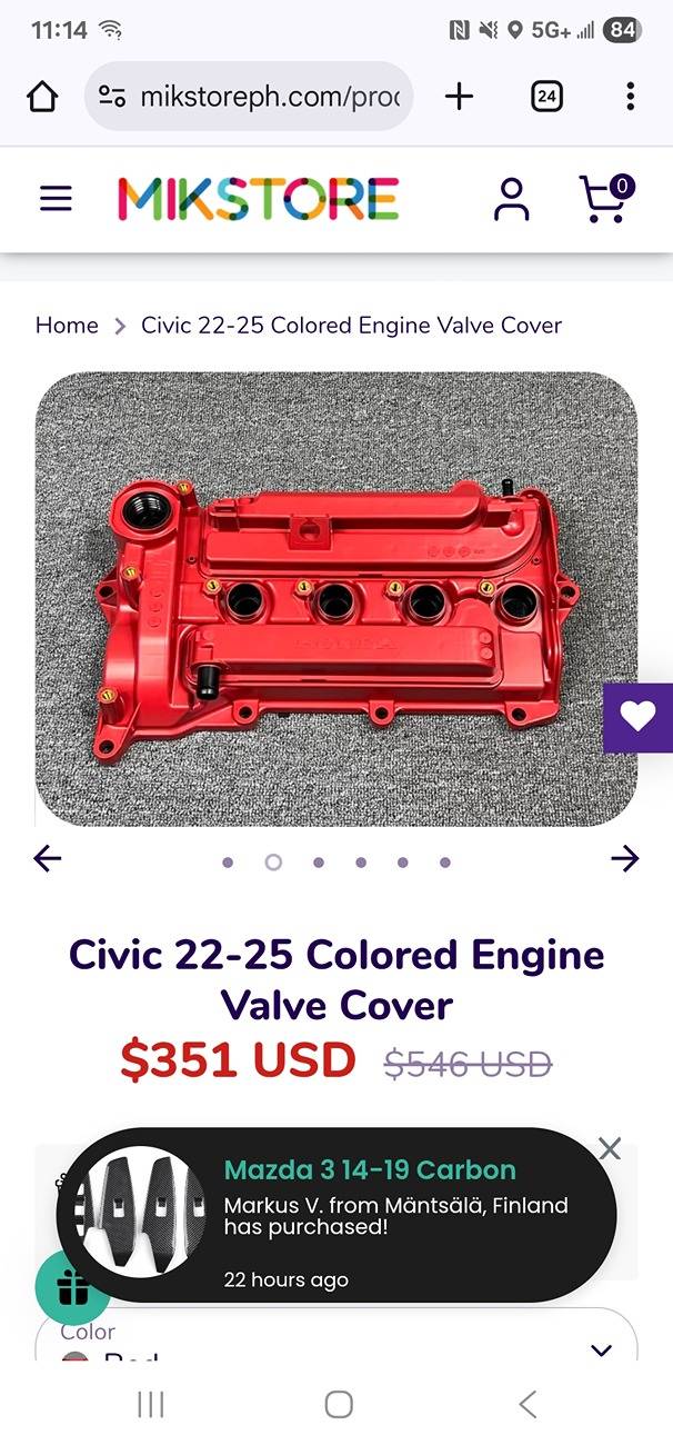

There's a valve cover on Mikstore that I desperately want. The engine bay right now looks so boring and cheap. The problem is, I'm under factory warranty. Mikstore claims that it's an original Honda part, so I'm wondering if I could convince the dealership to put it in for me? Seems like if I put it in myself it would void the engine part of the warranty at least.

As long as the cover is a genuine Honda part with new Honda gaskets, this should not be a warranty concern. That assumes the new cover is installed correctly.
The Honda cover has extensive internal baffles to reduce oil in the PCV system. I'm guessing this is the reason the aftermarket doesn't sell non-Honda covers.

I’m guessing it’s just an OEM cover that’s painted. Should not be a warranty issue

Don’t even go to the dealer for it. If you ever have a warranty issue and they look at it, tell them it’s OEM painted.

The engine currently does not have a valve cover. It didnt come with one. Currently it's straight plastic around the engine, but this part I'm looking at is metal that's been cerakoted. Which is why I'm actually a bit skeptical that it even is a genuine honda part, although I've bought from Mikstore before, and theyre reliable.

The 11th Gen Civic the OEM valve covers are plastic. The Mikstore covers are OEM covers painted.

Yea, it's Cerakoted plastic, like TSP sells for the 2.0.

Omg yeah yall are right; I can see it now. Welllll I'm not paying $350 for painted plastic.... thank you for saving me from getting something I didnt fully understand!!

If you're just looking to add color, you can always paint yours or buy a 2nd OEM valve cover from a Honda parts retailer for like $100 - $150 and paint that one or get it painted.

Did you check the shipping? Because they are overseas and shipping can be pretty high. So way more than $350. Just buy a new one from Honda and paint it.
