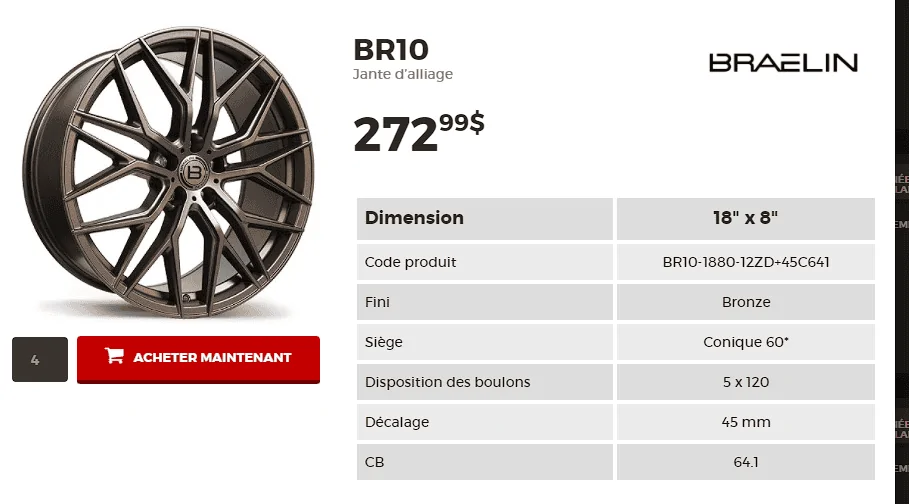

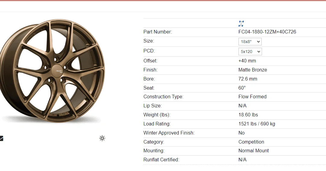

looking to buy a winter kit, 225-45-18 Bridgestone ws90 with those fast wheels or braelin. Will those setups fit well?

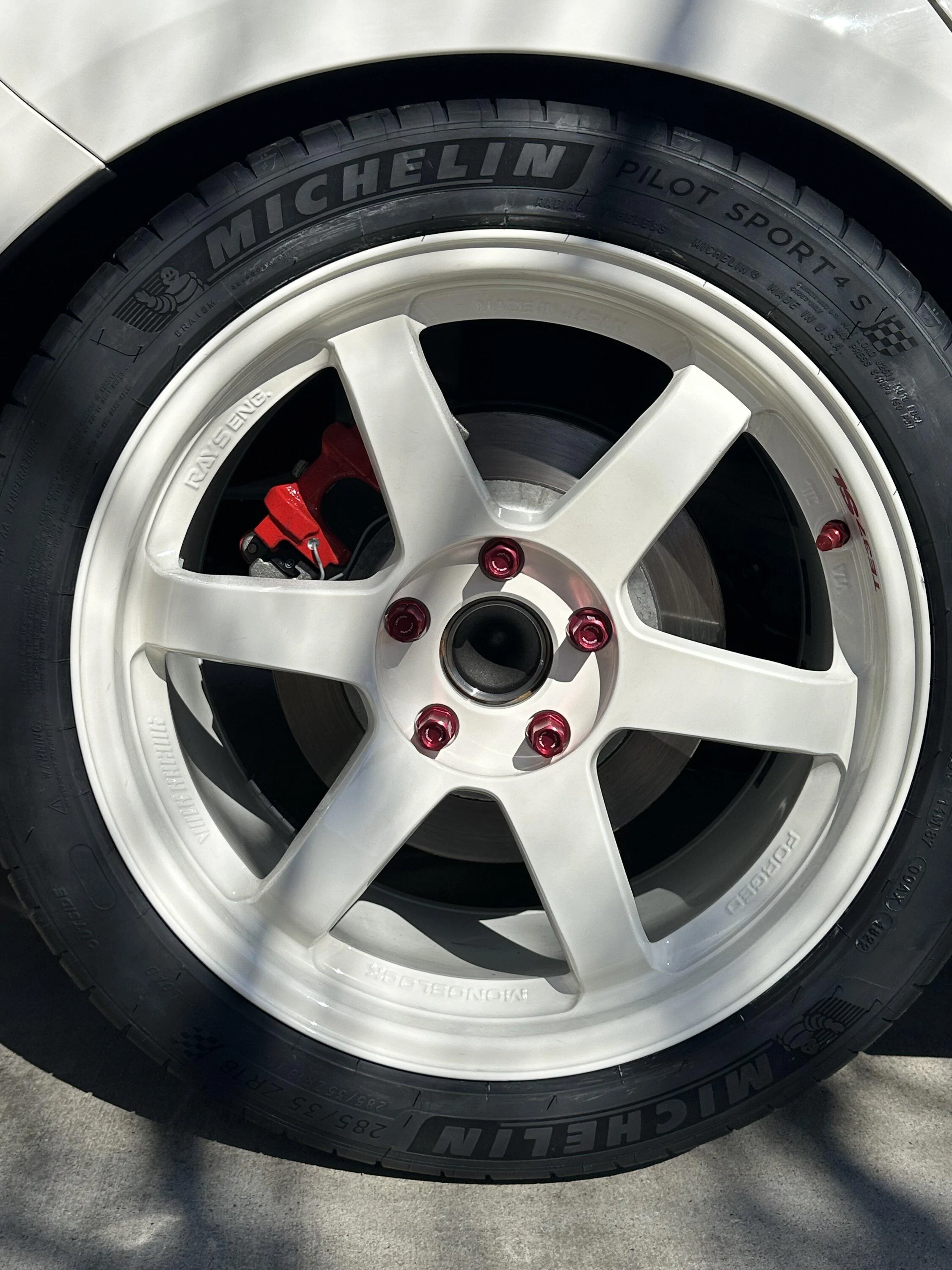

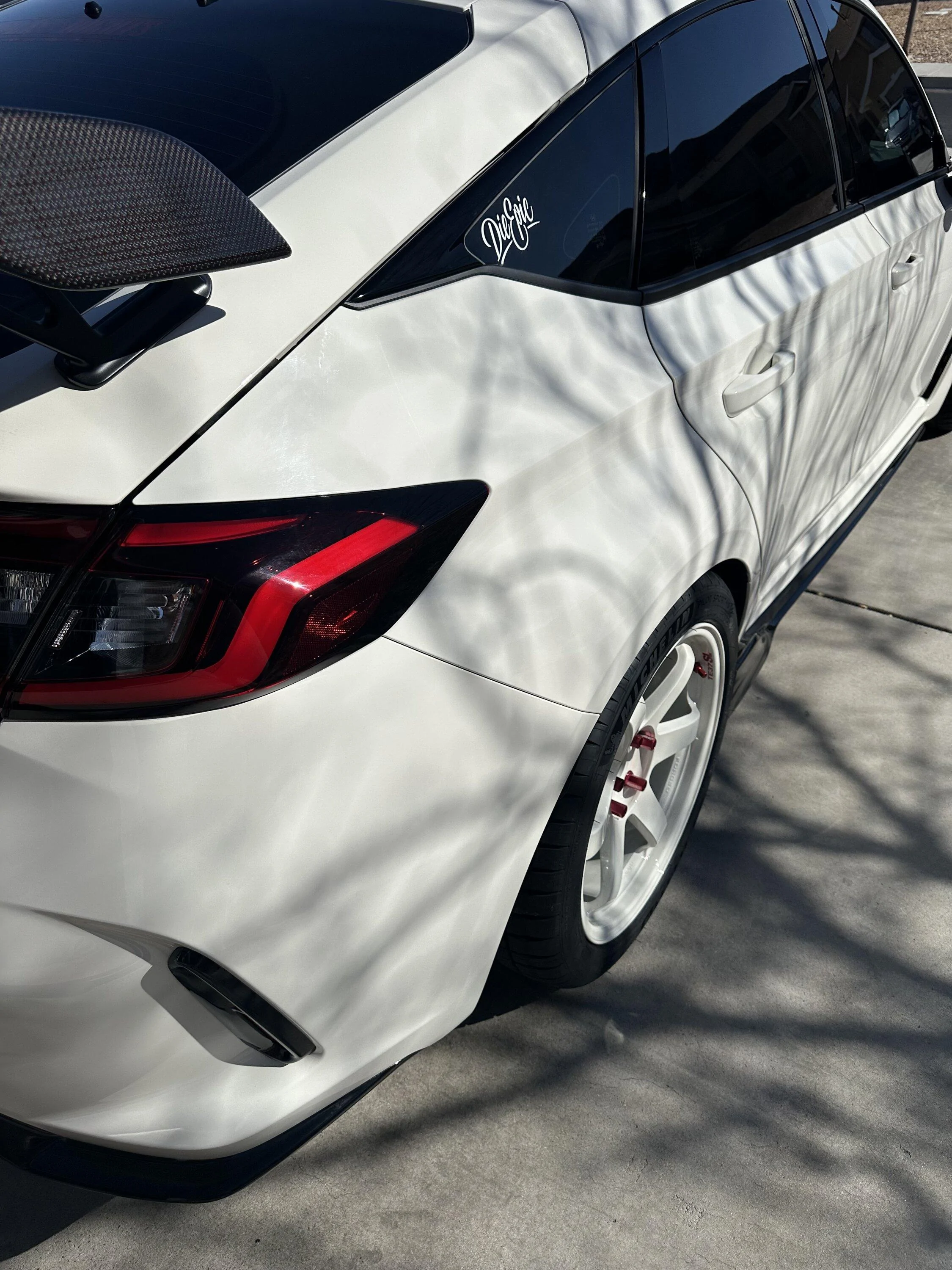

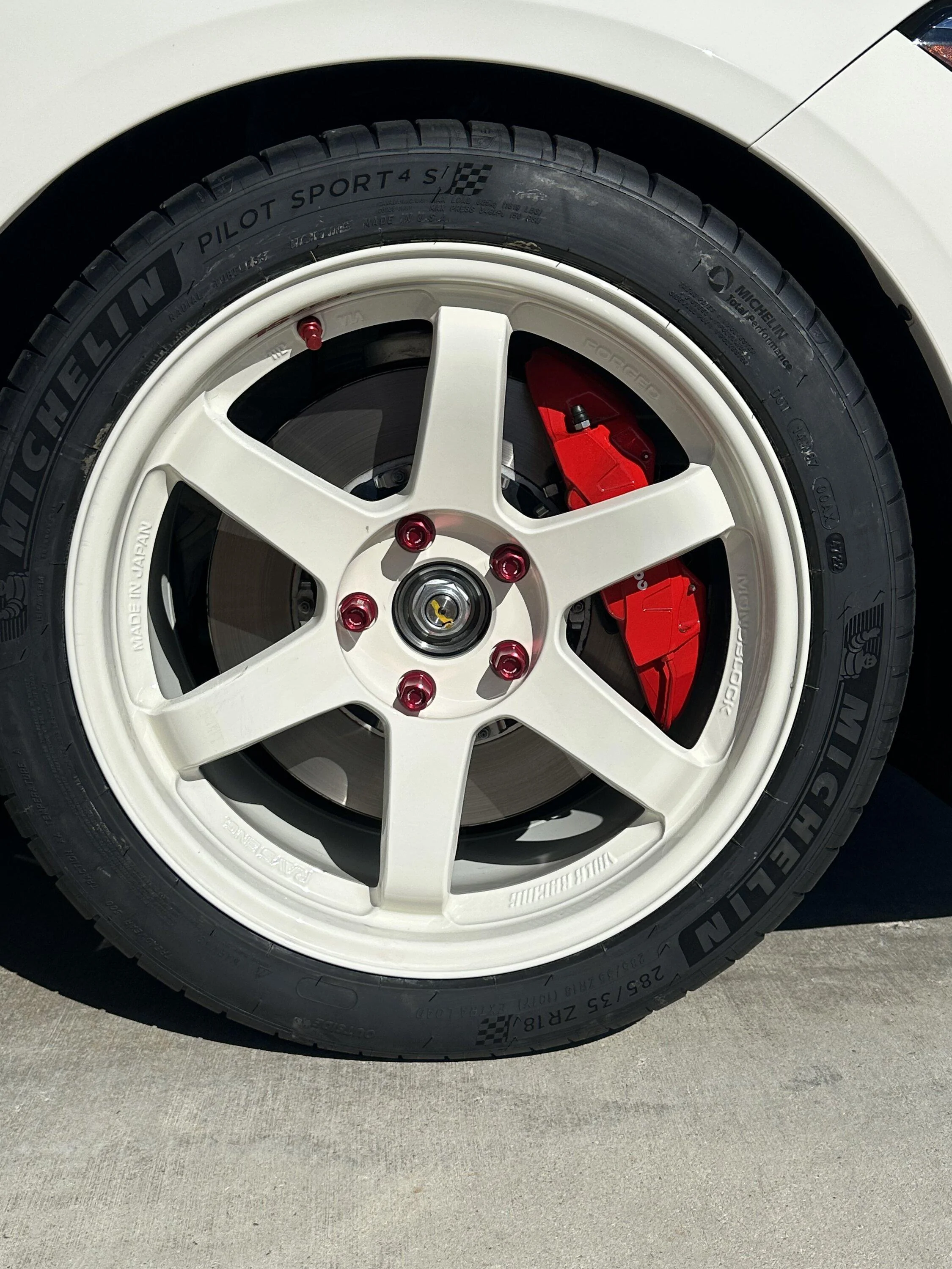

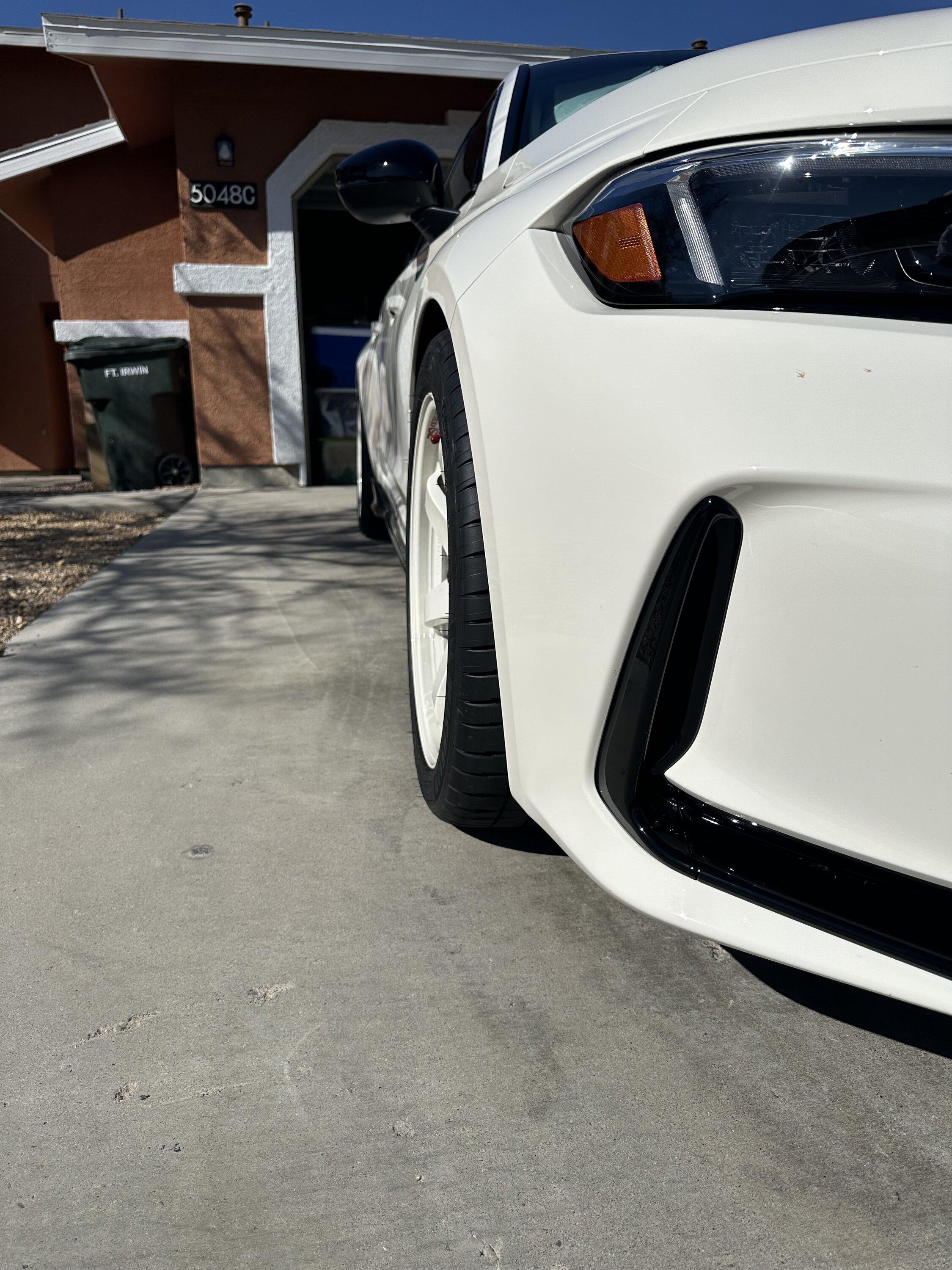

As promised tickle!!
No rub, full lock no issue. Steering is missing that sharpness, but pictures don’t do justice. She looks track ready!!
18x9.5 with 285/35/18 pilot sport 4S
and of course the wheels came from @systemMotorsports
What is the offset?

Looks amazing Richard! Glad to see they worked out perfectly for you :)

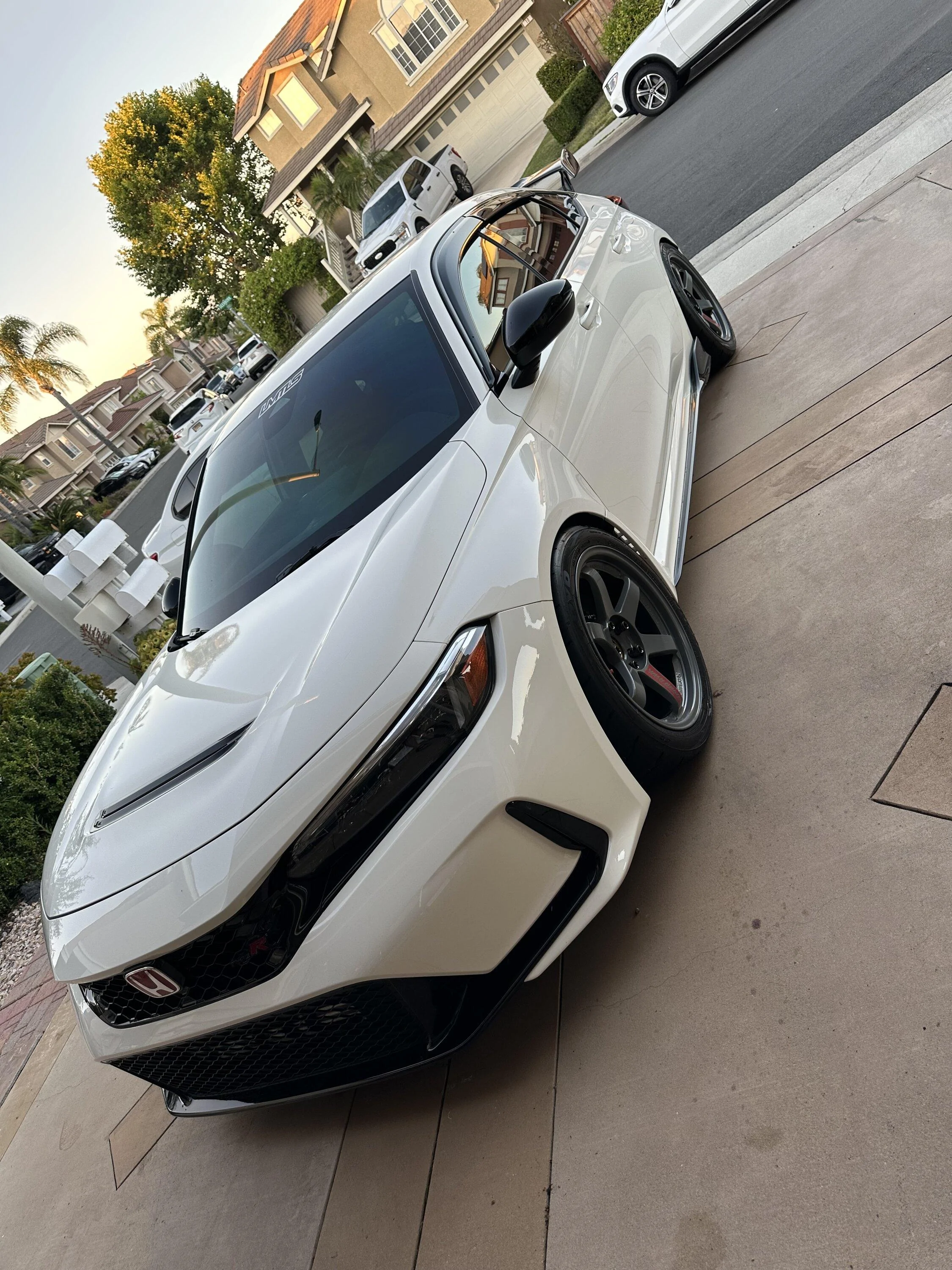

Wanted to post my set-up for reference if anyone feels spicy enough to run 10s as well.
Very similar to the FK8s where I think the sweet spots are 18x9.5 +45-+38 and 18x10 +40. I don't think I would go lower than +40 on an 18x10.
18x10 +40 TE37SL's
Falken RT615k+ 265/35/18
H&R FK8 Lowering Springs
Removed top hat guide pins for little extra camber.
Looks great - any more photos namely on the front end? Any signs of rubbing?
I've got the same size Saga's arriving at the end of the year with the intention of running 275/35R18 RE71R.

does anyone know if 18 x 10 +40 will rub with 275/35/18?
It'll be close, but it'll work as long as you don't hit a crazy huge bump with a full car.

Looking good mate! Is that on stock height or lowered? Any issues with rubbing etc?
