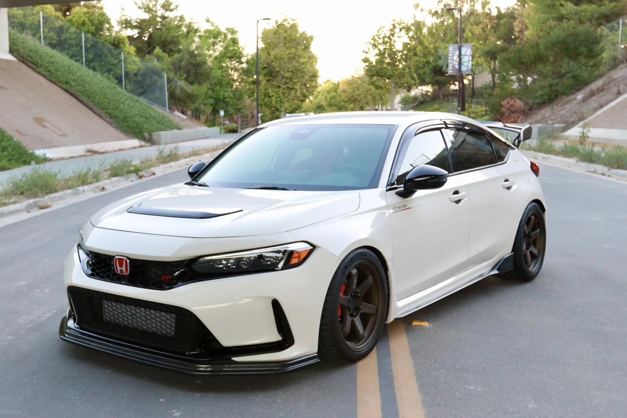

Our customer's FL5 Civic Type R equipped with our Volk TE37SL program in Blast Bronze! 18x9.5 +45, flush!

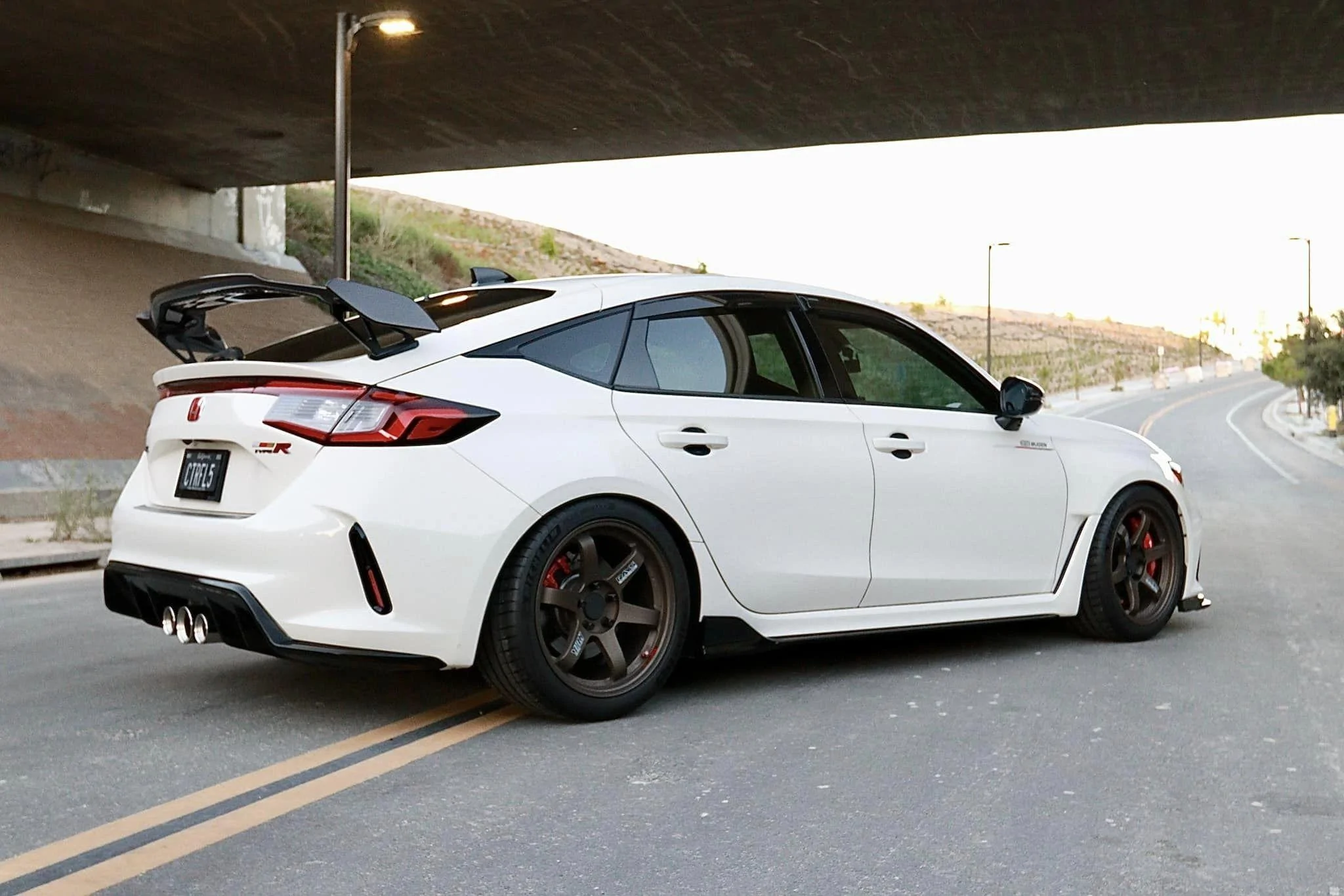

Champ White Volk TE37SL 18x9.5 x Champ White FL5 Civic Type R, Concave Face!

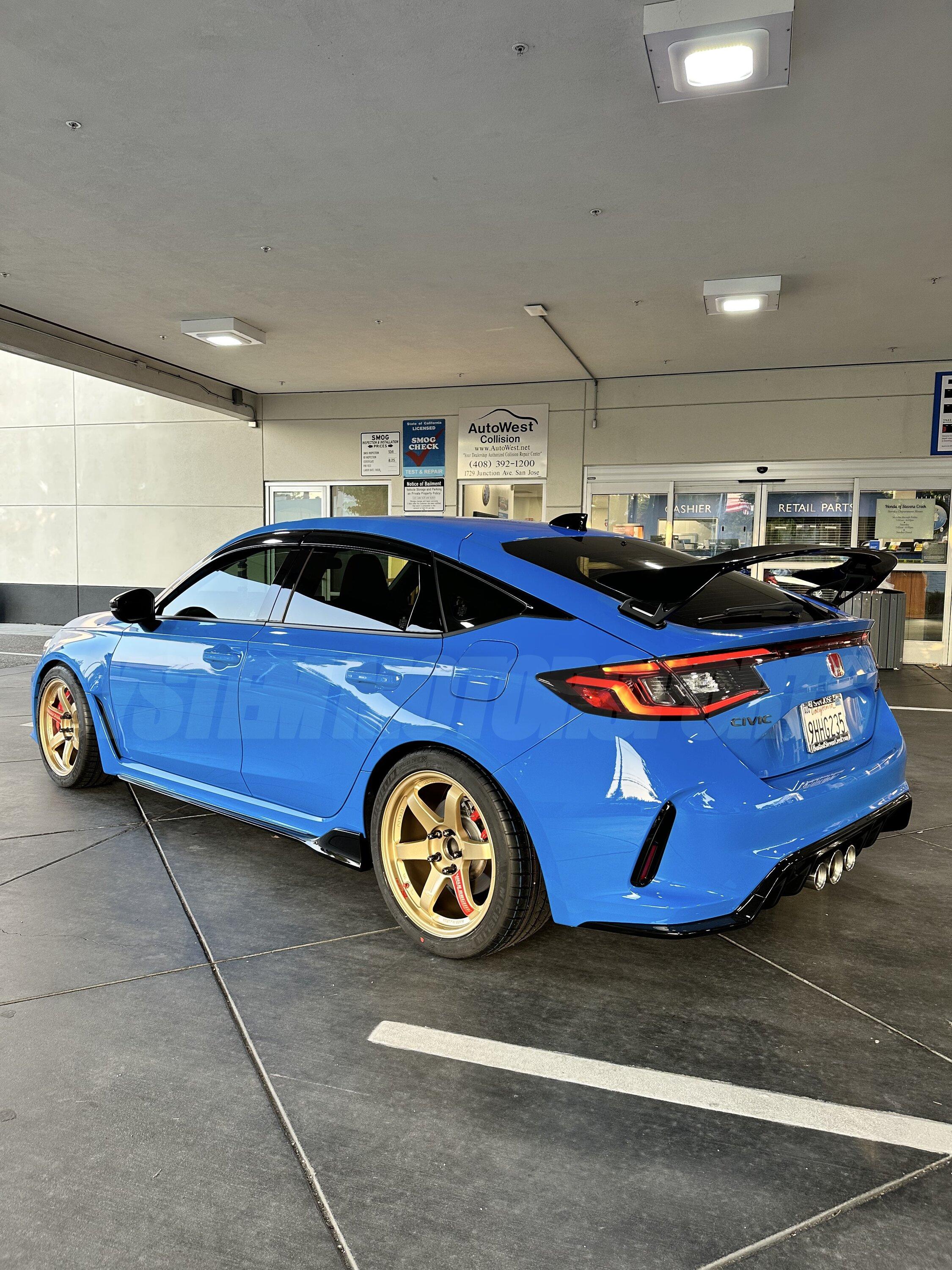

Boost Blue Civic Type R FL5 (11th Gen) on our Rays Volk #systemspec Exclusive TE37SL 18x9.5 +45 5x120, Gold, w/ 275/35/18 Michelin MP4S, stock suspension!
#GSW color themed - Built by Honda of Stevens Creek :)

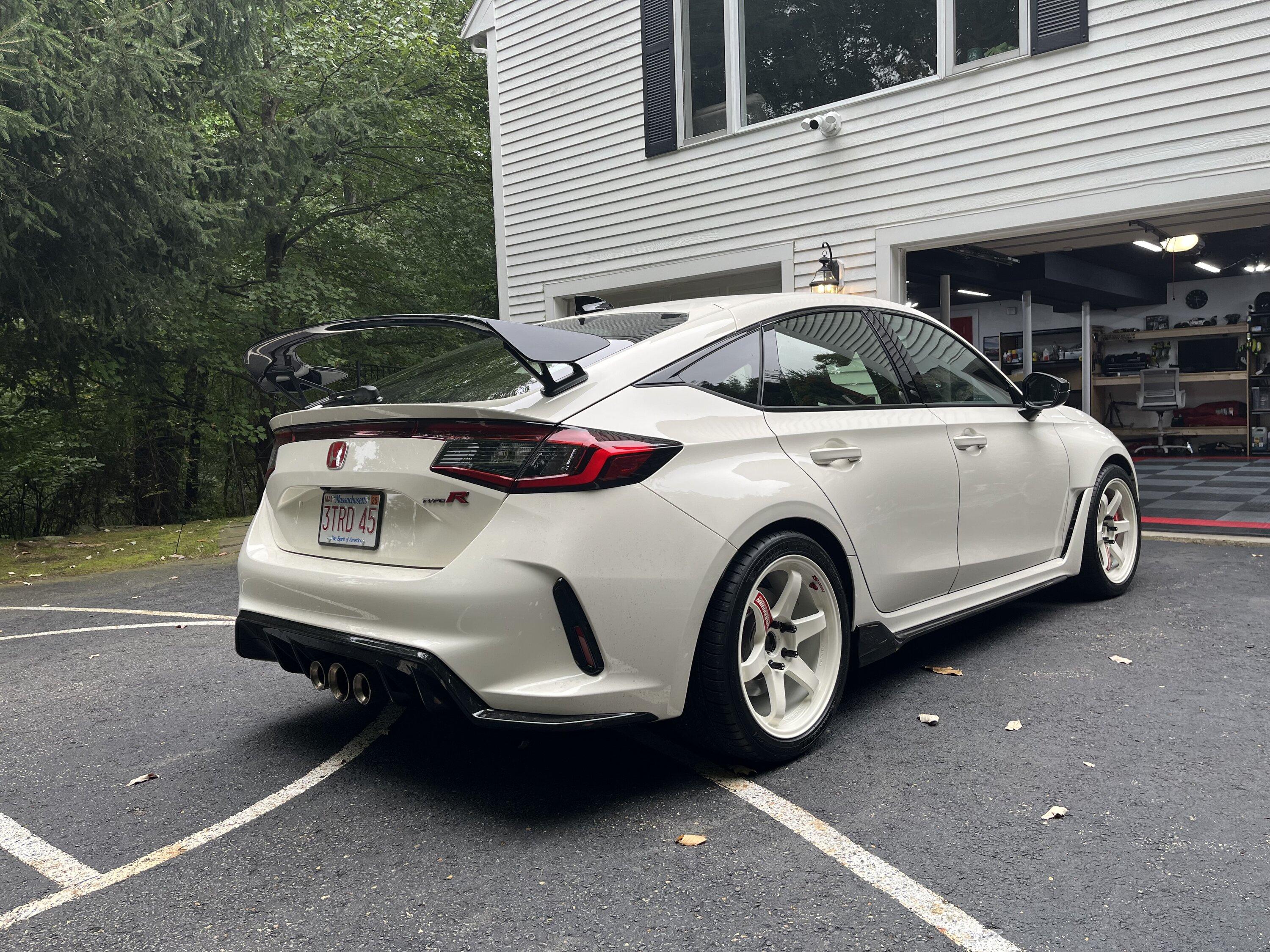

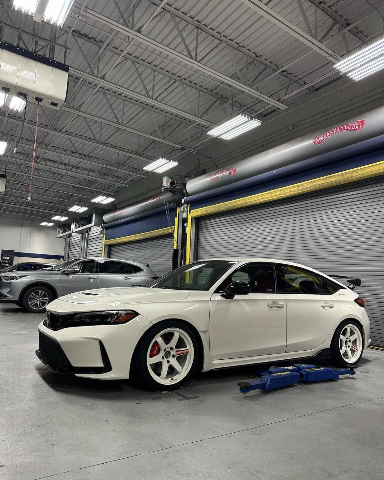

18x9.5 +45 TE37SL's in Championship White purchased from System Motorsports. Tires are 265/35-18 Michelins. Stock ride height. And before anyone says anything... Yes, I did goof on the drivers side rear "Volk Racing" decal. I put it one spoke off from where it's supposed to go. Also, ceramic coated these wheels with Gyeon Q2 Rim coating. Hope that will make them a bit easier to keep clean. Did the red calipers also while I had the wheels off.
Beautiful Ari, and these turned out amazing!
