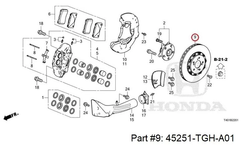

Swapping rings back and forth will get old very, very quickly...
You're better off having a spare set of 2pc rotors (complete with hat) mated to a track capable set of pads for track purposes.

yeh. I was kinda wondering if all the clips of the two piece was more hassle than just have a second set. I don’t see OEM anywhere for sale on Honda parts stores online.
It appears to only be available as a complete unit as others here have mentioned.
Part No: 45251-TGH-A01 (Same part for L&R)
11th Gen Honda Civic OEM Disc rings? FL5 Front Brake Discs
