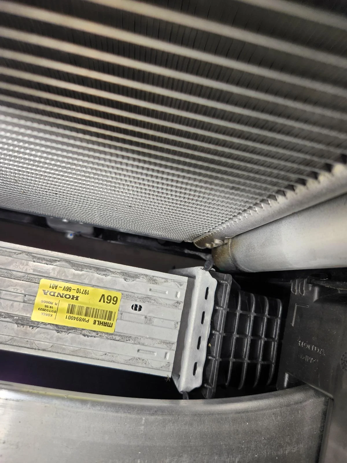

@BuntaTypeR Did they fix your condenser leak? I had the same exact leak on mine and had it replaced under warranty by Lancaster Honda. I only had 300 miles on the car at the time. PM me if you need help getting them to fix it.
Don't go to Palmdale Honda, they're crooks.

the code hasn't come back once the dealer clears the code. Although, they refuse to fix the AC problem since they blame the modified radiator.
i bought an OBD reader just in case I see that engine light again.
I have to make some calls and drive more than an hour for a Honda dealership to agree on fixing the AC leak.
I would show them the photo that @Dollabillplz has kindly shared and claim it as a common fault.
I do have to agree, it's easy to point the finger at aftermarket mods when you're in the dealers position (I have been there) but one must consider that this leak is caused by a manufacturing fault and not user error.

There is literally zero damage to the condenser. They cannot deny warranty in this case. It's clearly leaking from the plastic plug on the bottom of the condenser. There aren't any tool marks or any other disturbances. These cars use POE oil and it's known to be tough on seals.
