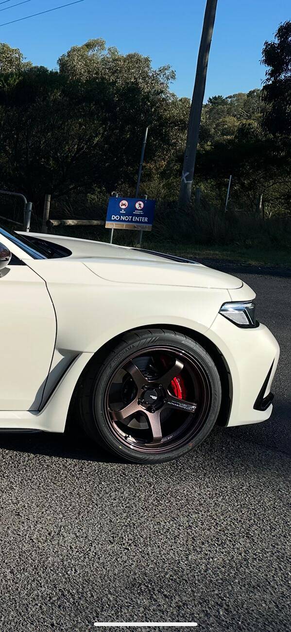

I’m on ADVAN APEX V601 275/35/18 tires on 18x9.5 + 45 offset rims. I’m on stock height and it’s a little taller I think but looks much more aggressive than the PS4 which I like. Way less tire noise, better comfort , more grip.
Looks pretty damn sharp...thank you!

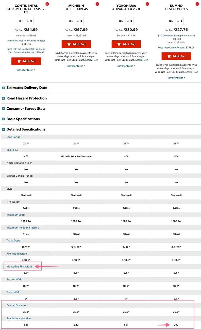

Rim width makes a difference in how the tire is "stretched" over the rim. noticed that tirerack.com lists the "measuring rim width" before listing the measurements.
have you considered 275?
275/35R18 have a taller sidewall, nominal 0.3" taller (I am aware that different brands/models might not be "nominal")
I did a quick comparison for you on tirerack.com
It seems that the Ecsta Sport S is indeed smaller when looking at rev per miles, even though "overall diameter" is the same as the other tires I happened to choose for my comparison...

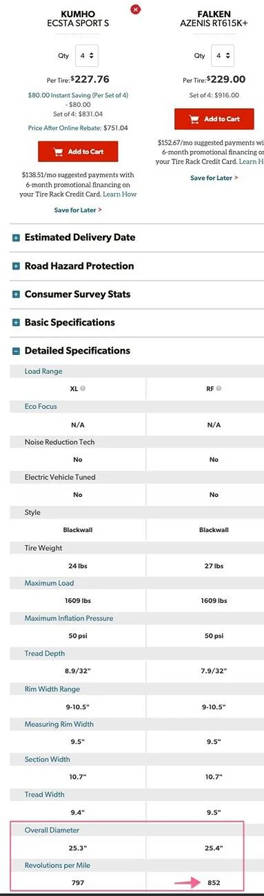

and it seems that the Falken Azenis RT615K+ are the largest I was able to find...
both in overall diameter and most rev per mile (all others I happen to look at were in the low to mid 820 rev per mile)
