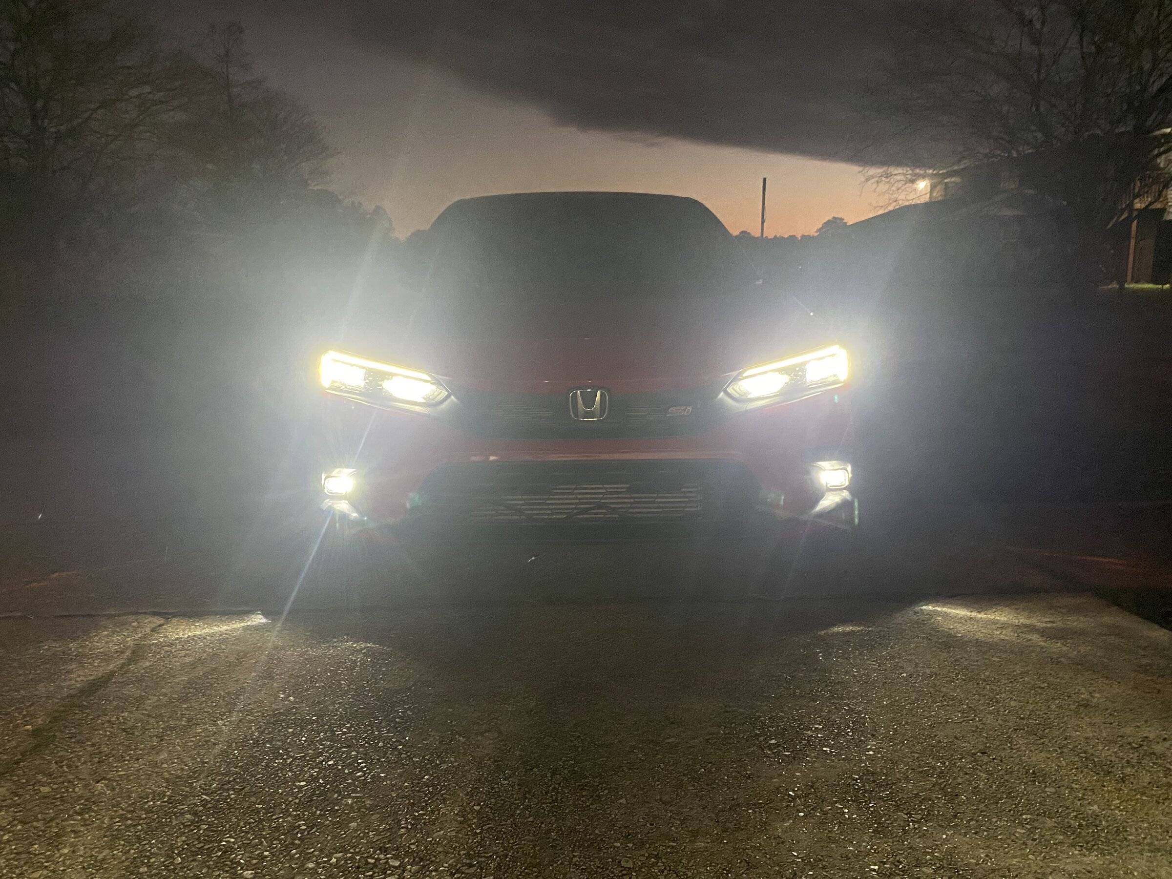

I can also say you’ll notice a huge difference with these fogs on

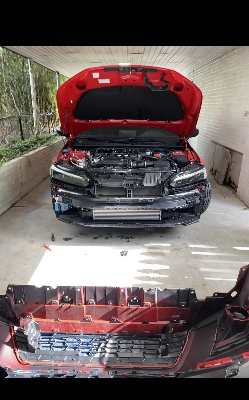

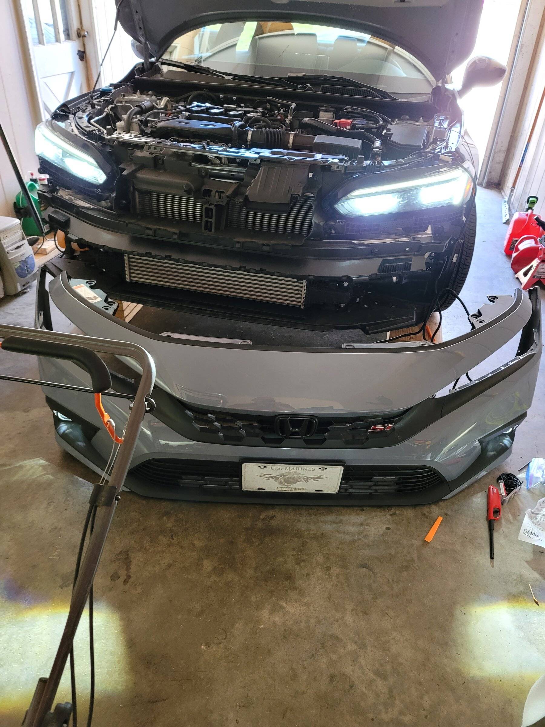

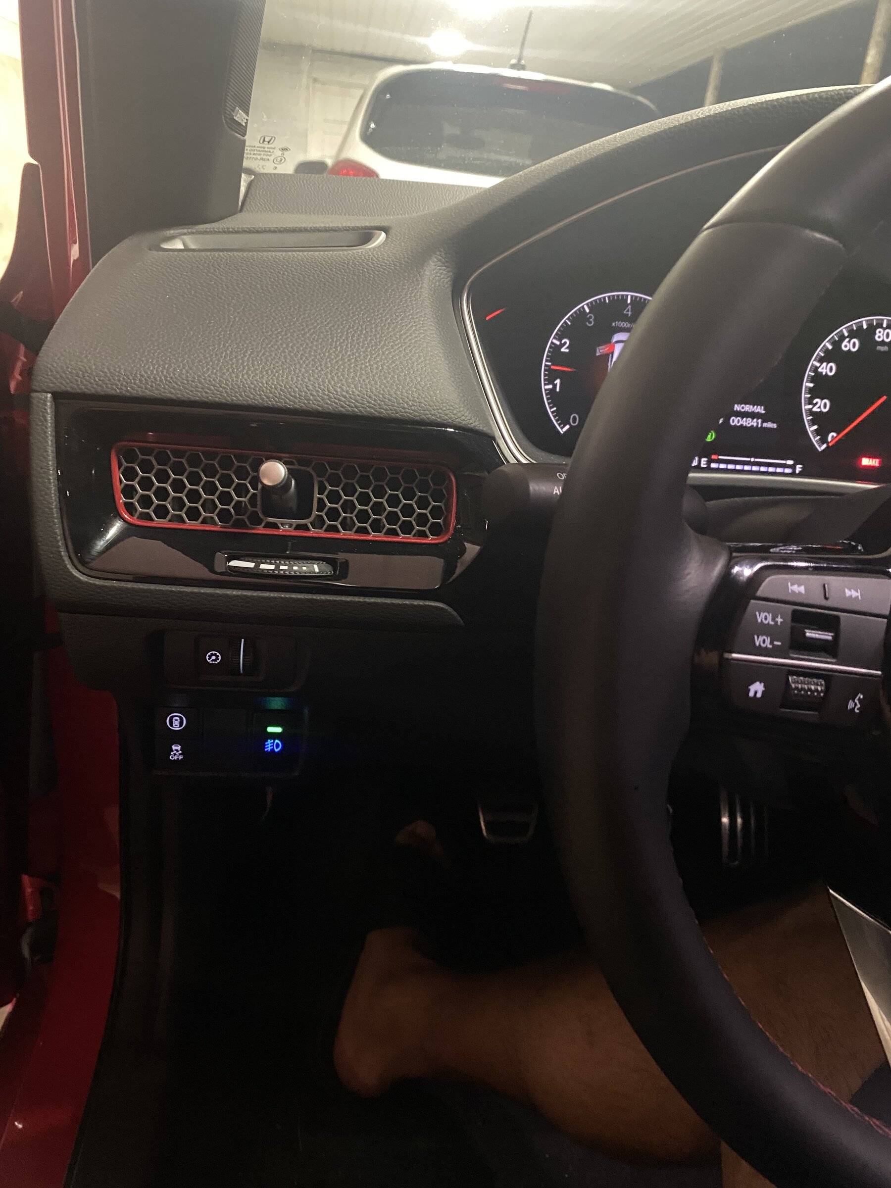

I recently got my fog light kit, and I did install it! Here are the results!
I did purchase the kit that SucubaSteve bought of ebay from ' yzhu0077 ' . It comes with the needed wires, lights and switch needed to install them. However I did need to extend one of the grounding wires so it'd reach the ground that I used. I also opted to purchase the OEM honda fog lights, to replace the lights that came with the kit.
Note: I ran the switch wire though the side driver fender, and through a rubber grommet on the side into the cabin.

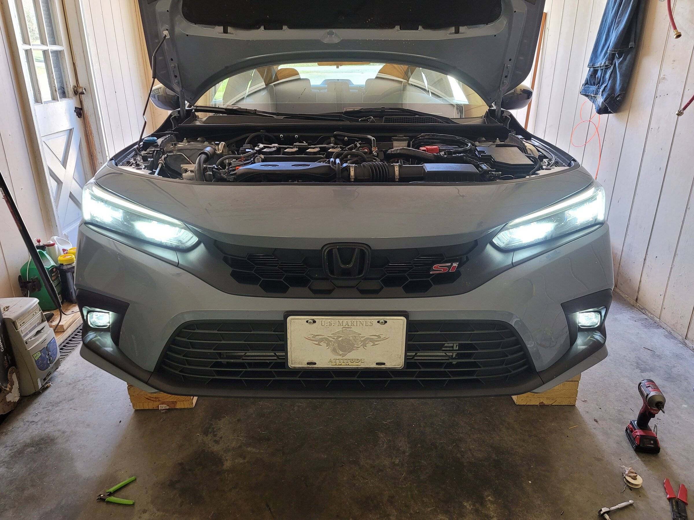

This kit does have a postion light wire, I just finessed the wire under the locking clip and seated it ontop of the oring that helps seal the connection, into the left driver's side headlight; directly to the DARK BLUE wire, however the connection for the headlight doesn't lock but it is snug enough that vibrations won't effect it.
