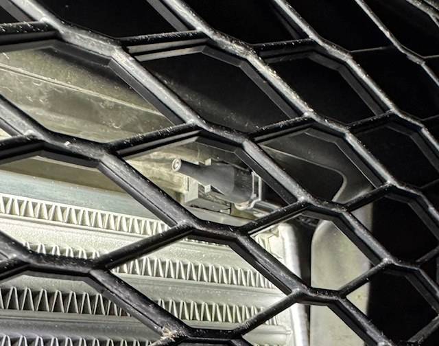

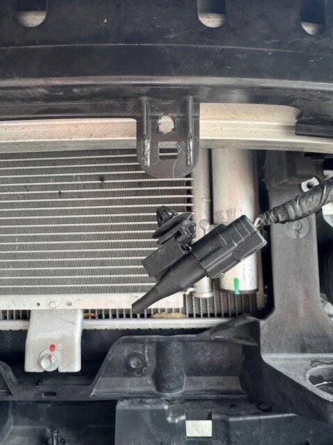

So the stupidly simple one page installation for the J's Racing intercooler was 100% accurate. As described, the only trimming necessary is to modify and move the air temperature sensor higher up on the existing stock tab. Here is a PIC of where ribs were cut off of the stock tab and a hole drilled higher for relocating the connection point itself:
Bottom section removed:

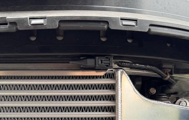

PIC of the sensor after intercooler installation:
PIC with the front bumper on:
what is that stock tab connected to? Is the entire part replaceable or available separately should we choose to go back to stock location? amazing thread, btw.
blueroadster
blueroadster
Apr 19, 2024
25
558
805
MD
Thanks...The tab appears to be on the lower section of Part #7 in the below diagram.
11th Gen Honda Civic J's Racing Hyper Intercooler Front_Bumper
Part #7:
  • Plate Assy., Fr. Bumper Safety
  • Part Number: 71170-T20-A00
  • MSRP : $52.30
