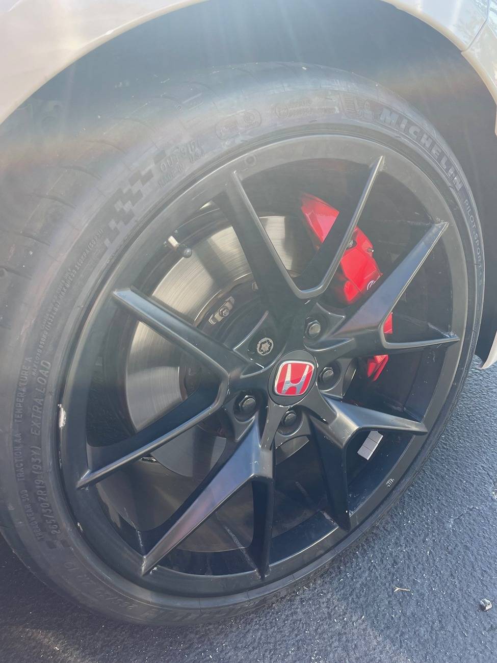

The last time I took my car in for service they scratched the living shit outta my front wheels and had the gall to give me the car back and think i wouldn't notice.
