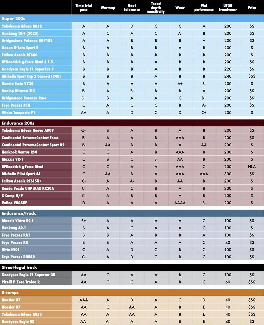

Here's a slightly outdated cheat sheet that could be helpful for many - I don't know where it's from, but the data seems pretty true-to-life based on the collective experience of my local track friends here in SoCal

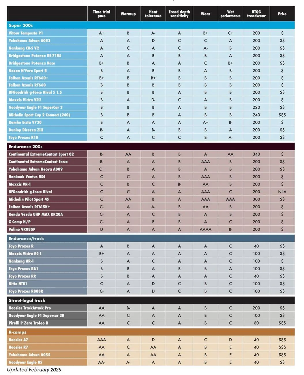

That's from GRM. They do actual instrumented testing, so its objective and subjective feedback making that chart. there is an updated version of it on the guide. Grassroots Motorsports ultimate track tire guide | Articles | Grassroots Motorsports

I had looked at this chart and wondered how well it applies to FWD setups like the FL5.
Example: I found that on my Lotus Evora, PS4S tires lasted much longer than Cup 2. The chart says AAA for the PS4S and A for the Cup 2 so it matches my experience.
On the FL5 the PS4S survived for one track day on the one tire. Negative camber is needed for sure, but is the softer sidewall of the PS4S partly to blame here? Would it receive the same wear rating with the unique demands of FWD?
