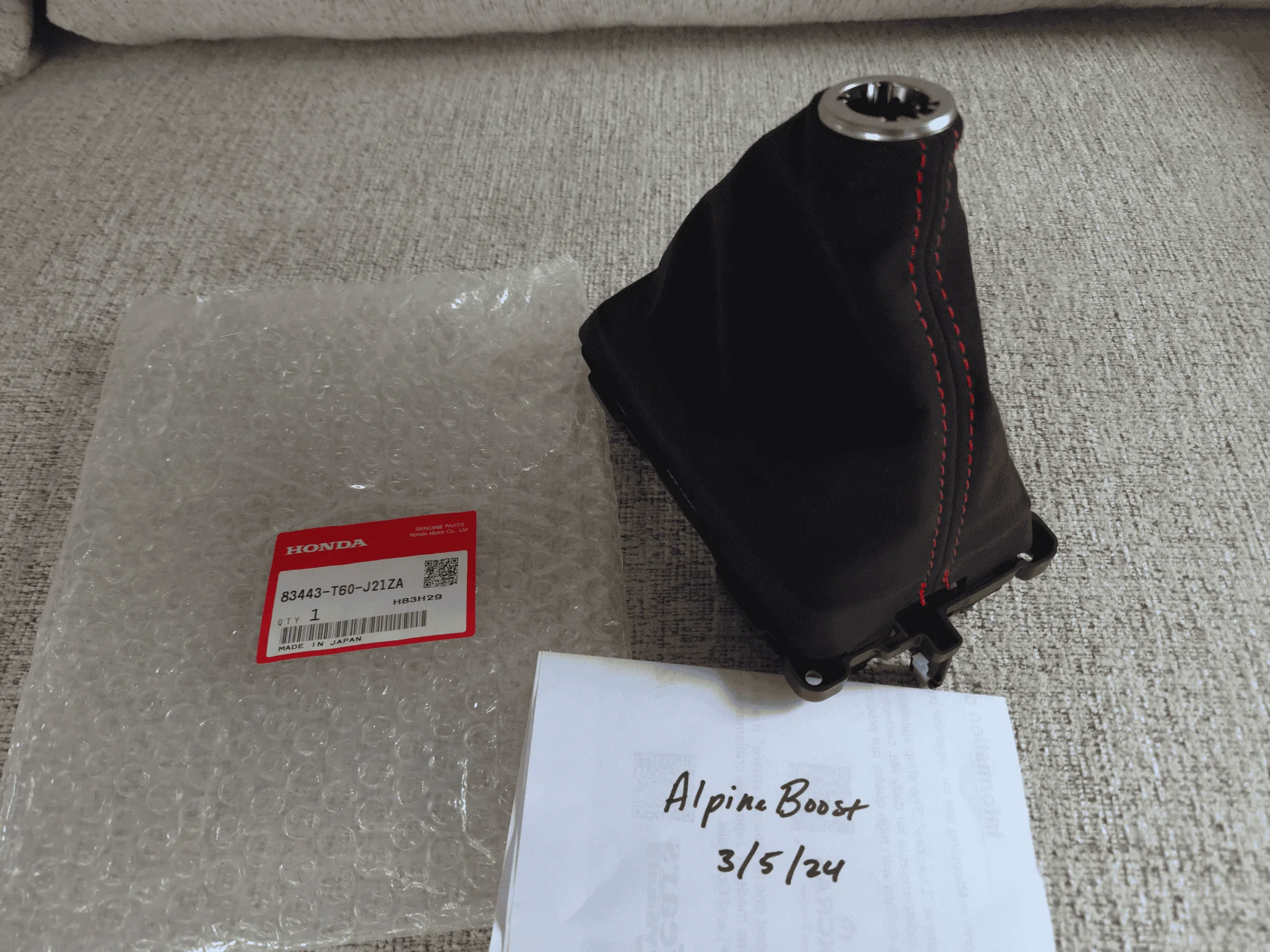

Purchased from JDM Yamato. Boot is new, never installed.
$75 shipped to the US via USPS Ground Advantage

Because it will inevitably get asked--yes, you can swap this in for the pleather shift boot in the USDM FL5.
You'll need to remove both shift boots from their respective assemblies (the plastic rectangular frame at the bottom). Each is held on by 12 staples. You'll remove 24 staples, then attach the alcantara shift boot to the USDM assembly with 12 new staples. No heavy-duty stapler/staples needed. A standard office stapler will do the job.
I paid $78 for this item from Black Hawk including shipping from Japan.
