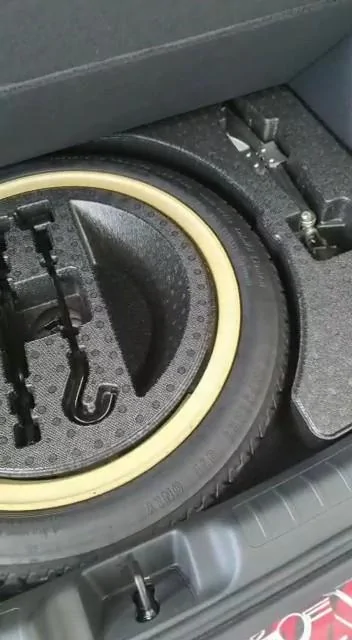

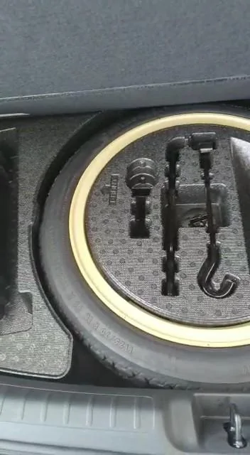

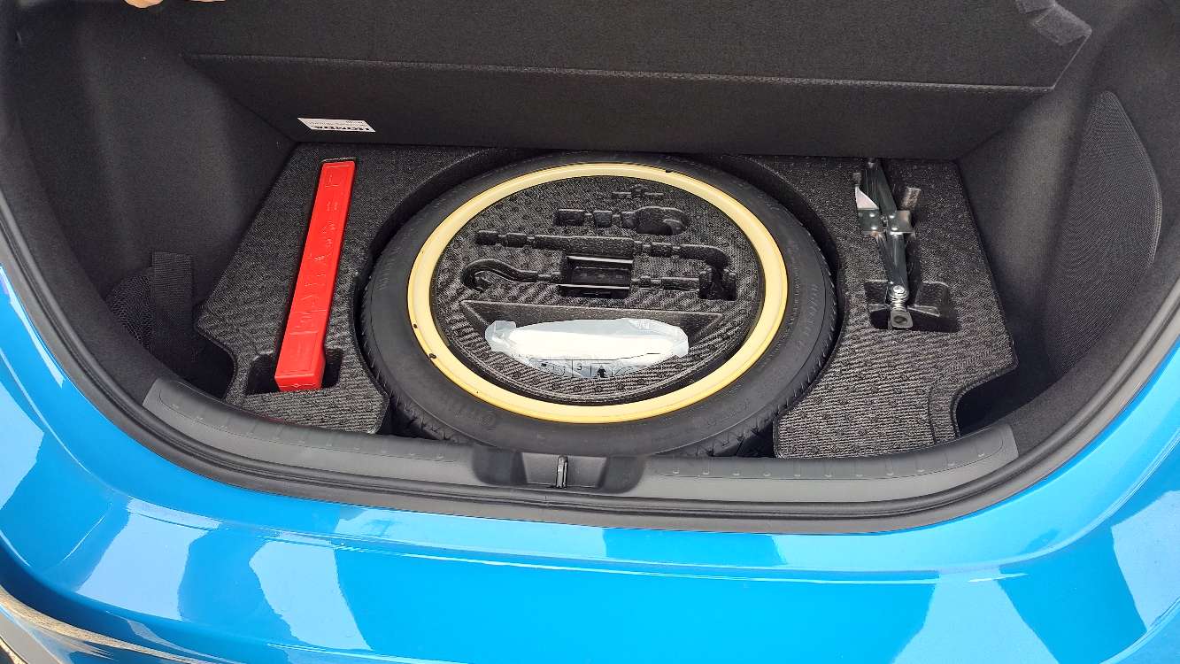

Last week I went to a honda dealer to see a FL5 on display. It hasn't been released in the country yet, so it's still using the red camouflage. These are pictures from the spare tire with a nice foam kit. It's better than the kit I have in my fk8.
So this is the kit that comes with all FL5s sold in Brazil:
11th Gen Honda Civic FL5 Spare Tire ? Compress_20231017_214358_8455

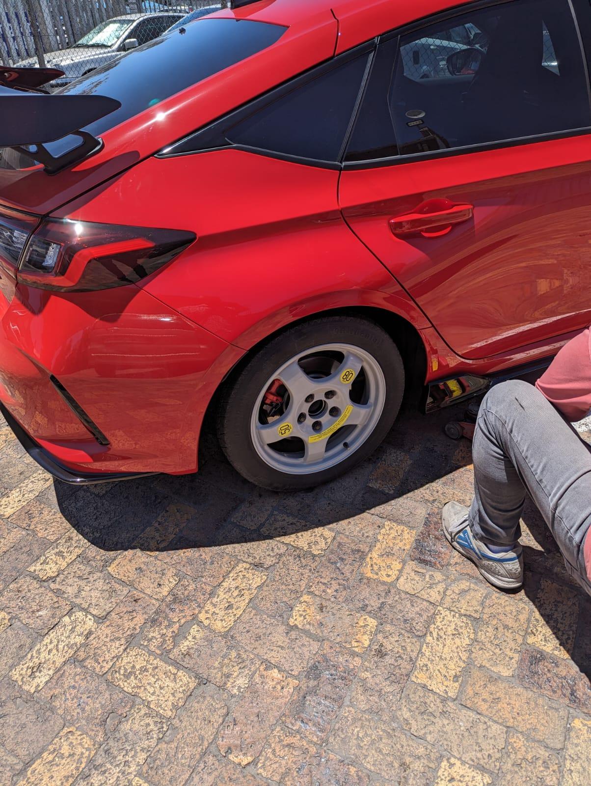

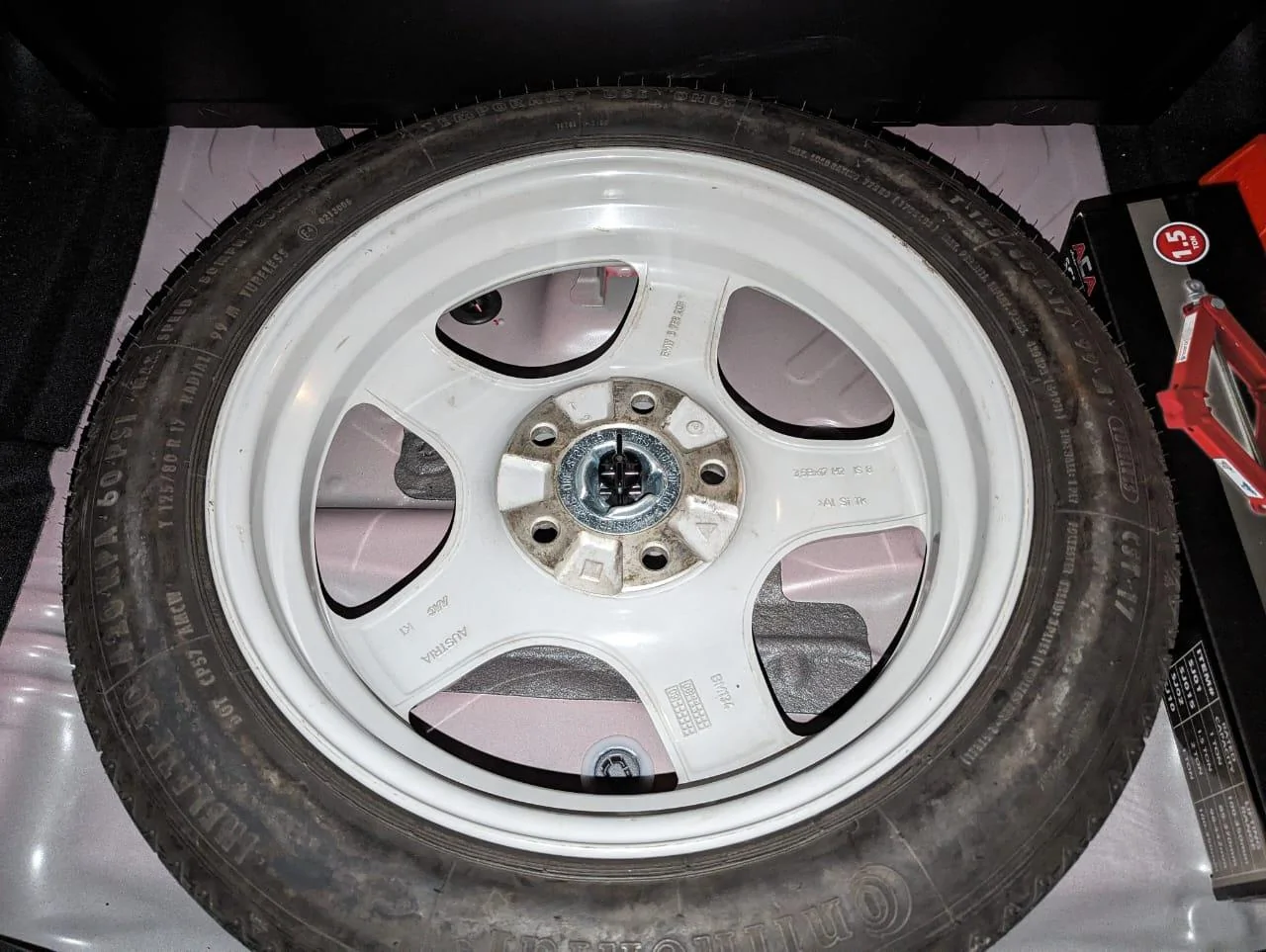

Hi all, I am new to the forum as you can see although I have been reading a number of threads. I've definitely come across a lot of valuable info on here.I recently purchased an FL5 Type R and I am absolutely loving it.
I am having a tough time sourcing a space saver spare wheel. The Honda dealership I purchased the car from refuses to give me the wheel and tyre dimensions unless I purchase the kit from them which will have to be imported from Japan which in South Africa will cost approximately $1400 and will take 8-12 weeks to arrive. I am also unable to easily source an 18/19" space saver wheel outside of the dealership as well.
I managed to find a used 17" BMW space saver wheel with the correct 5x120 pattern. It does not clear the front calipers and can only be fitted on the rear which I believe is the best place to place it given the posts above taking into account the LSD, etc.
The wheel that I'm looking to buy to use as a spare which will be stored in the boot/trunk is using a 125/70 R17 tyre. My question if anyone can assist please, the wheel does clear the rear calipers and seems to roll unobstructed, is this all I should be factoring in? Are there any concerns with using this size as a spare wheel? It will only be used in case of emergencies.
NB: The tyre itself does need to be replaced as it is more than 8 years old.
If the wheel size is good, should I look at a 125/80/17 tyre instead of the 125/70/17 tyre?
Thank you!

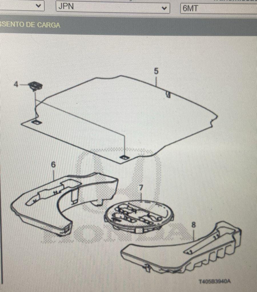

11th Gen Honda Civic FL5 Spare Tire ? IMG-20240105-WA0026~2
5 - 84521T50E01ZA
6 - 84527T60K50
7 - 84545T60K50
8 - 84572T60K50

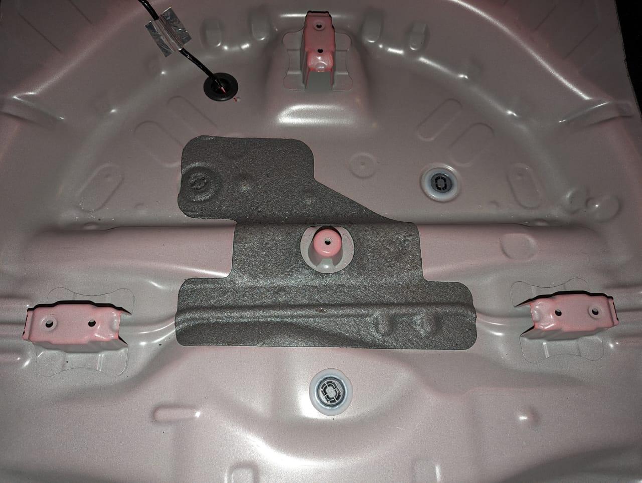

Does the FL5 has something in the bottom of the trunk to secure the spare (even if the car does not come with a spare)?
Shrapnel
Justin
Dec 8, 2023
135
137
Los Angeles
CW 2024 Civic Type R #16838
I believe there is a threaded bracket at the bottom of the spare tire well on all FL5's regardless of delivery region.
frenzal
Dan
Jan 14, 2024
78
57
2024 Integra Type S, 2025 TLX type S, 2004 S2000
Can somebody with a FL5 confirm? Ideally from Canada...
FerrisBueller
Dec 18, 2023
South Africa
Honda Civic Type R (FL5), 2006 Honda Civic 8th EXi
Not from Canada but here is the wheel well that we get in the South African FL5.
I'm using a tyre holder screw from the 8th Gen Civic which works fine.
The wheel well is only roughly 70-80mm deep before the boot/trunk floor.
