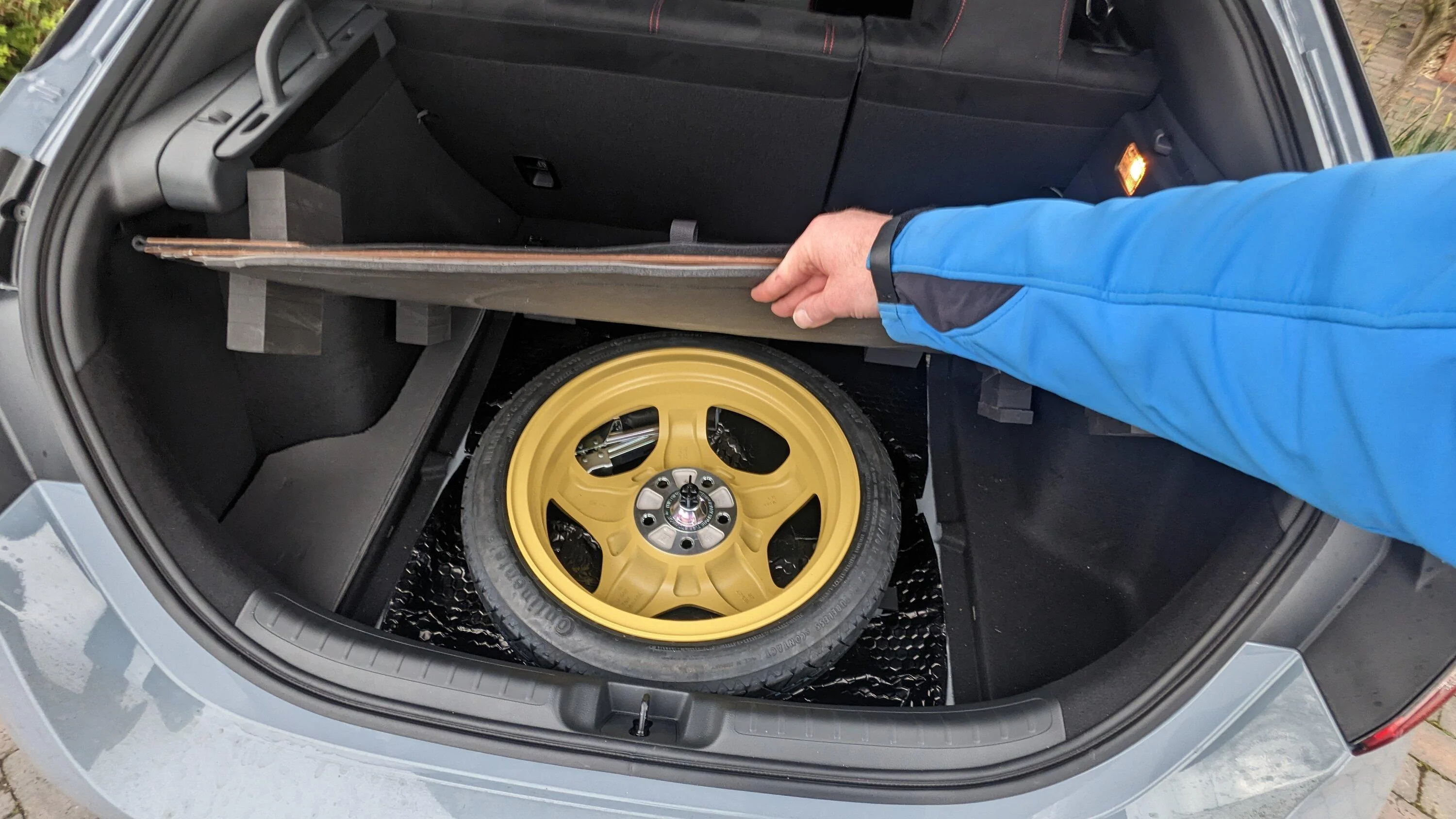

Does the Bose sub sit in the wheel well? My UK car doesn't have the Bose and the FK8 spare wheel kit and boot floor fit fine with some minor adjustment to the boot floor height

Last week I went to a honda dealer to see a FL5 on display. It hasn't been released in the country yet, so it's still using the red camouflage. These are pictures from the spare tire with a nice foam kit. It's better than the kit I have in my fk8.

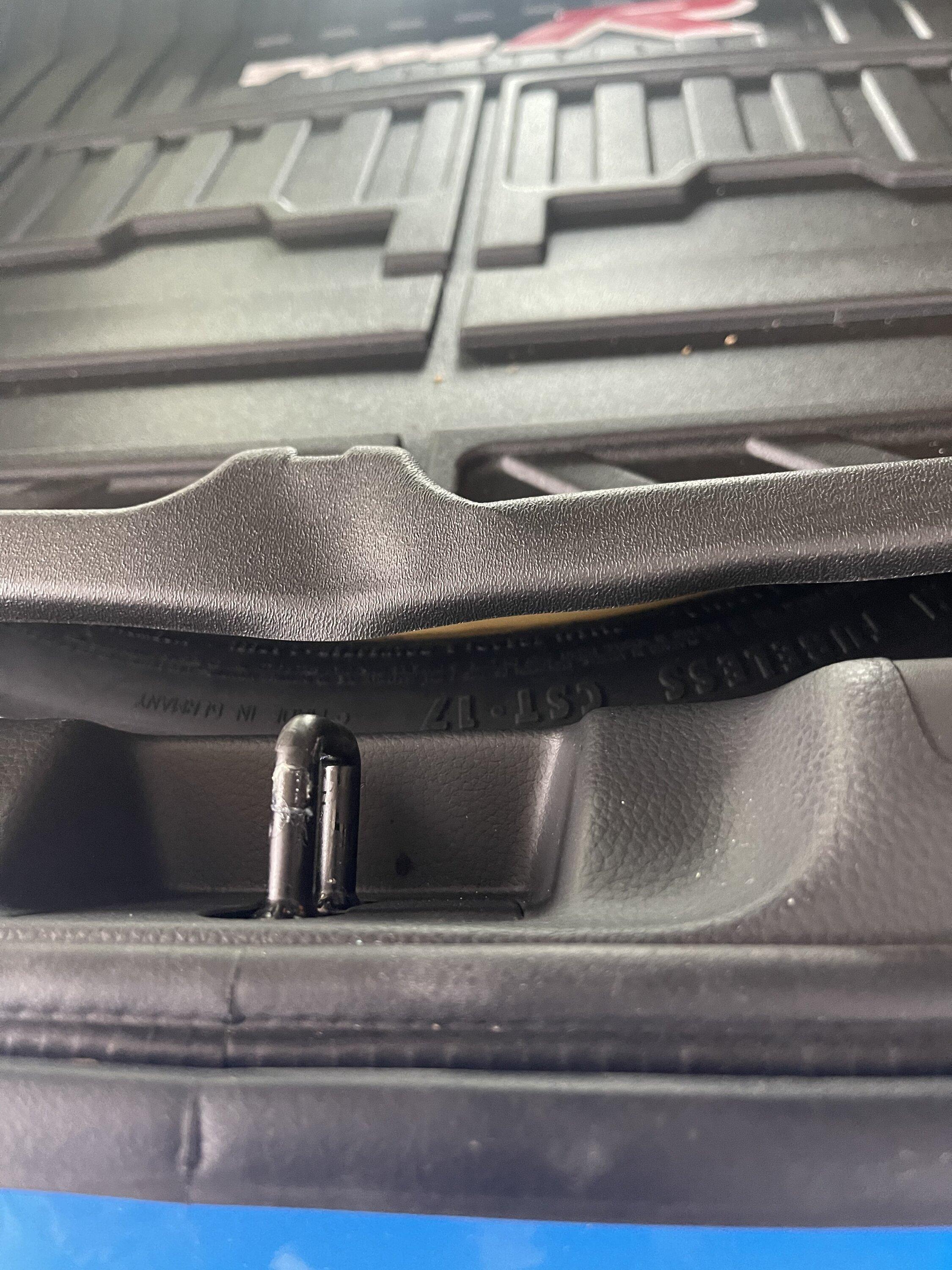

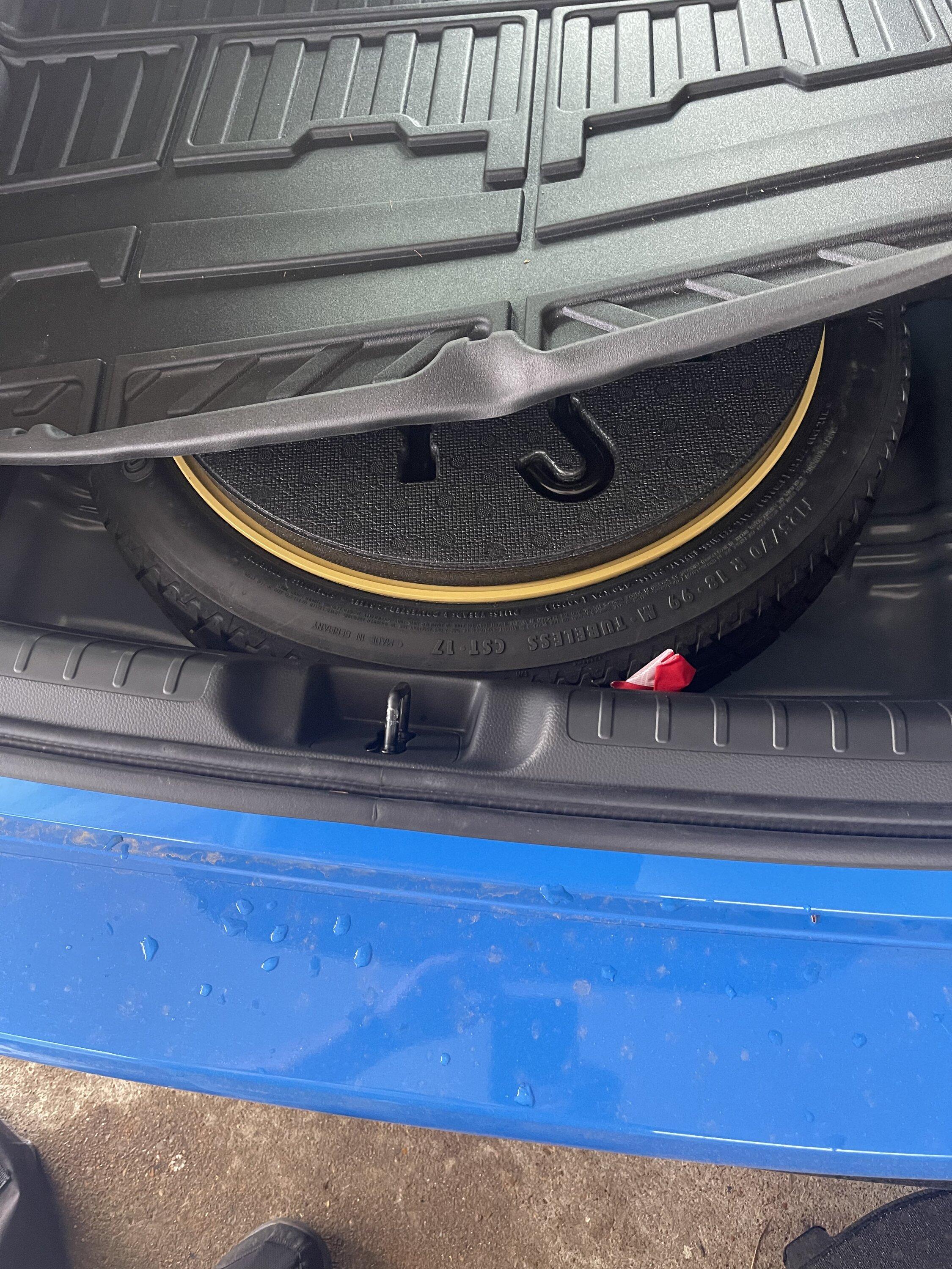

Just got my FL5 last week. These pictures are of my FK8 spare. I can see it fitting, but the tray will be worthless. Maybe they will build the tray as part of the tire cover. Will cover up a lot of the woofer. Also will be loosing alot of space.
