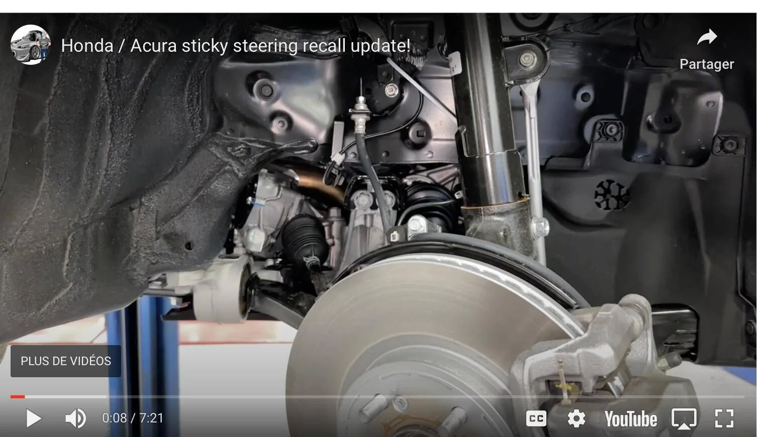

I spoke with the Parts Department at my local dealer. They said they are hearing the recall will be updated so the subframe does not need to be dropped. There will be a part available to allow the recall to be completed without having to do such.
MooMoo
Apr 6, 2024
1,244
1,237
Nice. They will gonna have to remove the fender line and will probably fuck up my carbon screen/mudflaps which was kinda a pain to install. Might have to remove before I go get it done but this is much much better

It is a good news , thank to share
Chance they have do it MooMoo:
11th Gen Honda Civic FL5 recall (2022-2025 Civic Steering Gearbox Assembly) Capture d’écran, le 2024-10-19 à 06.54.38
