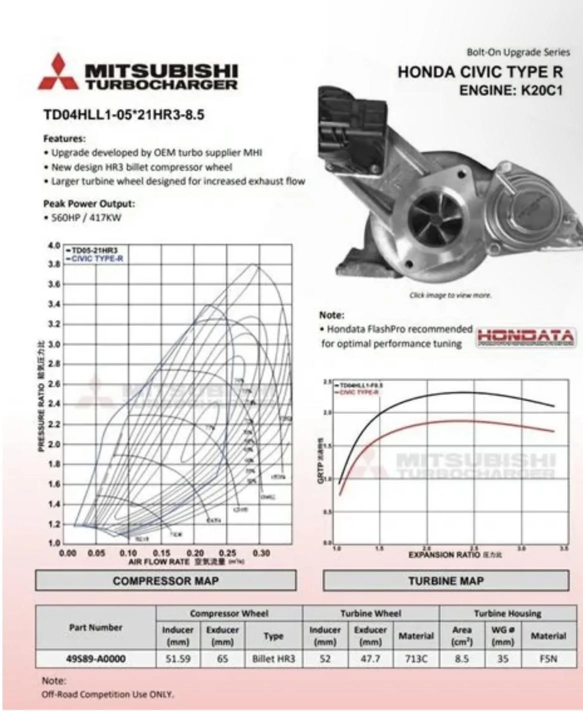

That makes sense now that I think about it.
I do still think its a big question mark on the root cause of the failure though, bit of a chicken or the egg type situation.
Yeah its hard to pin point for sure even more so without actually breaking down the turbo and seeing what wore out. But over spinning a turbo is a silent killer that most people don’t take into consideration. That is why turbo pressure maps are so important.
on this turbo compressor map you can see how much more broad the MHI stage 2 turbo is regarding working pressures.
11th Gen Honda Civic FL5 Overheated on Track IMG_2328
Yup. I just don't believe an overspinning turbo would cause the AN lines to let go. Rather the AN lines loosened off and let go, followed by overheating turbo which went into meltdown, rubber seal on BPV melted, overspin and overheated turbo destroys bearings and kaboom.
