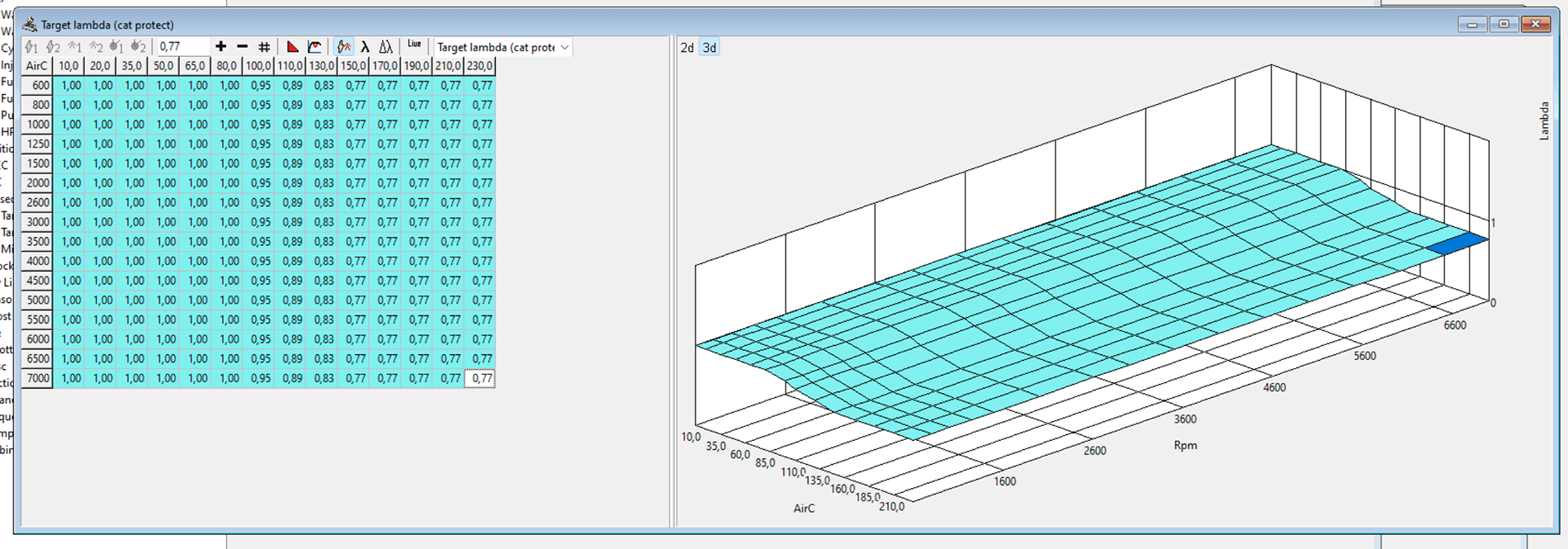

an example of how rich I run on the track tune:

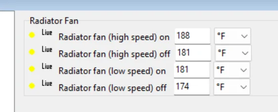

don´t forget to adjust the fans to your taste

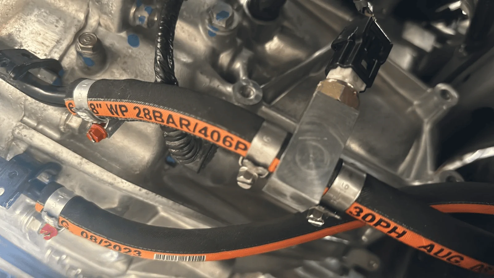

11th Gen Honda Civic FL5 Overheated on Track 1725734004815-bt
A bit off topic but still relevant:
I added an ECT2 sensor to the transmission cooler line. Let´s see how hot it gets

This is the main reason on my track tunes I run a richer AFR especially up top to help keep everything cool. The EGT’s in these cars sky rocket due to the head design. And like @Vito.FL5 said adding ethanol really helps in that department.
Also adding timing up top as the boost falls helps keep power but at the same time reducing EGT’s.
What afr do you target in the higher rpm's?
