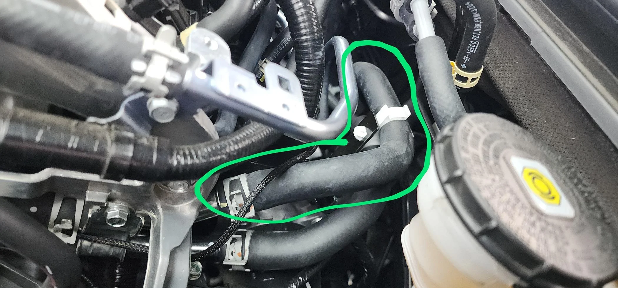

Anyone have any close up pics of where you have cut into which coolant line to the heater matrix to plumb in the secondary radiator. I'm making up a DIY solution for myself. Will report back on how i go eventually, but its early days. Also any idea on the internal diameter of the coolant hose pipes that need to be plumbed into. Want to get some adaptors that are the correct size.
On the fk8 it was this hose, so it should be the same on the fl5. It's a 5/8 hose

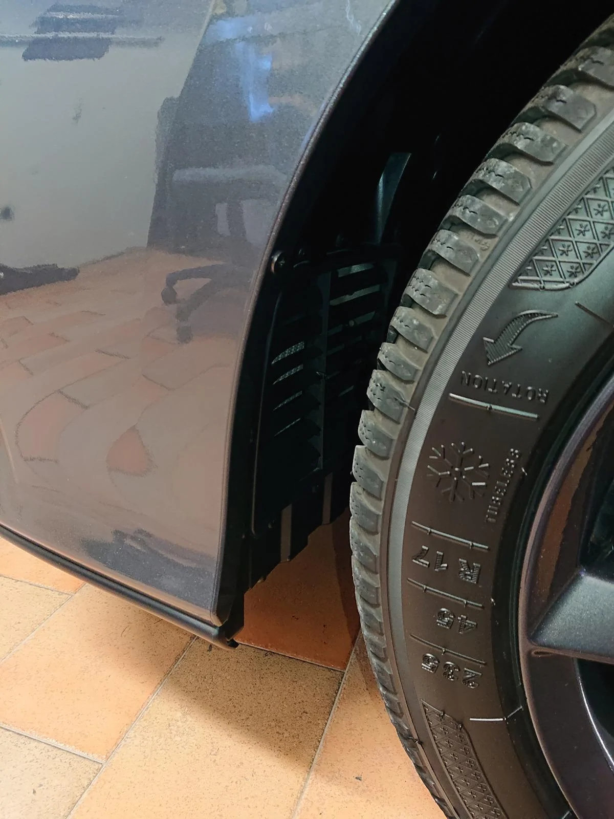

Nice job mate.
As a suggestion for fender liner openings, on my previous FK9 (EUDM 10th gen turbodiesel) the intercooler was side mounted below the left headlight and there was a nice and effective vent.
It should be easily adaptable to any liner, I guess.

Nice job mate.
Do you have a part number for this vent by chance?
