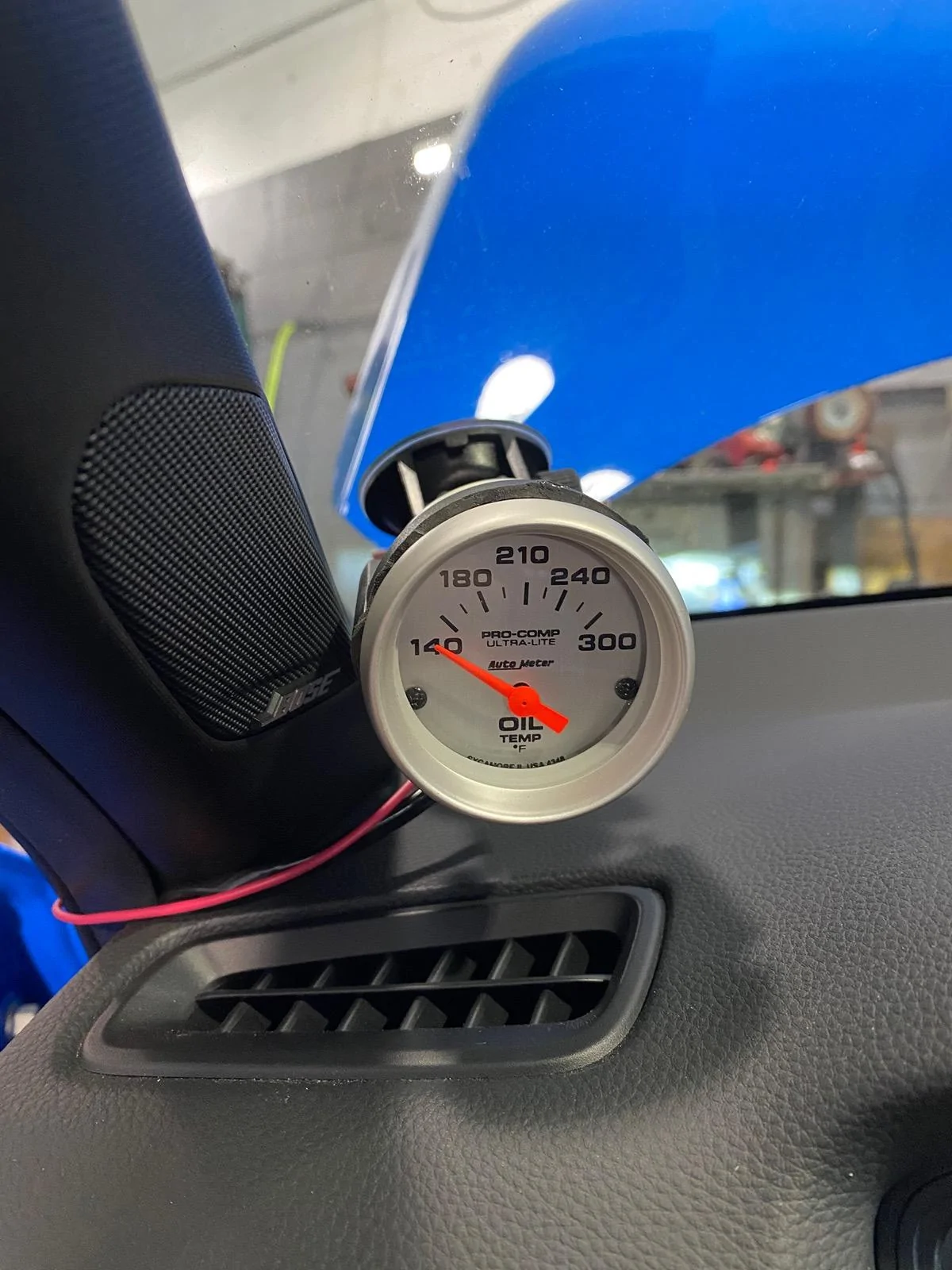

I installed an Oil Temp Gauge in my car temporarily for a track event this weekend. Will update with how close the factory readout is compared to the gauge. My car is stock with the only variable being that I have 5-30 oil in it instead of 0-20.
Awesome! But if there's a significant difference then we should consider that could be the different viscosity at play until you test it again with other weights to see how the difference varies.

Unfortunately I don't plan on getting that deep into it. I just want to know how accurate the OEM read out is so I can make a decision on an oil cooler. After the track weekend I'll be removing the gauge.
Where did you install the sender? Honda's model estimates oil temp at the sump.
A few people did this comparison for the fk8, me included. I have a p3 gauge and an aem sender at the drain bolt. I had to linearize the calibration curve, but it's supposed to be pretty accurate for the range 80-130 C - less than 0.2% deviation. Well, logr is surprisingly accurate enough. I even considered removing the sender and gauge after 2 trackdays, but will keep them because I'm installing oil coolers. During road driving, it deviates less than 3 C. On track, I noticed Honda's model has a too short time constant. Oil takes a lot longer to get hot and then cool down. After this transient deviation right after starting a hot lap, it's at most 6 C wrong. The FL5 model could be even better.
Btw, at least in the fk8 the calculation doesn't use oil pressure. I suppose it's the same with the fl5, Vito could confirm it.
