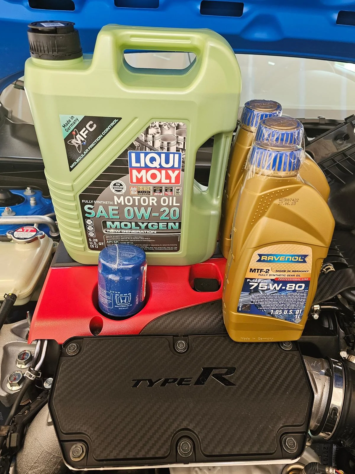

I'm a fan of amsoil and the SS definitely exceeds the specs required. I'm also a liqui moly fan and run that between routine service visits. Keep up your service visits and run what you want in the mean time.
11th Gen Honda Civic FL5 Motor oil  Brand and Grade 1000001287
B34R
Nov 7, 2022
25
US
2023 CW FL5
I like Motul so I used Motul 8100 Power 0w-20. Seems good so far
