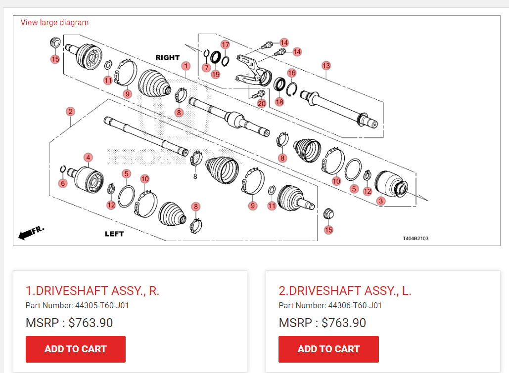

I was an idiot and over-did my driver's side axle when installing some spring and tore the inner CV boot. I think the best option is just to replace the entire axle assembly. Does anyone know if the FK8 Type R axles will work on the FL5 or if there is a FL5 part number? Thanks!

I have no idea but I believe the front track is 25mm (1") wider in the FL5 vs the FK8 so there is a pretty good chance they are different.

The part number for the FK8 CTR is 44306-TGH-A01 . I'll pull the front wheel off the '23 and see if there is a part number on the shaft.

I ended up finding an OEM axle housing from a totaled (sad) FL5 CTR. I wasn't 100% sure I could find a boot kit yet that was specific and didn't want to go through the revolving door of guessing on boot kits. It only cost me $200 for the whole housing. Once I can be 100% on a boot kit, I'll but one, re-do my original axle housing and sell it.
BTW-the FL5 Type R axle IS in fact longer and different from the FK8.
