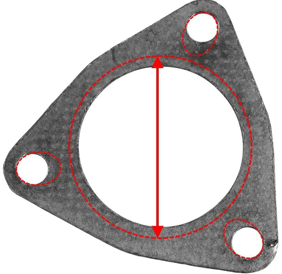

Thanks for this! I took your advice. I found a gasket with a similar dimension.
https://www.napaonline.com/en/p/EXH31737

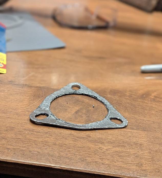

I extended the bolt holes and increased the ID to 3"
11th Gen Honda Civic PRL Front Pipe to Exhaust Gasket - *Looking for Alternative Options* Screenshot 2024-11-04 091547
Final product was not too shabby

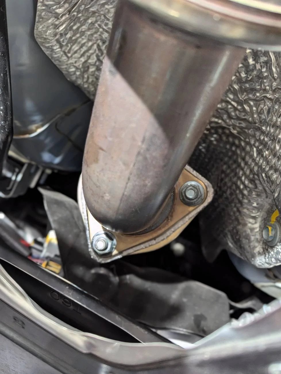

11th Gen Honda Civic PRL Front Pipe to Exhaust Gasket - *Looking for Alternative Options* PXL_202411
It fit like a glove. The material is similar to the PRL original.
