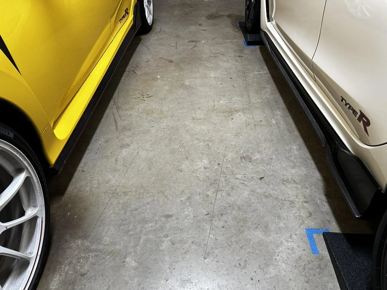

I test drove Integra Type S and I prefer FK8/FL5 hands down.
I prefer to have these two :
11th Gen Honda Civic FK8 Struts/Shocks on FL5 Image (3)
Excuse my garage floor, it will be upgraded soon. I hope this will proof that I am not an AI ;)

Two cool cars to own at the same time. Enjoy them.
