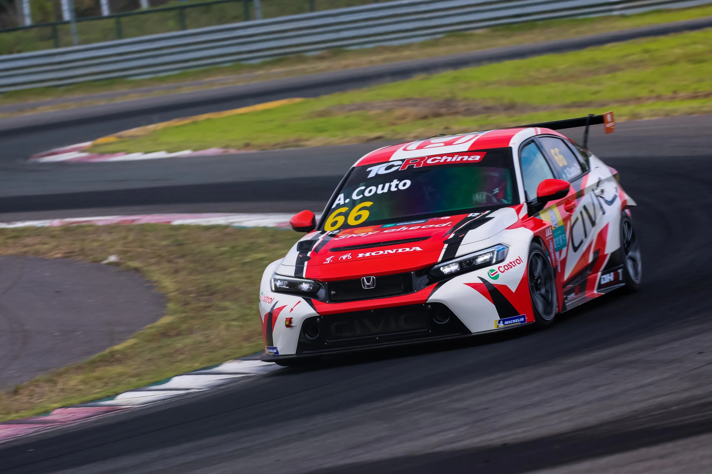

Coming from someone who did suspension design and vehicle dynamics in school for a formula team, I can say that you are seriously exaggerating the effect scrub radius has on performance, especially within a track width change of ~30mm. Its almost hilarious to declare "Low offset wheels being performance reducing modifications" In the realm of going from +60 to +38, when we have all the data from FK8 racecars proving otherwise.
The third link from piston heads does have a very well thought out response and Sam-68 essentially nails it.
A couple points that need to be considered.
  • What is the factory scrub radius? Is it negative, zero, or positive? And if so, how much?
  • The design on the factory suspension is to reduce negative scrub and push it to zero/positive. This has beneficial track performance with the inducing of negative toe under lift off or braking to sharpen turn in. Reducing offset can increase this behavior further.
  • Scrub radius (within the differences we are speaking to on a wheel change) will only result in steering FEEL changes. Increasing the moment adds some weight to the steering. (Adjust the steering to comfort instead of +R if needed to offset this weight).
  • Torque steer is mitigated by many other properties of the dual axis design (Kingpin angle, caster, Tie Rod Lengths, etc) that although you may suddenly FEEL the torque loading up the tires differently, the overall design is not sensitive enough to suddenly pull you all over the road by 15mm change in offest.
  • If this was such a drastic issue, why are all the FWD TCR cars even wider with extreme lower offset 18x10 or 18x11 wheels? The mechanical advantages gained by running a lighter 18" wheel and tire setup with available popular offsets is greater than utilizing the factory sizing. Please reach out to these guys that they messed up their car by modifying the scrub radius.
    • 11th Gen Honda Civic Enlightening read on wheel offset and effects on suspension and steering honda-civic-tcr-fl5-2023-slide05
  • Tramlining is also mostly induced by added camber. Many times people running these setups will do multiple things at once. I drove my car on stock setup for 1000 miles and swapped to a +38 setup and tramlining had no change. What was better was the softer ride from a larger sidewall when using even more aggressive 200tw tires than factory. Without knowing what the values are its hard to say how much positive scrub radius is even added and at what limit you do see negative effects.
  • If performance was actually reduced these setups would not be as popular as they are. This is a car where people are expecting a level of improved performance with mods. If people noticed significant issues, there would be demand for those better performing parts.
There is no issue in liking and preferring the feel of the stock setup. However there is a lot more that goes into it than just scrub radius. Its one of many factors that add up to the exceptional factory handling and dynamics. What is funny is that if the car came with +50 or +45 from the factory people would still think it has some of the best steering ever and they wouldn't know or care what they are missing.

I don't think the whole "but racecars do it" angle is helping anyone. Is the race car otherwise stock? No?
Irrelevant.

In most of those series the factory suspension mounting points are retained and they use helm joints or hard rubber/solid bushings replacing a lot of the OEM ones. Ofcourse aftermarket dampers/springs and other parts are added... They still start with a factory civic body in white and use the dual axis strut setup and all factory mounting points. That also doesn't take away from the fact that people striving to do everything possible to eek the most performance out of the car are doing exactly what laymen are saying is "bad". It's not irrelevant, you can look at stock class Time attack cars as well if you want something to reference thats less modified. People with nearly unlimited budgets running complete custom wheels are choosing to run 18's over any other size should point to something.
Wheels developed for the FK8/FL5 chassis follow the same process all chassis specific wheel fitment applications take. Spoon and Mugen are not going to release wheels that will damage their reputations and offer negative performance over factory. Spoon and Mugen work directly with Honda in getting chassis/suspenion information and they both concluded 18x9.5 +40 or +45 is best. The 19" Spoons coming out will most likely be +45 as well since they use the same factory as the Regas coming out in that same size. All these independent companies making chassis specific wheels all ended up around the same spot?
Why people buy wheels is somewhat irrelevant to the reason why the products are developed in those particular sizes. It wasn't for hard parking instagram flexers when you are talking about Titan 7, Rays, Volks, Mugen, Spoon etc. They aren't going to invest millions of dollars in forging molds to produce wheels in a size that everyone hates and feels makes the car worse. These companies also do a considerable amount of R&D when coming to the sizes they offer.
