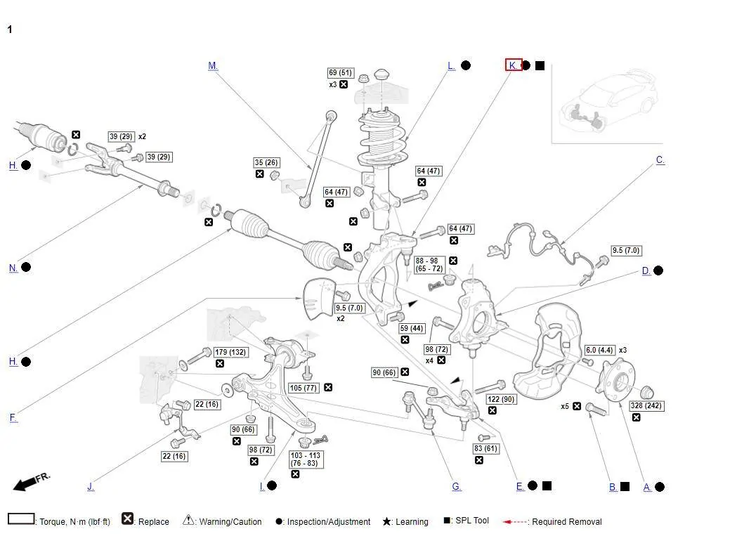

Damper fork ("upper control arm") ball joint removal for axle access.

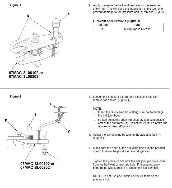

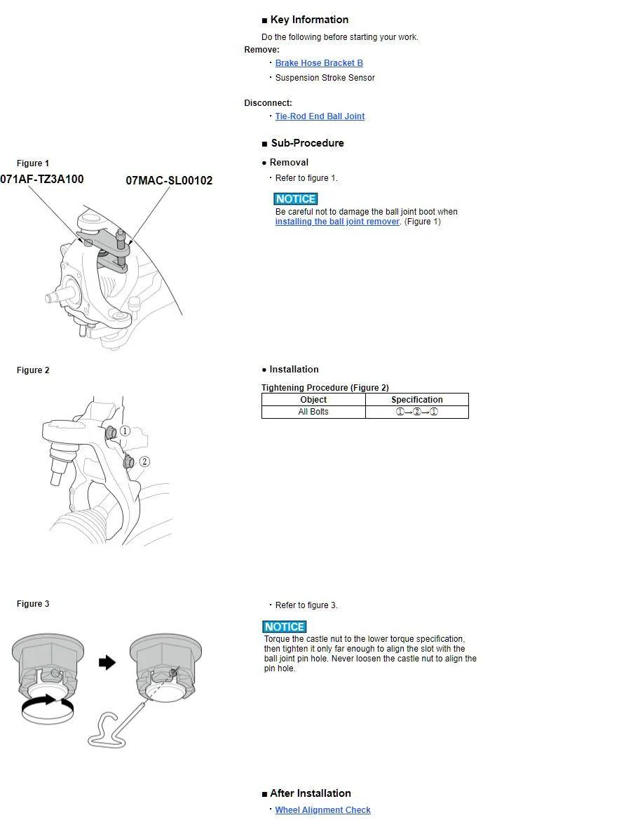

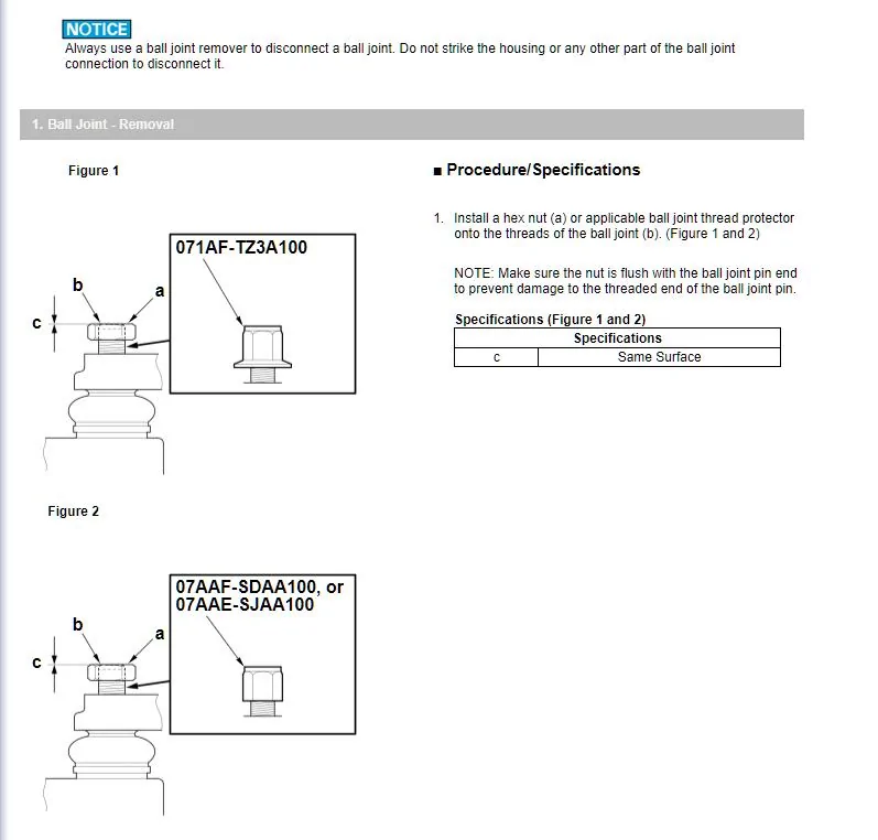

I recently had to do this in order to pull out my axle enough to replace the seal I damaged while changing my springs. I tried to use a ball joint removal tool that I had in my kit but it was too small and the jaws were not setup correctly.
I ended up buying the Honda specific 07MAC-SL00102 Ball Joint Removal Tool 32mm, and would be willing to send it out to anyone else needing to do this (you cover shipping and a refunded $200 payment. Tool was $300 online, and $350 local).
I would suggest removing the LCA ball joint, and outer tie rod end with the same tool.
I would not suggest removing the strut bolts as if the strut is a PITA to get back in.
