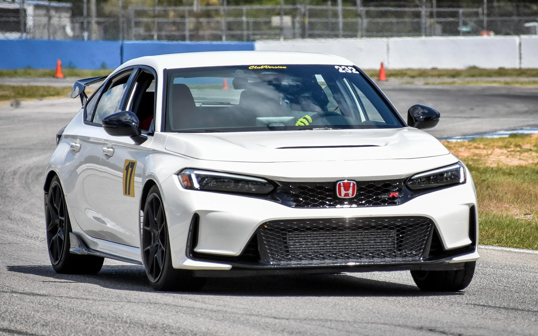

I'm pleased to say Sebring never disappoints!!
Extremely happy with how the car performed as well, no overheating issues even with the 90+ degree weather. In addition, for those of you who were asking, the Type S ADS module worked to perfection to absorb all the bumps and in my opinion is a no brainer mod. Btw I held off on installing the rear sway bar as I wanted to see the effects from just installing the Type S ADS module. I had the suspension set to comfort mode all day and it was perfect!!!
Please enjoy the following photos from the day and onboard videos:

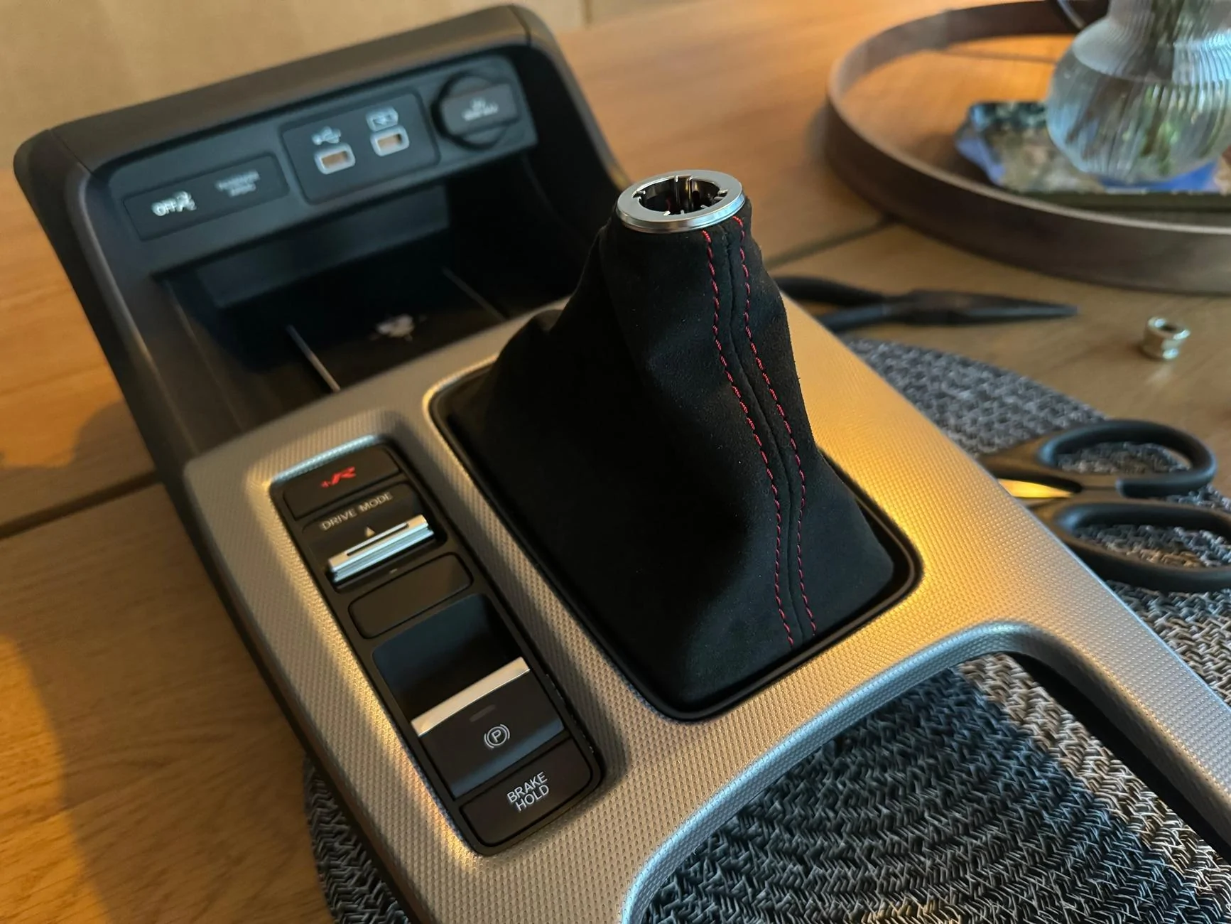

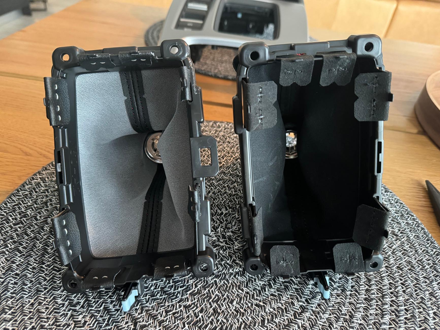

Got off my lazy ass and did the JDM shift boot swap. As mentioned by others yes, the boot frame is very different from the USDM cars. I snapped a couple of photos of the process and the differences between them. Overall, not that hard of an install just need to be patient on removing the staples of each shift boot.
11th Gen Honda Civic Club-Version FL5 Civic Type R Build Thread IMG_0407
11th Gen Honda Civic Club-Version FL5 Civic Type R Build Thread IMG_0408.JPG
11th Gen Honda Civic Club-Version FL5 Civic Type R Build Thread IMG_0412

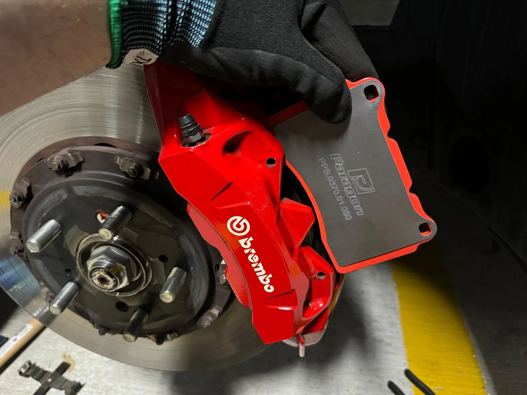

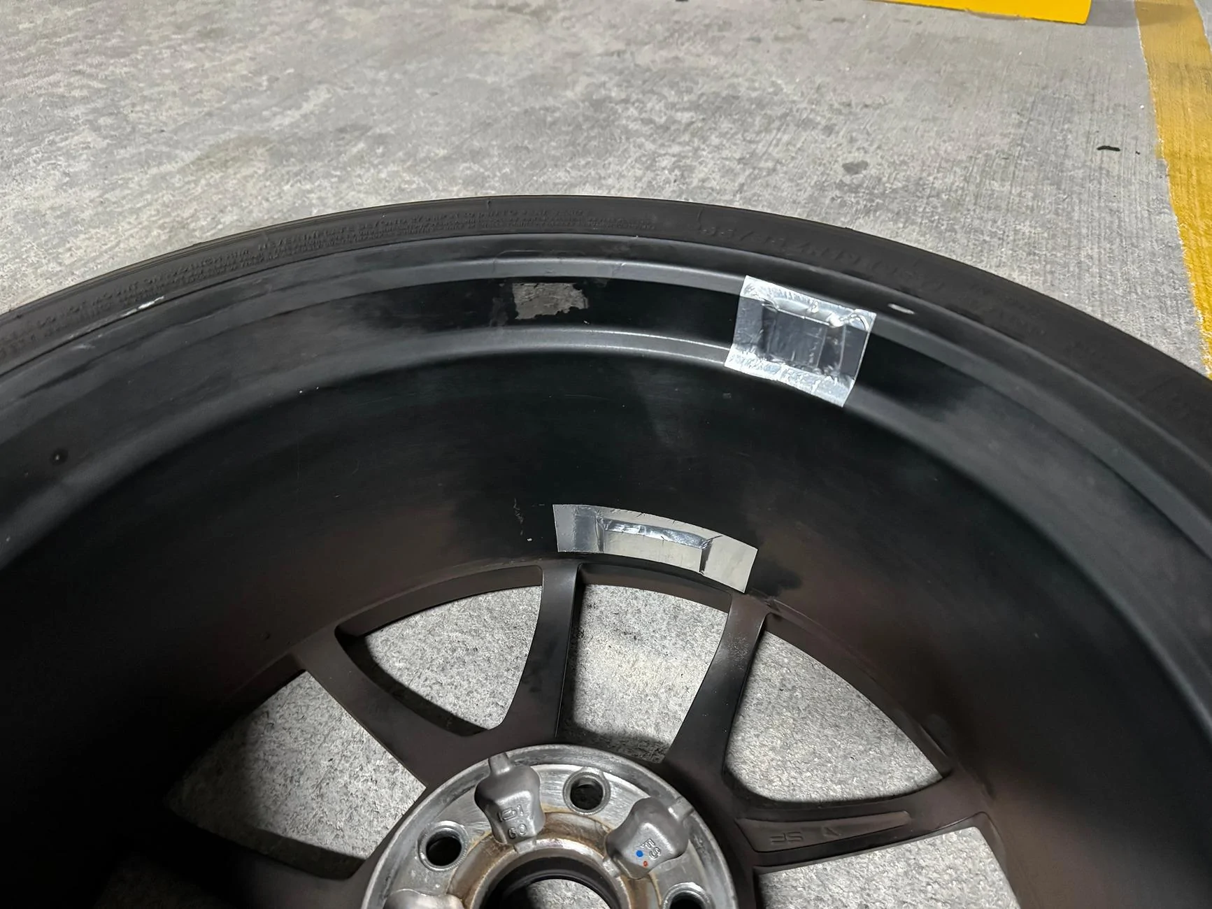

In addition to the shift boot install, I got my car prepared for the next couple of track days coming up for me. Given my Project Mu's had about 4 track days on them and they had about 15% life left, I decided to scoop up the Paragon R5 (Aka Winmax W5) pads along with the titanium shims. I also bled the brake fluid with some fresh Castrol SRF and re-taped my wheel weights with some AC insulation tape. I highly recommend to tape your weights with some type of heat insulation if you're planning on taking your car to track. It's very common to see them flying off during a track day due to increase temps. Enjoy the following install pics I snapped.
11th Gen Honda Civic Club-Version FL5 Civic Type R Build Thread IMG_0416
11th Gen Honda Civic Club-Version FL5 Civic Type R Build Thread IMG_0418
11th Gen Honda Civic Club-Version FL5 Civic Type R Build Thread IMG_0413
11th Gen Honda Civic Club-Version FL5 Civic Type R Build Thread IMG_0414

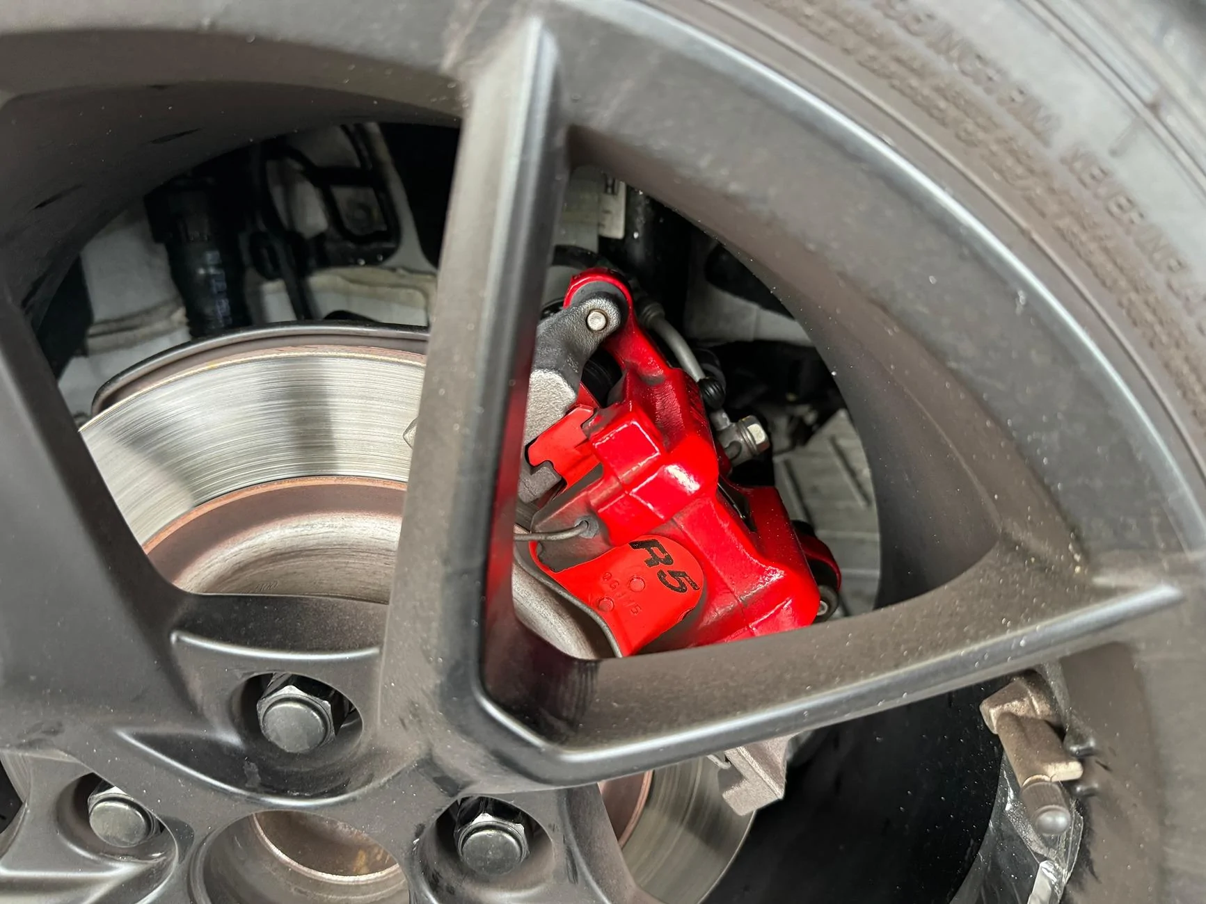

Does the R5 squeak at every stop light?
ttccnn49
Steve
Sep 1, 2022
71
61
florida
Street triple 765RS
Thanks. That’s a no go for me then.
The first couple days it squeak loud, but after a day at track, it become quieter. but couple days after, there is faint squeak coming back...
