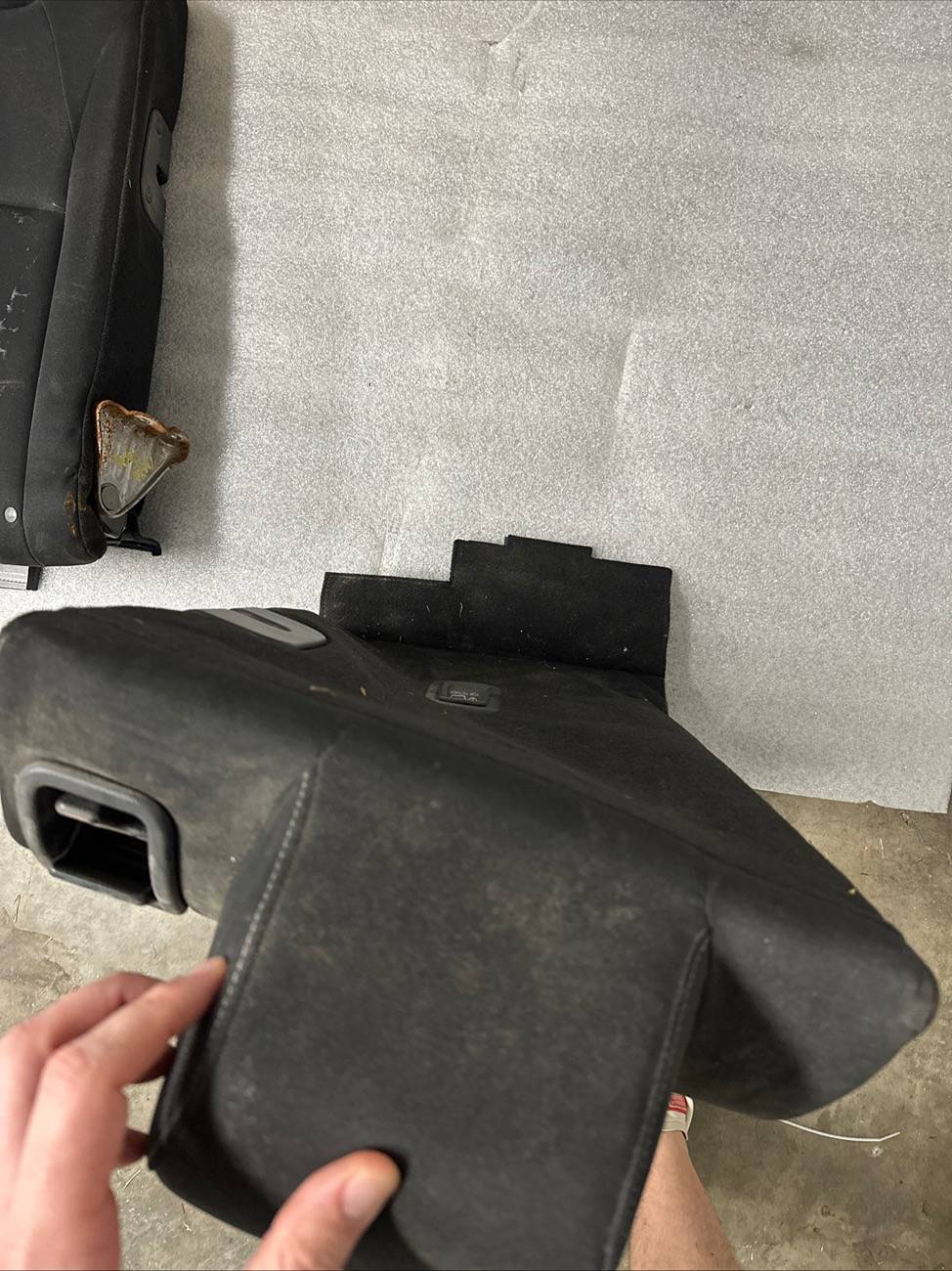

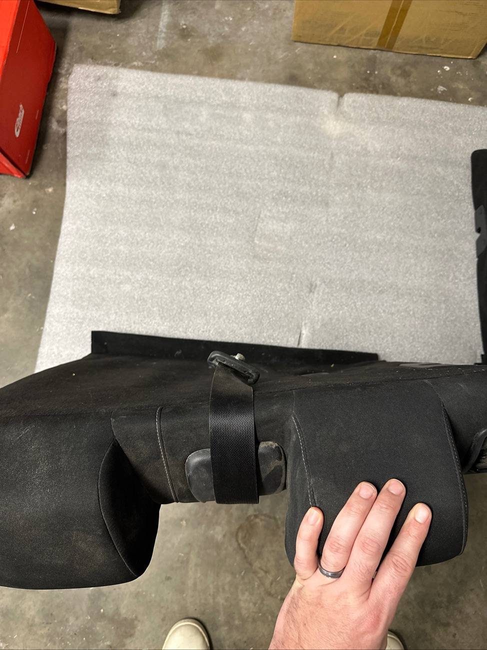

I'll revive this thread to say I was trying to do the same thing but ordered from a recycler as I had none nearby with civic hatchbacks available. These are the "grade A" leather/cloth seats I received from a vehicle in a front end collision and were clean and ready to use based on the listing.
11th Gen Honda Civic Can 3-seat rear bench from Civic hatchback be fitted to FL5? IMG_4953
11th Gen Honda Civic Can 3-seat rear bench from Civic hatchback be fitted to FL5? IMG_4958
11th Gen Honda Civic Can 3-seat rear bench from Civic hatchback be fitted to FL5? IMG_4959
The donor car was a low trim as they are all cloth and very obviously in a rear end collision based on the damage. Moral of the story, go to the recycler and put eyes on seats if you're gonna go that route. I'm contemplating just going with new seats now that I have to deal with returning these pieces of crap.
