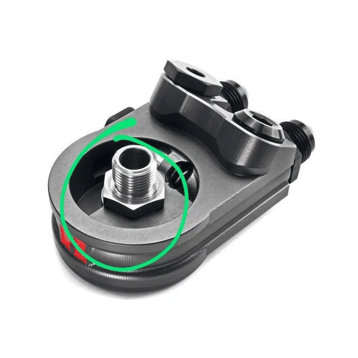

This has probably been the hardest step so far, getting the lines positioned and dialed in. Everything looks good and feels solid.
Also I have a full set of lines at the same specs I have shown and am using. I can sell to anyone interested in recreating this set up. I can do $250 shipped.
I did have to modify one piece, the sandwich plate bolt needed to be cut down on the part that bolts to the oil pan threads. About 1/4".
Had to modify one line as well, it was slightly too long. Tonight I'll update the parts list with the line specs.
Street Testing Results ?
Good news, ambient temps today and yesterday were the same at 95° at the time of driving. Oil temps stayed about 20-25° lower from mid 220s yesterday to high 190s-low 200s today. Coolant stayed way lower barely getting above 190 today, but mostly hanging around the mid to high 180s. It was over 205 yesterday.
The system will really shine when pushed at the track.
Psi dropped about 7-10 psi from 75ish at cruising (3k-4k rpm) down to 65-68, and at redline from 70 down to 61-63. Very similar to what it was on my fk8 set up.
