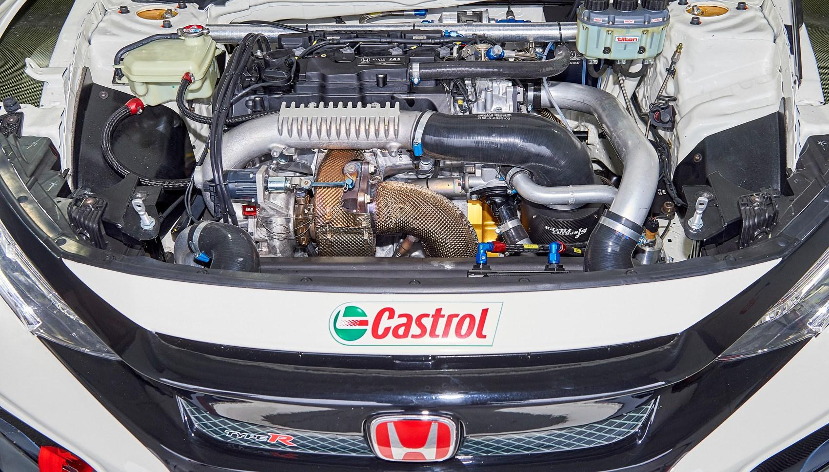

I have been looking into the cooling system for quite some time now and I got it sort of figured out. I should open a specific thread about this but lets give this as a easter egg for whoever gets this far on my topic lol.
11th Gen Honda Civic An in-depth talk about FL5 ECU tuning 1590840274987
11th Gen Honda Civic An in-depth talk about FL5 ECU tuning civic_tcr_108
Both the picture and the Honda manual shot are form an FK8 but it´s all very similar on the FL5 so lets take a GOOD look into it.
Now take a look AGAIN.
If you do know how a cooling system works, yo know that theses cars are designed to pickup heat quickly, mostly for emissions and to avoid seizing the engine on short runs.
Look at how the water the goes to the transmission, to the throttle body and to the cabin heating system circulate from and to the thermostat housing.
And also how the turbocharger coolant line, that goes to the turbo than back to the engine at the water pump inlet.
Now lets think together: This coolant is flowing in and out of the engine without passing trough the radiator when the themostat is closed. Also this coolant is responsible for opening the thermostat when water temperatures rise.
The coolant heats up, the water flowing back and forth heats up the thermostat (remember the thermostat is in the INLET of the water pump not the outlet of the head) then thermostat opens, cold water comes from the radiator, into the engine, then it cools down the thermostat that closes again.
It works in cycles... But even with the termostat opened, a big part of the coolant flows into other paths, other than the radiator, and this cant be good.
Now look at how the TCR type R is set up.... Every other path the coolant could go is blocked. Even turbocharger cooling is deleted so now 100% of the coolant has only one path to go: Trough the radiator and back. Now this has one issue: It would not work with a thermostat, since the thermostat seats in the lower water hose so it is fed cold water, and the expanding element that opens the thermostar in the correct temperature sit on the other side of the flow, so it relies on the coolant flowing in the parallel systems to open.
This car has no parallel systems, therefore, it has no thermostat.
This is almost perfect, besides the fact that to run such system at the street you lose transmission cooling, cabin heating and turbocharger cooling.
I am not concerned about losing turbocharger cooling since I have deleted it in many cars and never had an issue, but I dont want to lose the heating, and the transmission lines so my plan is the following.
Adding a electric valve that blocks coolant flow into the cabin for the heating element (many cars have this from the factory, but not ours), removing the transmission cooling from the main system and adding a separate radiator for it. Deleting turbocharger coolant lines, delete stupid throttle body heating and to finish: adding a thermostat on the TOP coolant hose, with the expanding element facing the HEAD so it gets fed hot water. Ad a couple holes in the thermostat housing to keep the water pump from cavitating and VOILÁ, a TCR coolant system WITH a thermostat to keep you from running too cold at the street.
Add an engine oil cooler to help and you should be good to go.

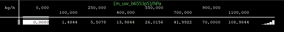

There is no sensor, but as many other things, it is calulated. To understand the pressure at the turbocharger inlet the ecu measures ambient pressure and then calculates the pressure drop at the intake tube, like this:
11th Gen Honda Civic An in-depth talk about FL5 ECU tuning 1703765419835
this is pressure drop as a function of air mass.
Now to know the actual pressure on the turbocharger outlet, it does the opposite. Since pressure is measured after the intercooler, it calculates the pressure drop on the core and does the reverse math from it.
11th Gen Honda Civic An in-depth talk about FL5 ECU tuning 1703765514602
On most cases, compaction ratio tables are provided by the turbocharger manufacturer so it is usually safe to raise torque request values until the car starts running on these tables.

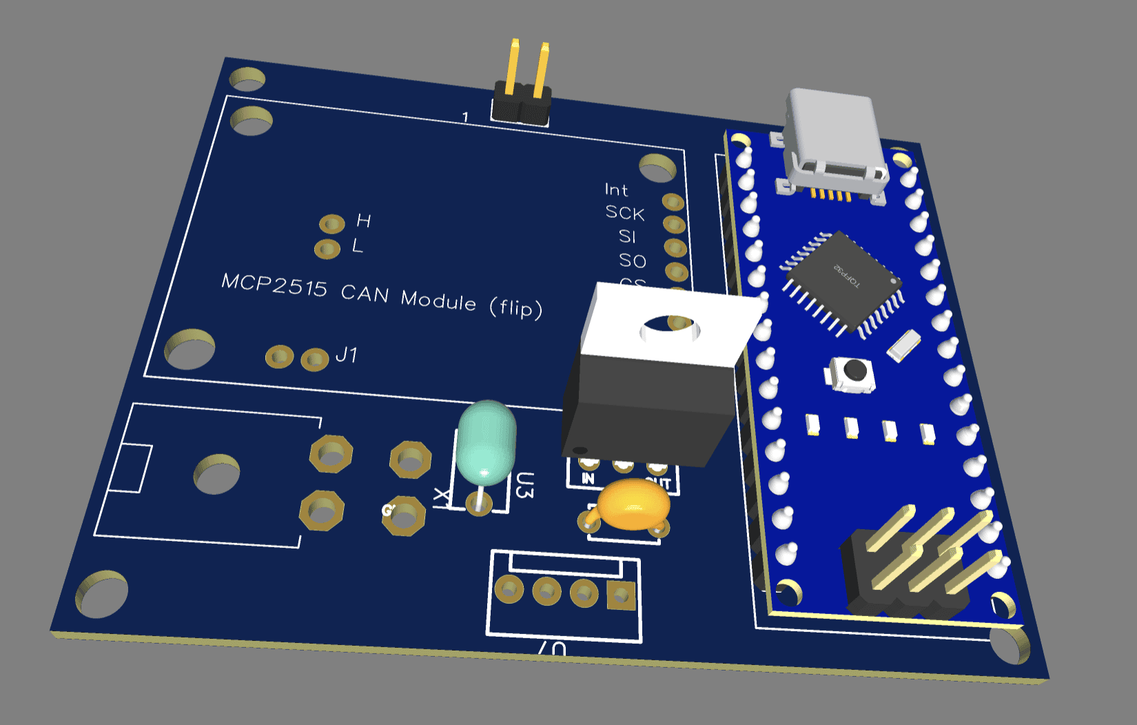

Not a lof of updates lately, wife is pregnant and we have a 1 year old girl, so not a lof of spare time.
Either way, been working on a lot of cool things, one of them is a CAN LCD to display ecu data on a 5 inch touch sceen display, AND, another can module that goes on the engine bay, that gets all sorts of extra sensors data and throw it on the can.
It also controls extra radiator fans.
So from the inside of the car I can see on the same screen, conected to the can wires my sensor data together with ecu data that is not available at the dash like lambda for example.
11th Gen Honda Civic An in-depth talk about FL5 ECU tuning 1704504665945
SImple board design at one side, based on arduino uno because Im lazy.
11th Gen Honda Civic An in-depth talk about FL5 ECU tuning 1704504747279
THis, somewhere on the dash. Not sure where, but will 3d print something that makes sense
And I´m finishing the design of the board that goes at the bay.
Then another 30 days to manufacture in china because im too old to make pcbs at home lol.
Then we´ll see.
Also from a tuning perspective, added lots of cool features to the tune, just haven´t had time to test. Car is filthy dirt at the garage but hopefully on sunday I can test it.
