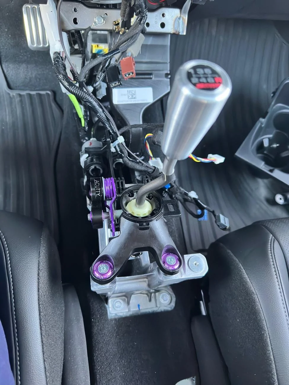

Yes, I had the shifter cable bushings before and that was an improvement, but I added the rest of the upgrade pieces for the shifter lever assembly recently and it makes an already good shifter even better. Was totally worth the upgrade.

nice, how hard was the install? Haven't installed my base bushings yet because it looked like a lot of work to get to the shifter. i hate messing with interior trim. always end up breaking or losing something.

Its actually easy to do, just a little tedious. Taking apart the trim is easy, its just trying to remember plugging everything in after that can be an issue sometimes. I recommend having a retractable magnet for the bolts under the cup holder and to be careful with the spacers and retaining washers that come with the short throw adapter, they dont hold together all too well.
I also made it a little easier on myself by buying a 2nd OEM lever assembly, installing the upgrade parts on that and just swapping it out for the existing one in the car.
Surprisingly I used Hybrid Racings short shifter install video as a reference to uninstall and reinstall the shifter.
