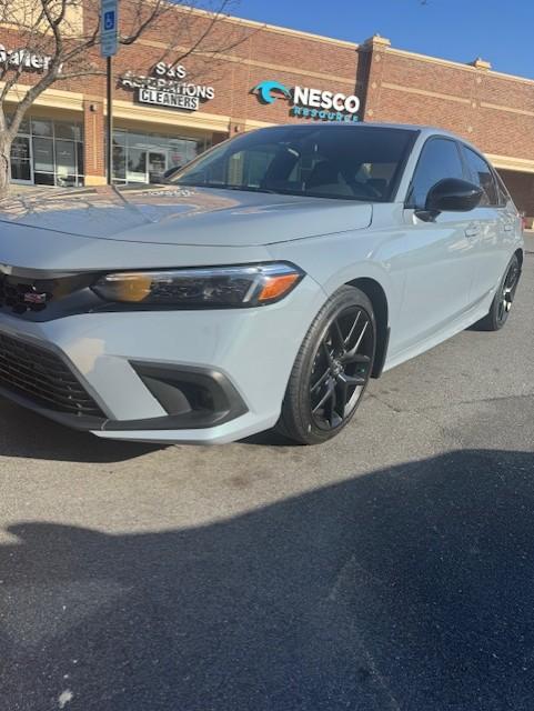

I got my used 23' Si about 4 months ago. When I got it, it was bone stock and looked like this:
11th Gen Honda Civic 23' Si Build so far, maybe some useful info front drivers stock

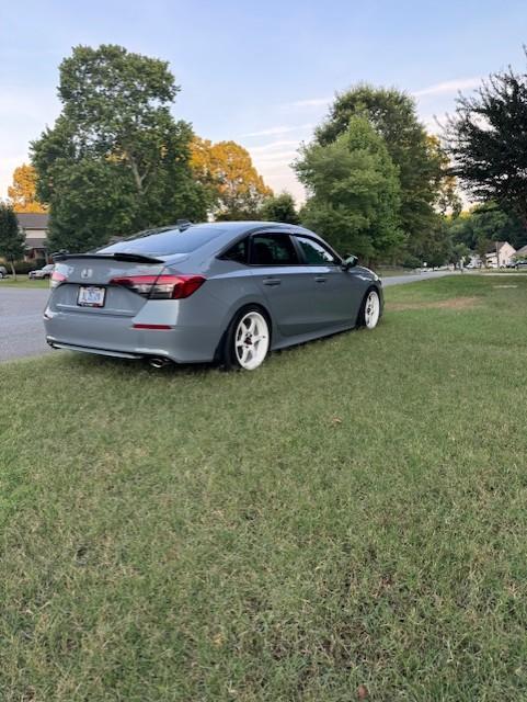

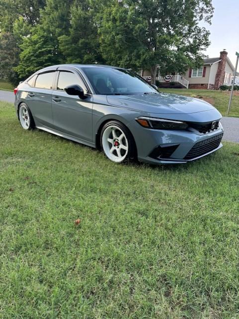

Now the car looks like this:
11th Gen Honda Civic 23' Si Build so far, maybe some useful info front passenger grass
11th Gen Honda Civic 23' Si Build so far, maybe some useful info back passenger grass
So in lowering the car while correcting camber, I was able to retain a very OEM like driving experience, with better handling. I would NOT ever lower a car and not correct the camber. I hate uneven tire wear and I absolutely hate how twitchy cars can be when they have negative camber. Please note that even with the eibach pro kit, I had to max out both the factory camber adjustment bolt in the front AND the adjustment from the new adjustable balljoints to correct a total of 3 degrees of camber from the drop springs. Same for the rear. You will spend an extra $300 in parts but will get a perfect install doing it the right way. On the wheels, the +35 offset and factory tires on an 8.5" wheel coupled with this drop has meant absolutely no rubbing or scrubbing in any circumstances as far as I can tell. As far as the tune, I went with tsp1 to be easy on the car while its still under warranty. after my warranty is out, I will go to either tsp2 OR pherable tunes after upgrading the head studs and clutch. I will also be doing the downpipe and intercooler at the same time.
