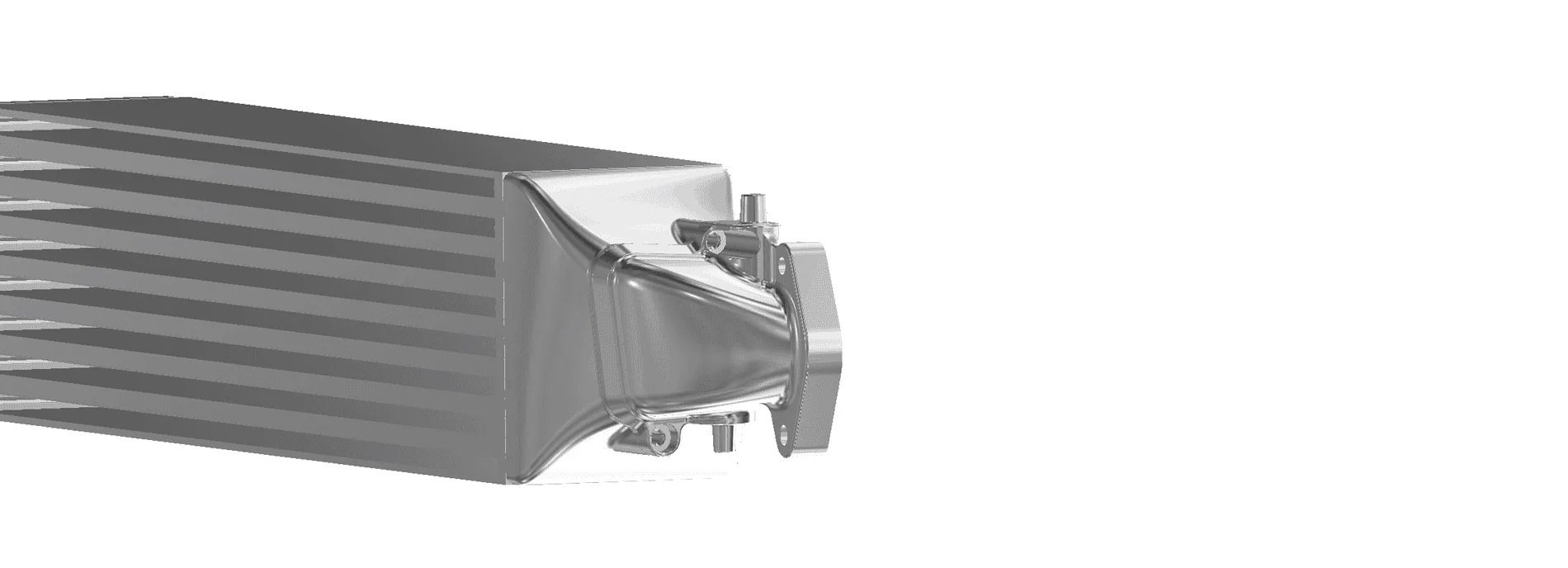

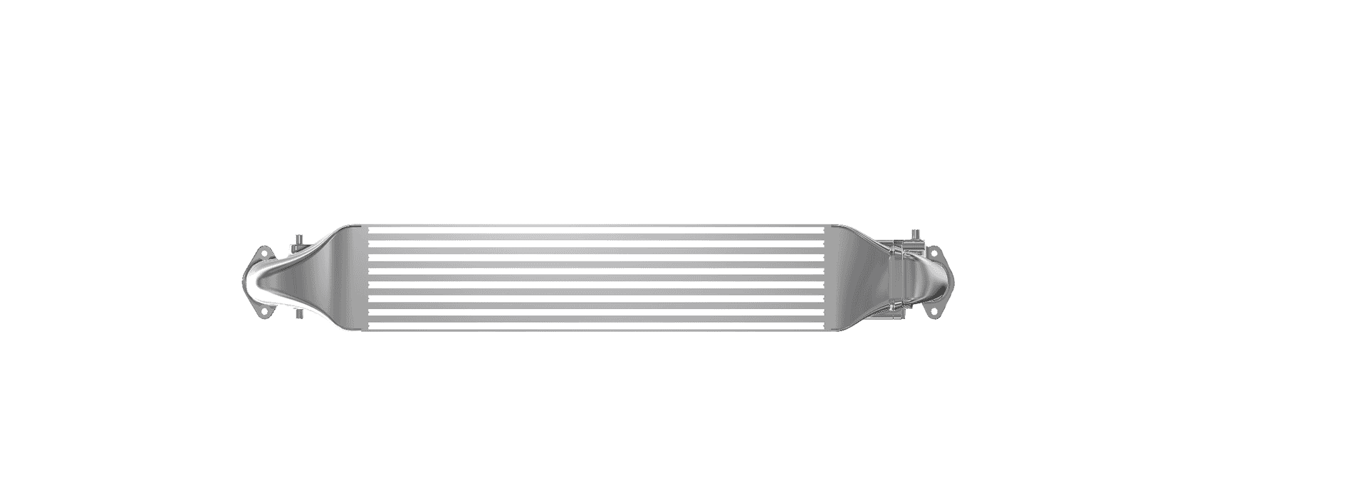

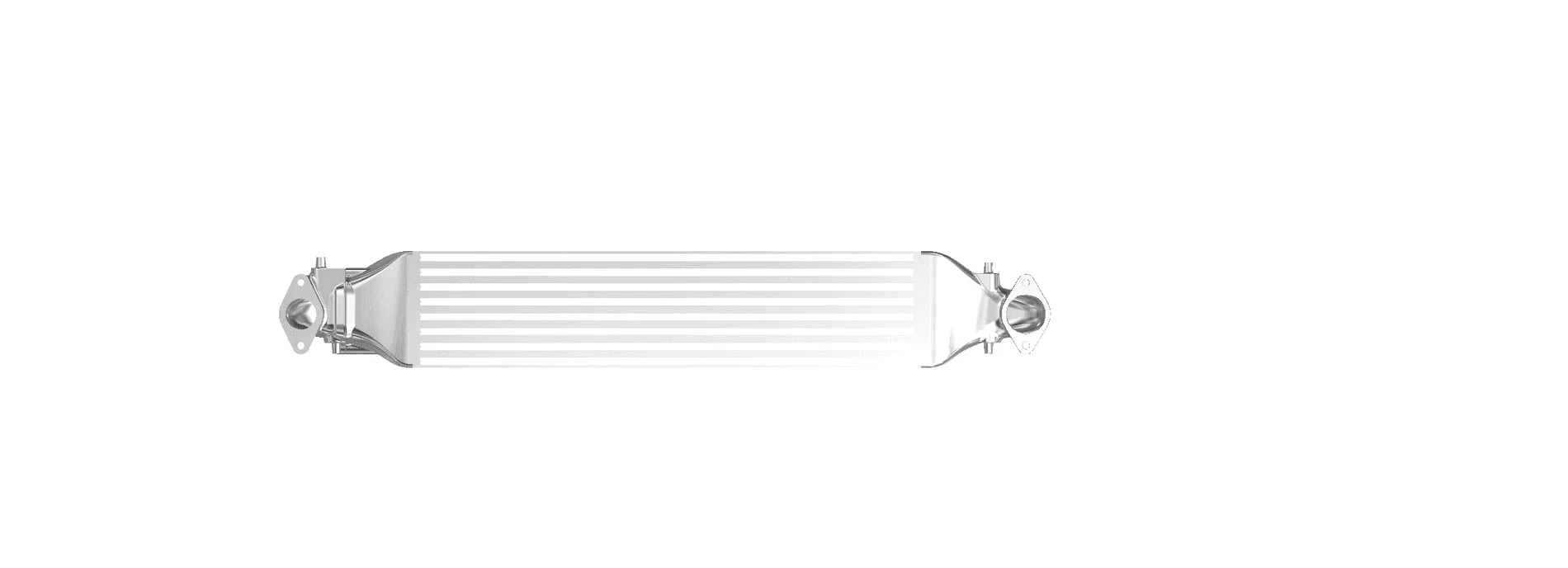

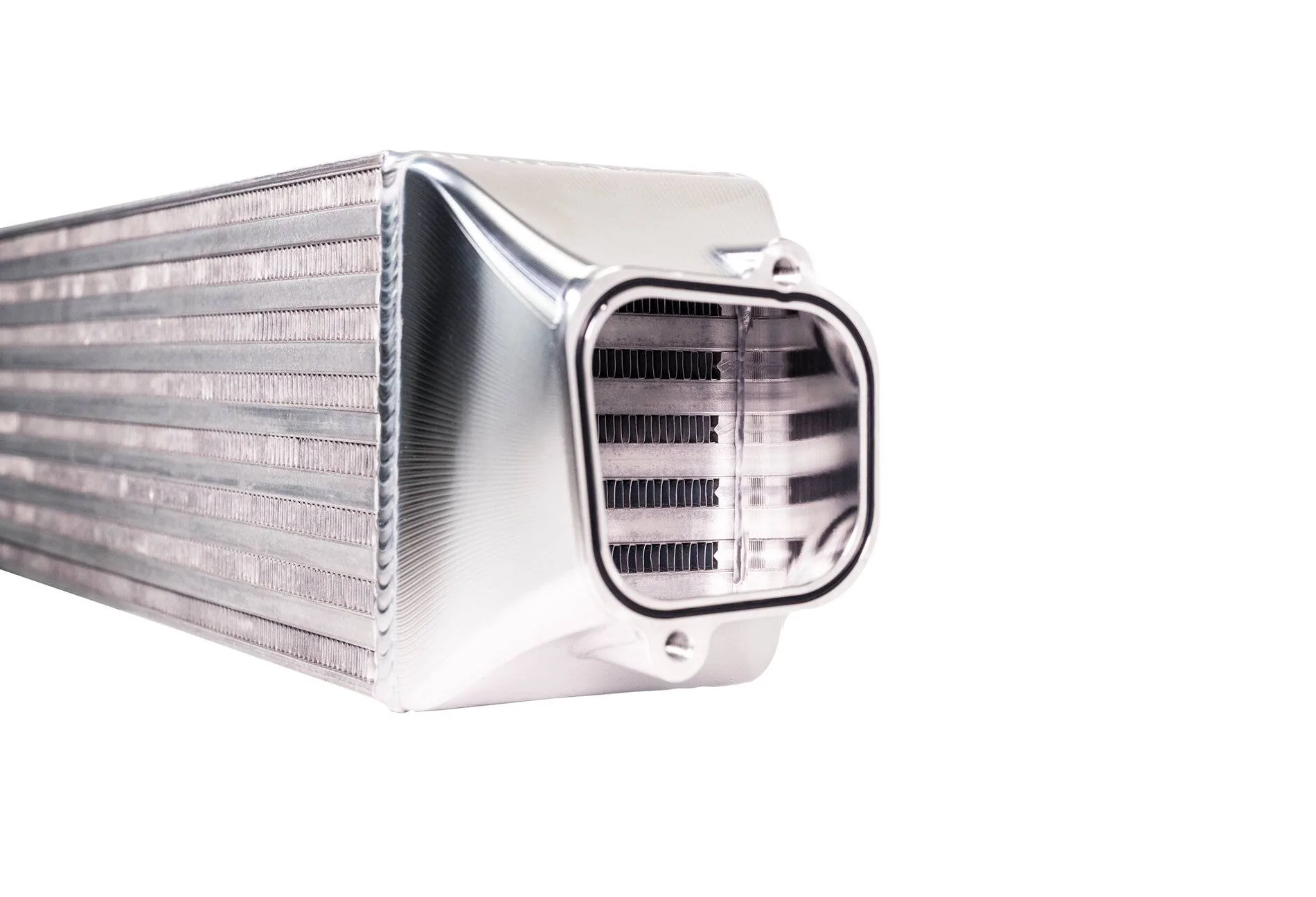

Our focus is to develop an intercooler upgrade that fits like factory, but looks and performs like a premium product customers want to be proud to showoff. The 11th Gen Civic’s facelift forced our engineers to draw up a complete redesign, but the engine’s characteristics are still remnant of the previous 10th Gen 1.5L Turbo platform (more-so the 10th Gen 1.5T Accord, actually). While Honda’s new engine bay and front end actually increased space notably (possibly for increased airflow/cooling?), the Civic’s new front bumper actually provided us with spacing constraints. Going off of data we have collected from previous platforms, we have drawn up a proposed intercooler core that offers similar internal airflow volume as our intercooler upgrade for the previous generation Civic. Maintaining this internal airflow volume (and fin pitch design) was important to us, because we have seen the negative affects of increasing internal volume too much with Honda’s 1.5L Turbo platform in the past. These proposed core dimensions are suited perfectly for the 1.5L engine displacement, factory turbocharger and most any aftermarket turbocharger size that will be offered for this car. Though this new design will be a bit shorter than the 10th Gens, it will still offer a significant increase in frontal surface area and utilize a dense fin pitch for desired cooling, all without hindering airflow to the radiator. No cutting or modification are required and factory bumper air guides are retained. As always, no tuning required!
11th Gen Honda Civic 11th Gen Civic 1.5T Intercooler Upgrade Development & Release! 214686384_906364039918825_1668742022616794719_n
11th Gen Honda Civic 11th Gen Civic 1.5T Intercooler Upgrade Development & Release! 212789305_208580864399616_2368247817543811667_n

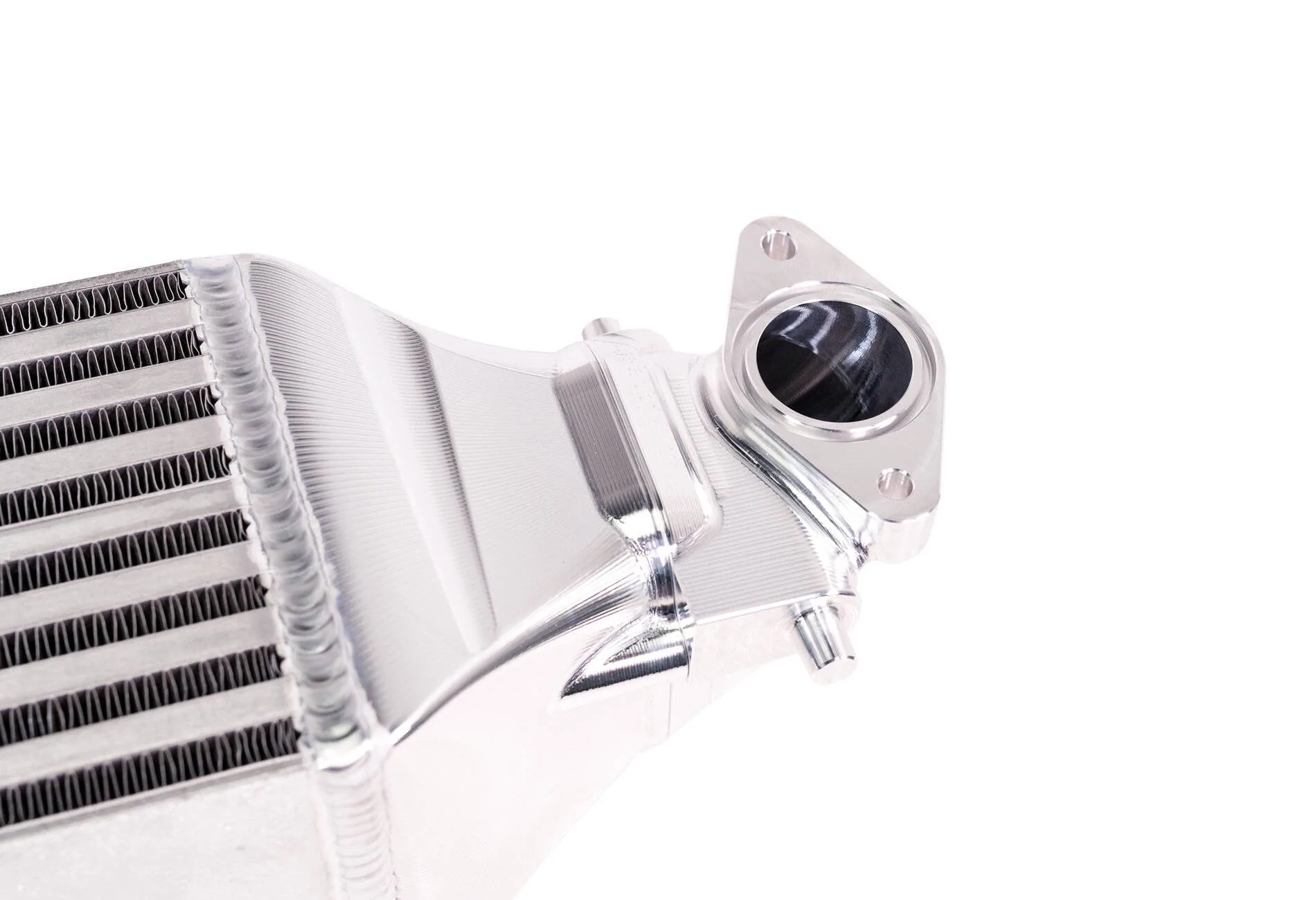

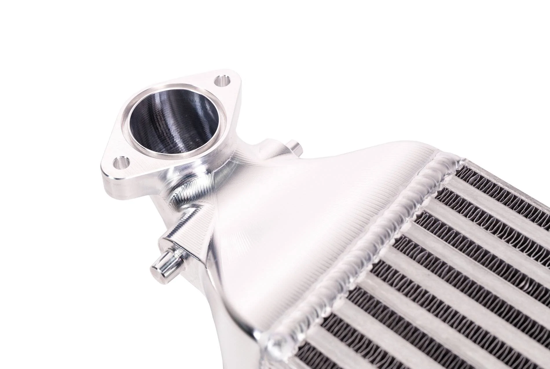

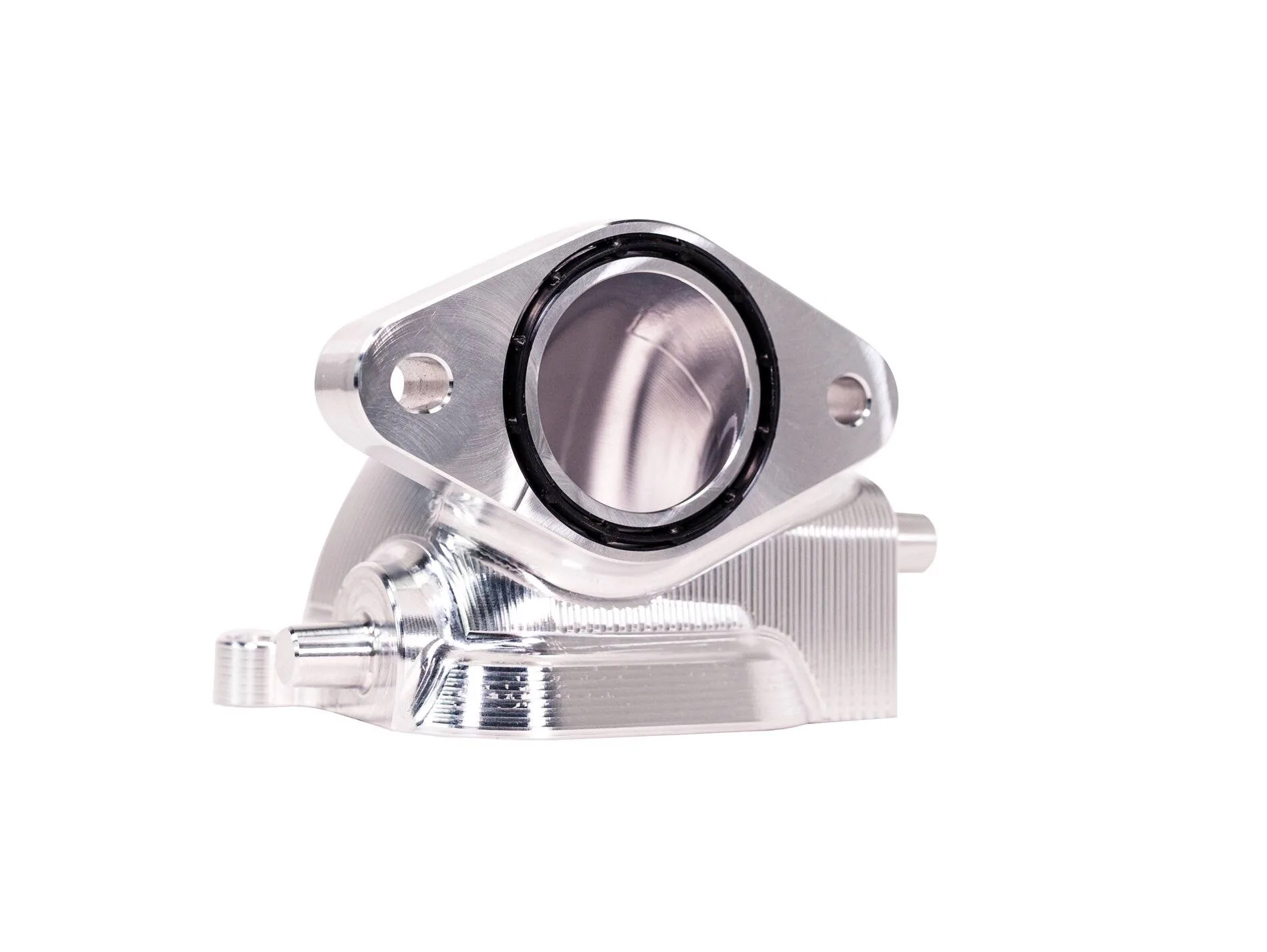

As per usual PRL fashion, we will be using billet 6061 aluminum end tanks in our intercooler assembly. Viewers may notice a two-piece end tank design on the driver side – this two-piece design allows us to fit the end mills on our CNC machines into the end tanks for machining. Our end tanks will feature a smooth internal profile to avoid turbulence and a modular design for compatibility with both factory and future PRL charge pipe upgrade.
We expect to have a prototype intercooler sample, designed to spec, in-hand within the next couple of weeks. Stay tuned for final dimensions, testing data and more information!

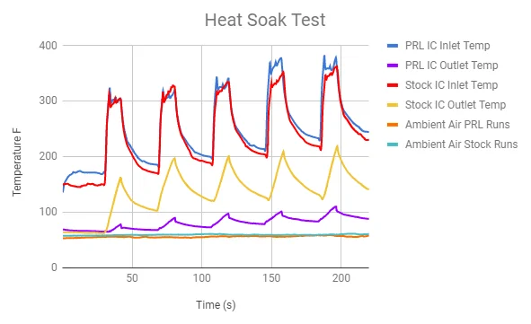

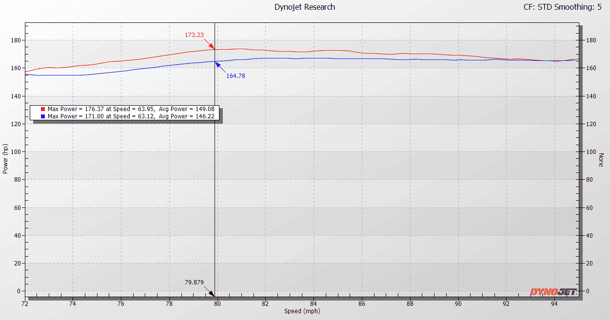

In order to continue improving our intercooler designs, we equipped our 2022 Honda Civic 1.5L Turbo Touring model test mule with some additional sensing equipment. We are using one type-j thermocouple and one 50psi MAP sensor at the intercooler inlet, and one of each at the outlet. These are interfaced through an AEM CD-5 Digital dash, where we can monitor and log change in temperature and change in pressure across our intercooler cores. Having access to this data during R&D allows us to fine tune important aspects of our intercoolers such as fin density, fin pitch, core dimensions and end tank design in order to squeeze every ounce of horsepower out of our products. The dyno session was started by taking a completely stock baseline run at an average temperature of 59°F and an elevation of 1160ft. We saw some very interesting trends as far as the performance of the stock intercooler, but more on that later. After our baseline testing, we went ahead and swapped the stock intercooler for our upgraded intercooler and resumed testing. Here’s what we found:
11th Gen Honda Civic 11th Gen Civic 1.5T Intercooler Upgrade Development & Release! PRL vs Stock IC.PNG
We saw a maximum recorded power of 171WHP and an average of 146WHP with the stock intercooler, and a maximum recorded power of 176WHP and an average of 149WHP with our intercooler. However, we saw as much as a 9WHP increase in the mid-range. After completing the power runs, we went ahead and performed an intercooler performance test on each intercooler. This consisted of doing a pull in the car from 20MPH to 110MPH, allowing a 26-second interval (approximate time of pull plus 15 seconds), then repeating that procedure multiple times until each intercooler reached heat soak. Heat soak was determined when we were no longer seeing a significant increase in the outlet temperature of the intercooler.
11th Gen Honda Civic 11th Gen Civic 1.5T Intercooler Upgrade Development & Release! Heat Soak Test
During the heat soak test, it can be seen that the intercooler inlet temperatures remained consistent with each other, with slight deviation, however, the outlet temperatures were significantly different. With the stock intercooler, we were seeing temperature spikes as high as 220°F after a few pulls. Furthermore, the peak outlet temperature of the initial pull was 162°F where the PRL intercooler was 78°F. The PRL intercooler reached heat soak at around 112°F compared to the stock 220°F.

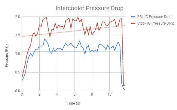

The stock intercooler had an average pressure drop across the core of 1.5psi tapering up to 1.75psi average at the end of the pull. The PRL intercooler showed an average of 1.05psi, which stayed consistent throughout the pull. While this difference may not seem significant, it tells us a few important things. First of all, our fin design is not only more efficient at exchanging heat than the factory design, but it is also less restrictive. It also tells us, more importantly, that the PRL intercooler provides more headroom for boost. As we discussed in our 11th Gen Civic 1.5T Intercooler Upgrade Development Part 1 blog post, this intercooler uses a similar core design and the same fin pitch density (both internal and external) as our previous intercooler upgrades. It's also important to note that the gains of an intercooler upgrade will continue to increase exponentially as more power and boost is added.

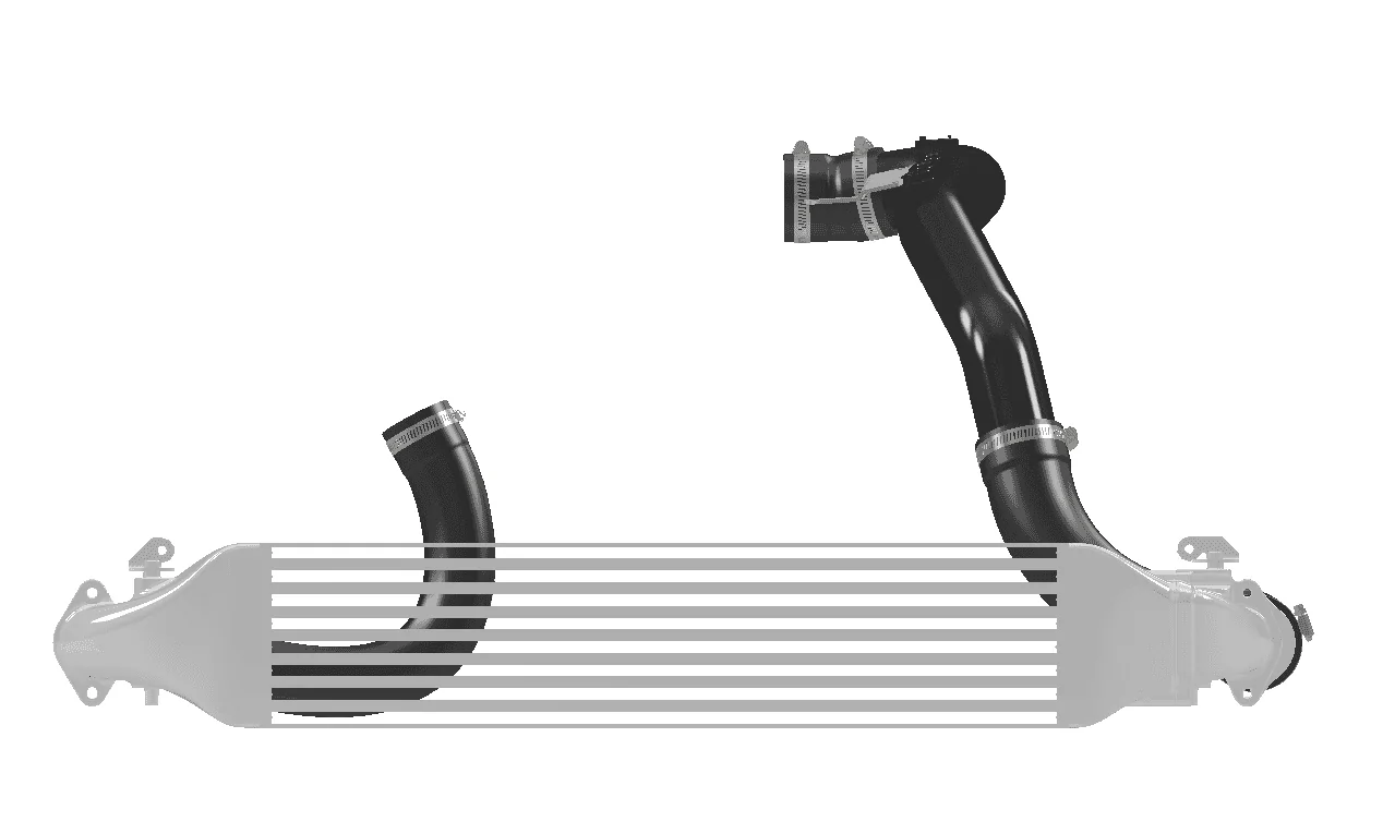

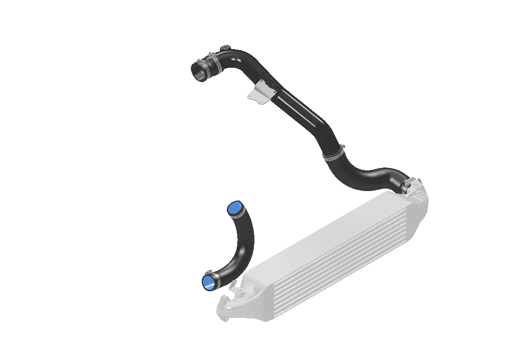

Pre-Orders for the PRL Motorsports Charge Pipe Upgrade Kit and High Volume Intercooler & Charge Pipe Combo Kit for the 2022+ Honda Civic 1.5T 11th Gen are now live!
Customers can purchase our High Volume Intercooler & Charge Pipe Upgrade Combo Kit together for optimal performance & savings, or all kits can be purchased separately.
