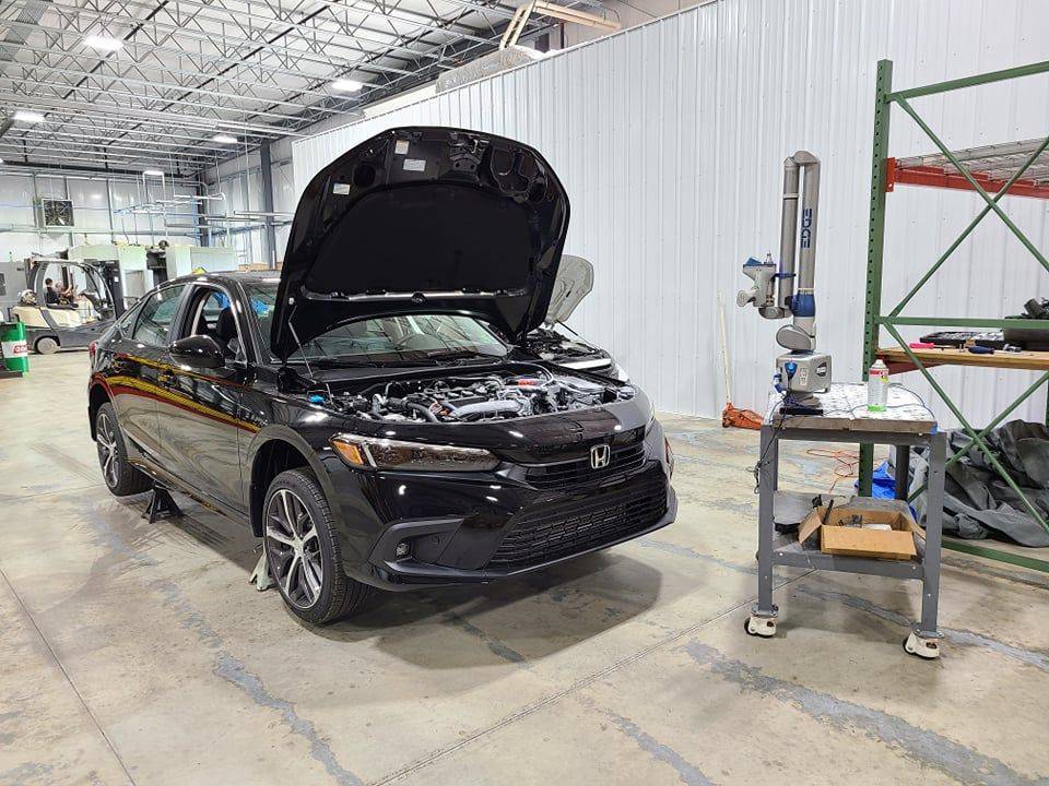

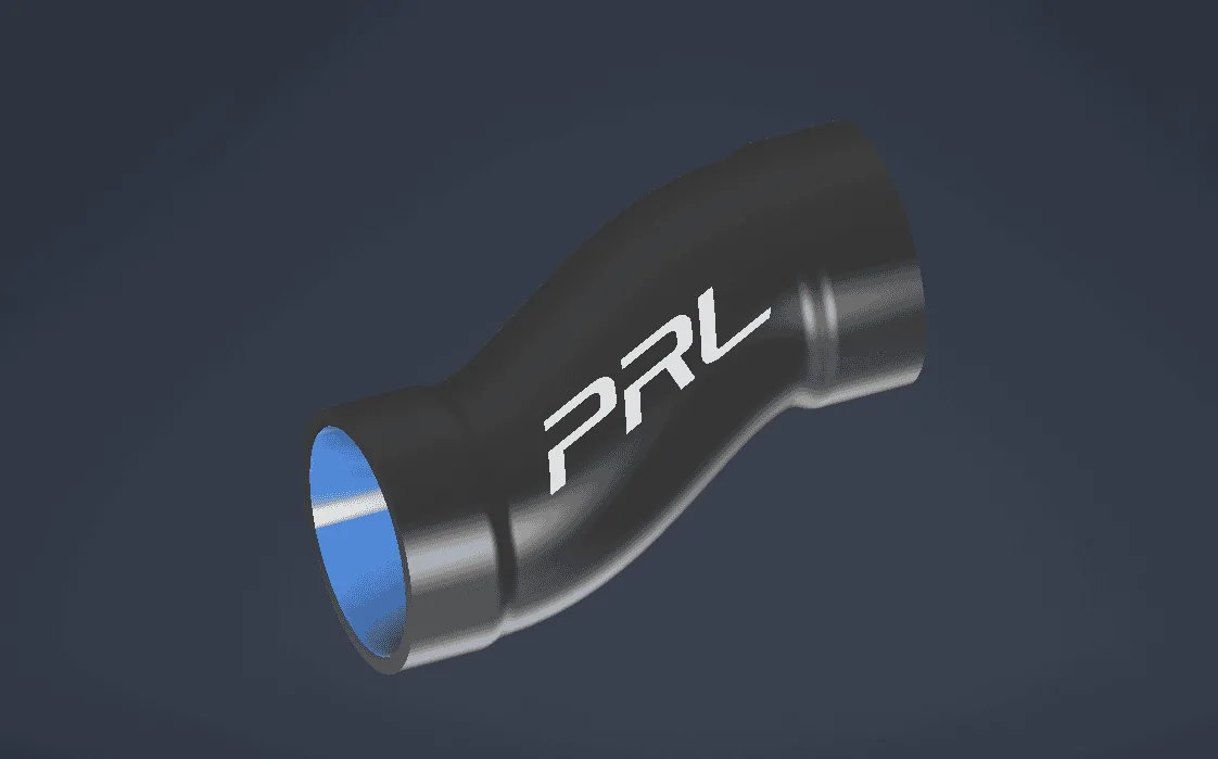

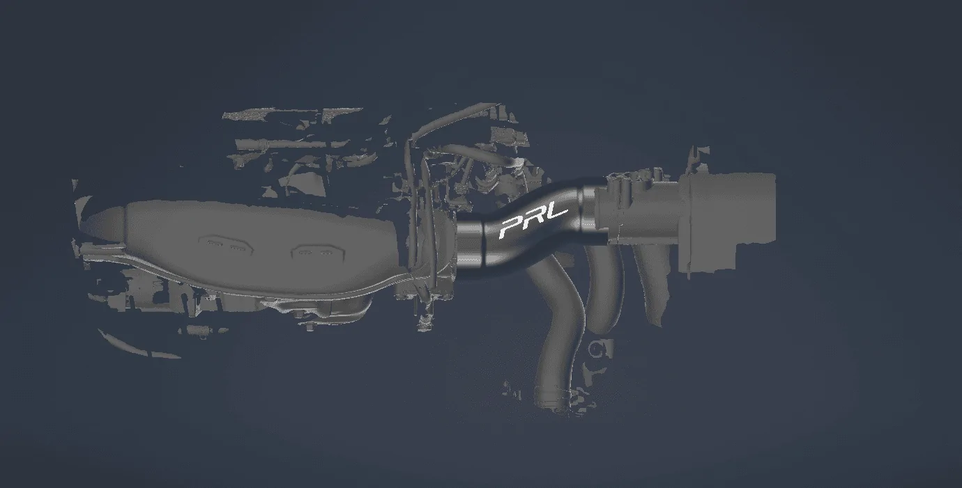

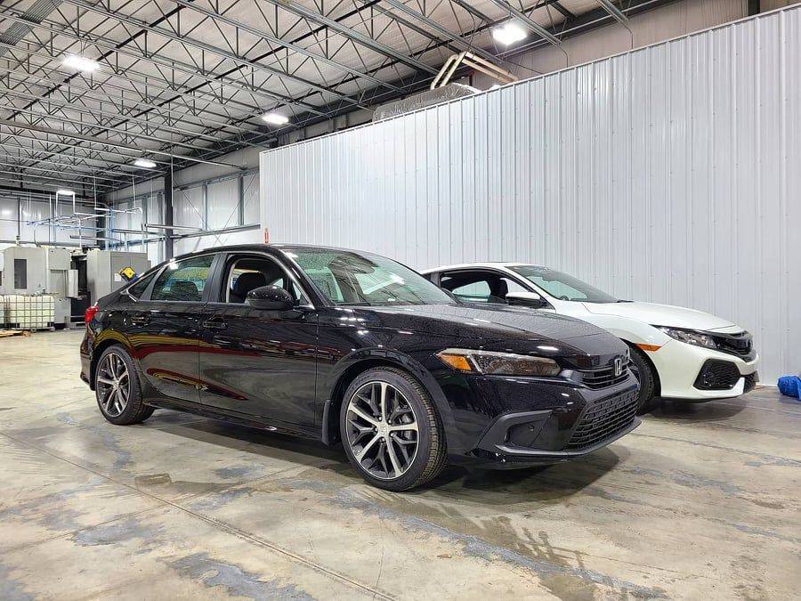

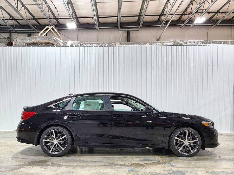

Yesterday we welcomed home our new 2022 11th Gen Honda Civic 1.5T and immediately began extensive R&D. Here's a sneak peak of what we've come up with already!

Stay tuned to our social media, PRL Army Blog and forum(s) as we post updates throughout the product development process. We can't wait see how far the PRL Motorsports Team and community can push this platform!

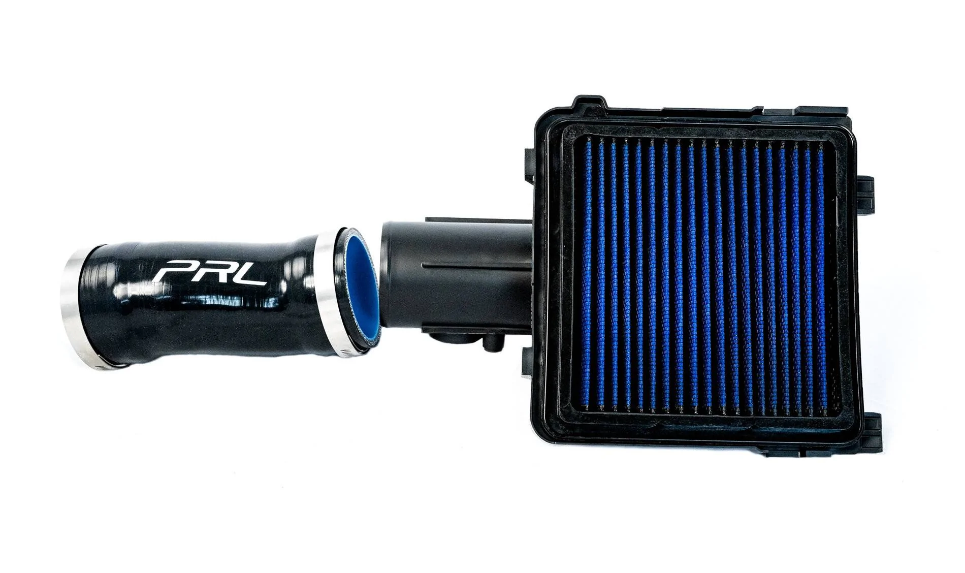

Last week we strapped our 11th Gen Civic 1.5T Touring to the dyno to collect some baseline numbers. Conveniently, our Product Development Team managed to design and receive a prototype a Silicone Intake Hose Upgrade just in time for testing. We were able to install this prototype hose the same day and use before and after numbers for product gains.

With the Stage 1 Prototype Intake that included a 3D printed intake hose, 3D printed resonator delete plug and OEM panel filter, we saw an average power of 167.7 HP and an average peak power of 171.3 HP. This is an average gain of 2.3 HP and an average peak gain of 2.6 HP.
11th Gen Honda Civic PRL Motorsports 1.5T Civic Stage 1 Intake Development image006
Comparing the two dyno sessions in their entirety, we saw maximum mid-range gains as much as 4.6 HP at 82 MPH. With a silicone intake tube, billet aluminum resonator delete plug and a PRL drop in panel filter, we are expecting gains up to 5-6 HP on completely stock ECU mapping. We’re pumped with these gains for the dollar value. For those looking for a bit more out of their 11th Gen Civic, stay tuned for more details and development on our full intake system upgrade in the future!
We will be selling the Silicone Hose Upgrade, Drop-In Panel Filter Upgrade and Air Box Resonator Delete Plug separately as individual products, and together as a complete Stage 1 Intake System Upgrade. Silicone Hose Upgrade Kits are now available!

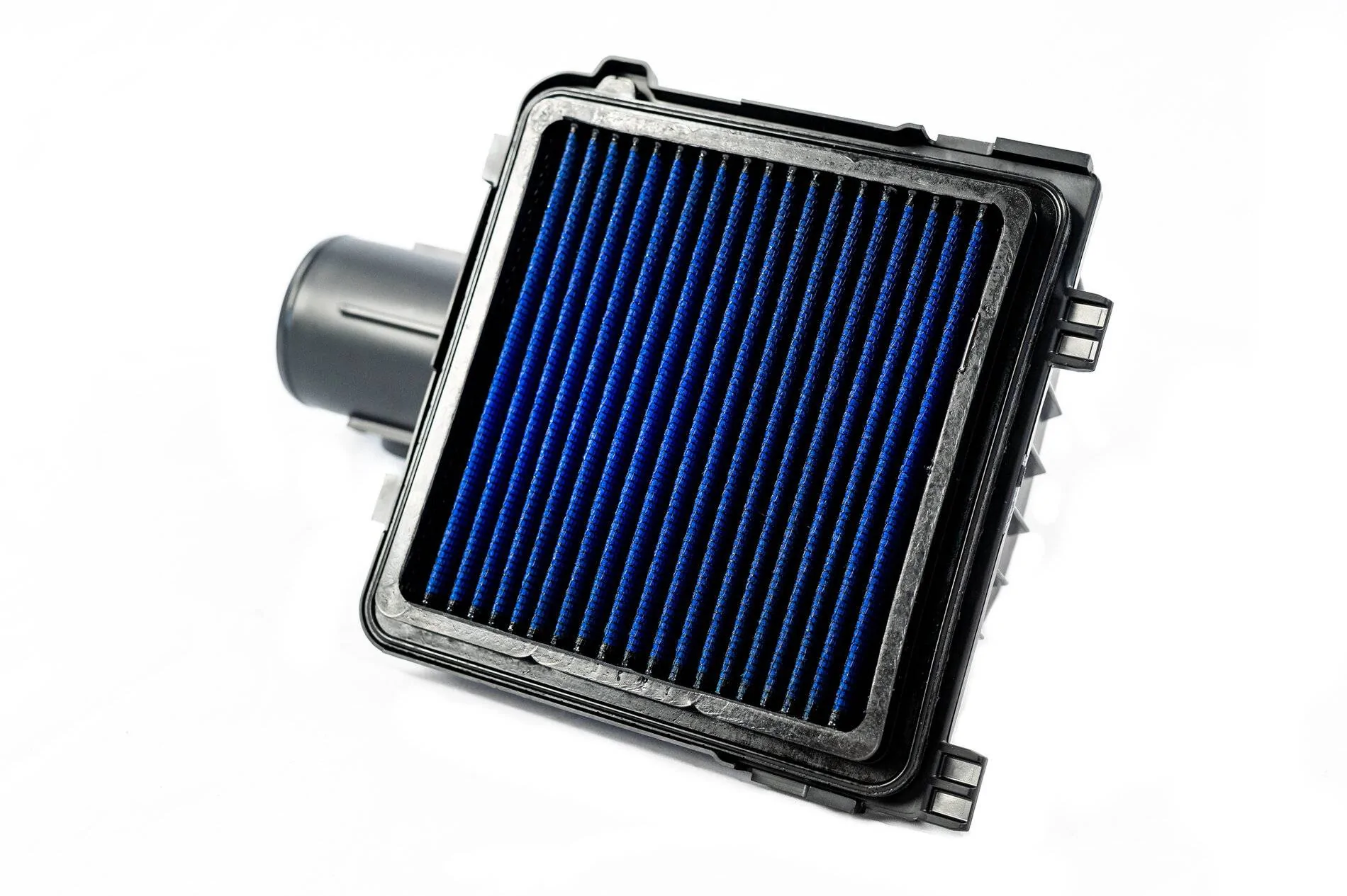

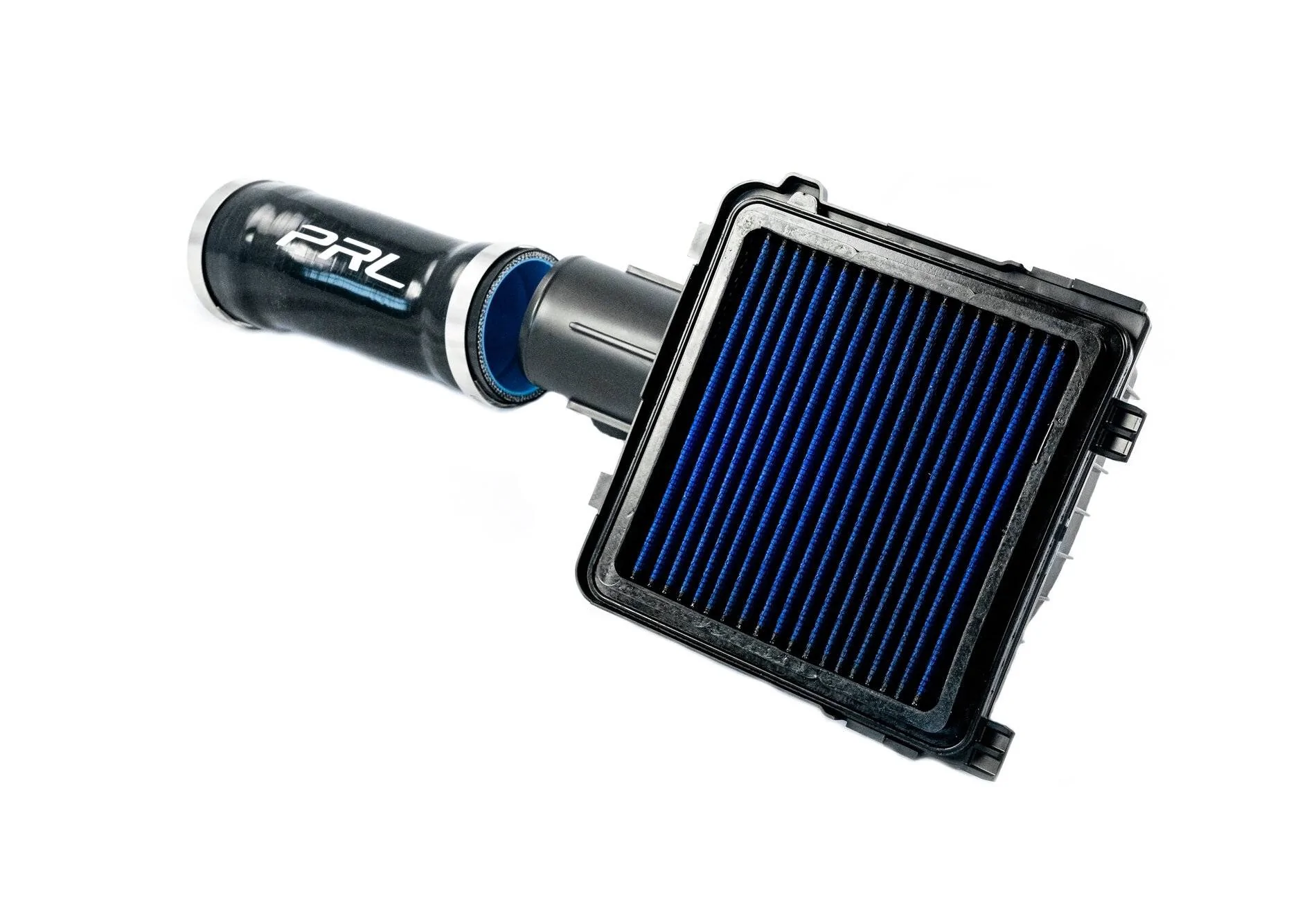

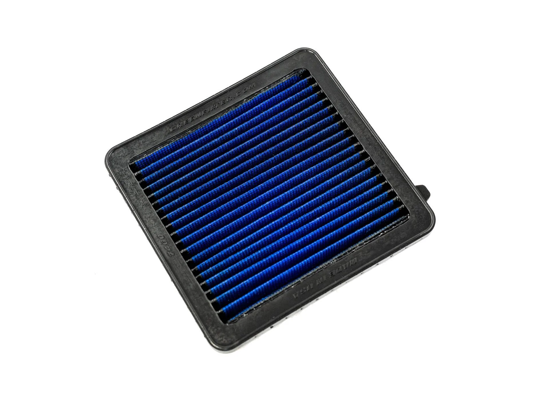

New product releases for the 2022+ 11th Gen Honda Civic 1.5L!
Stage 1 Intake System: $89.99 PRL-HC11-INT-S1
https://prlmotorsports.com/products...e-1-intake-system?_pos=3&_sid=07e2497a3&_ss=r
Replacement Panel Air Filter Upgrade: $49.99 PRL-AF-5082
https://prlmotorsports.com/products...ir-filter-upgrade?_pos=4&_sid=07e2497a3&_ss=r
Silicone Intake Hose Upgrade: $39.99 PRL-HC11-INT-HOSE
https://prlmotorsports.com/products...e-intake-hose-kit?_pos=2&_sid=07e2497a3&_ss=r
Stay tuned for more details and development on our full intake system upgrade and other products in the future!
