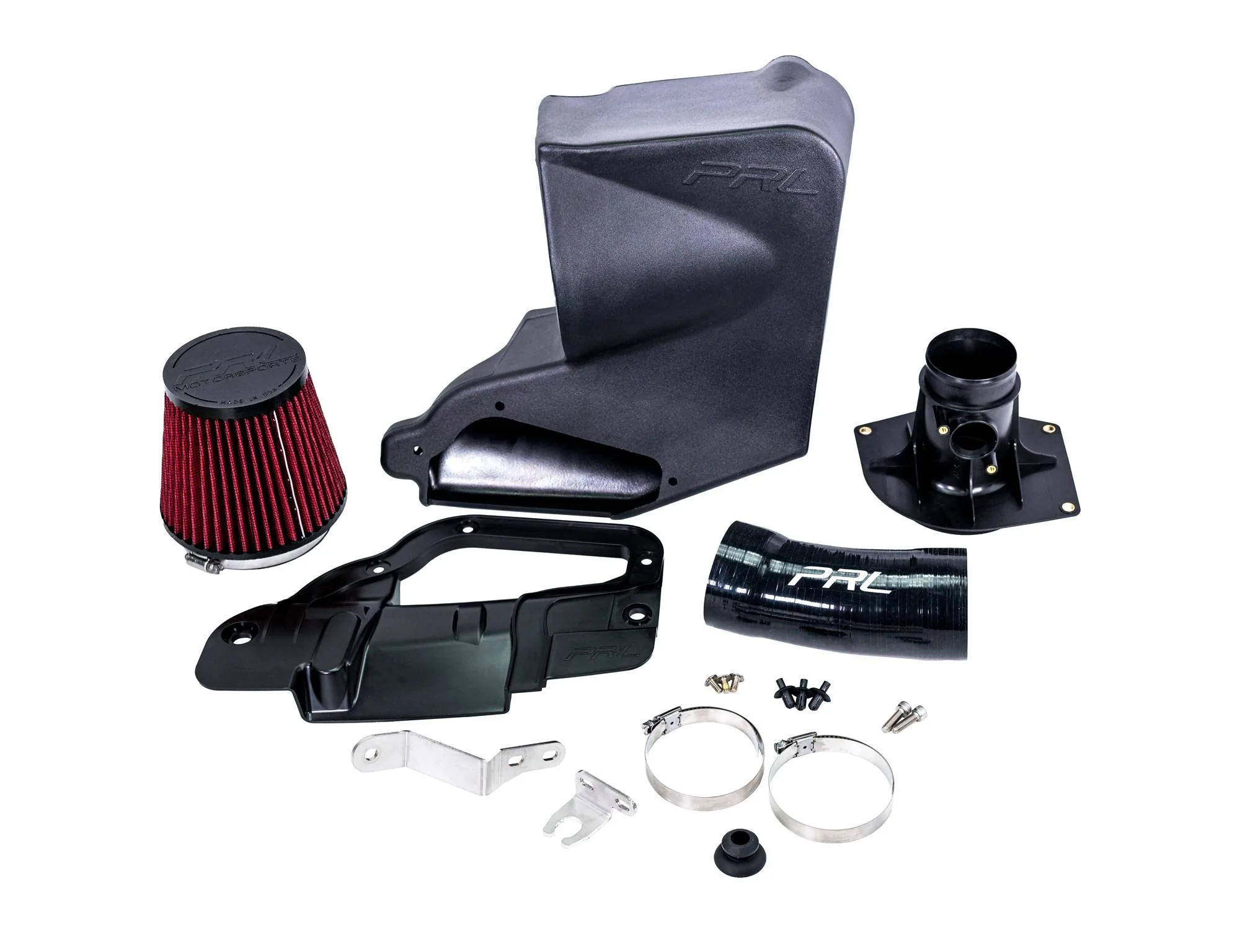

The last time we posted about the 11th Gen Honda Civic 1.5T High Volume Intake System, we were still in the development phase of the design. Today we are here to post some updates on some of our functioning, first article prototype samples. Recently, the PRL team was able to strap our 11th Gen Civic Si to the dyno to see what kind of gains we could make with a totally stock ECU calibration.
Before we get into the nitty gritty regarding power gains, it’s worth mentioning some of the changes Honda made between the 11th and 10th Gen 1.5L Turbo cars. The factory intake system on the 11th Gen is a vast improvement over the 10th Gen, with it's functioning air duct that utilizes a significantly larger inlet that drapes over the core support and pulls cool air in from in front of the radiator.

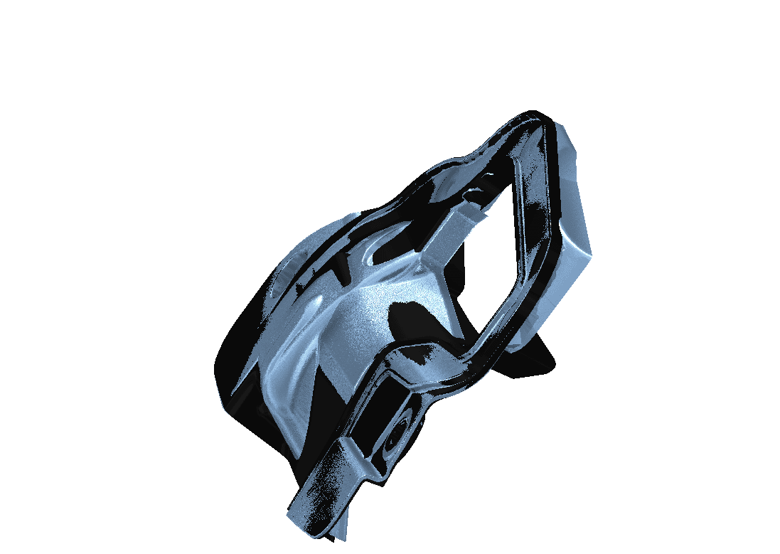

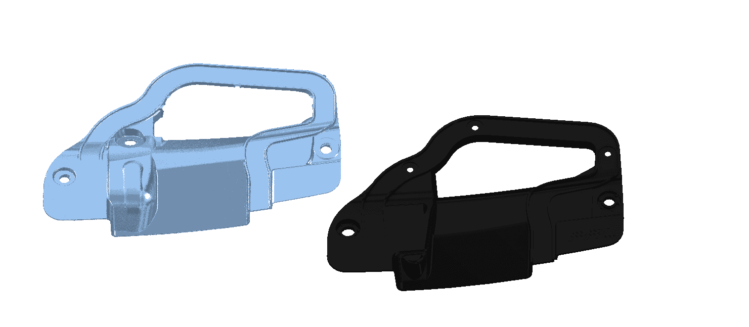

How were we able to improve upon the factory intake's design? The main contributing factors to how our intake will improve in terms of performance all come down to increasing air volume and decreasing air temps. We were able to increase the inlet size to the maximum allowable without performing more extensive modifications. Examining the comparison pictures (pictured below), the PRL inlet (black) has a total opening size increase of approximately 23%. Furthermore, we did away with the factory ribbing blocking the air path on the factory design by using a high density thermoplastic blend, which provides enough structural rigidity to warrant eliminating the ribbing. The result of that is the air rushing into the box has a much smoother path, which promotes an increase of horsepower.
11th Gen Honda Civic 2022+ Honda Civic 1.5T High Volume Intake System Development Stock V PRL Duct 4.PNG
11th Gen Honda Civic 2022+ Honda Civic 1.5T High Volume Intake System Development Stock V PRL Duct 1.PNG
11th Gen Honda Civic 2022+ Honda Civic 1.5T High Volume Intake System Development Stock V PRL Duct 2.PNG
11th Gen Honda Civic 2022+ Honda Civic 1.5T High Volume Intake System Development Stock V PRL Duct 3.PNG
Beyond this, we significantly increased total volume housed by the air box. This means that a larger majority of the ambient air is separated from the hot engine bay, which improves the power produced during combustion due to higher air density.

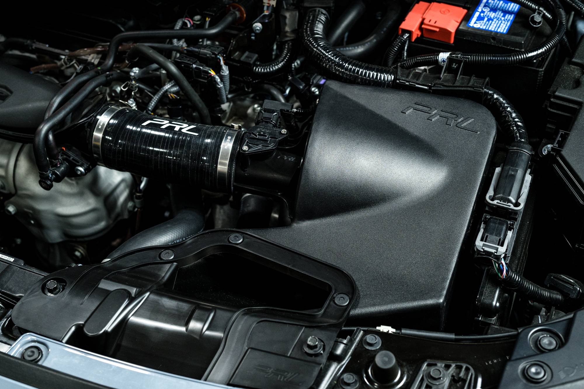

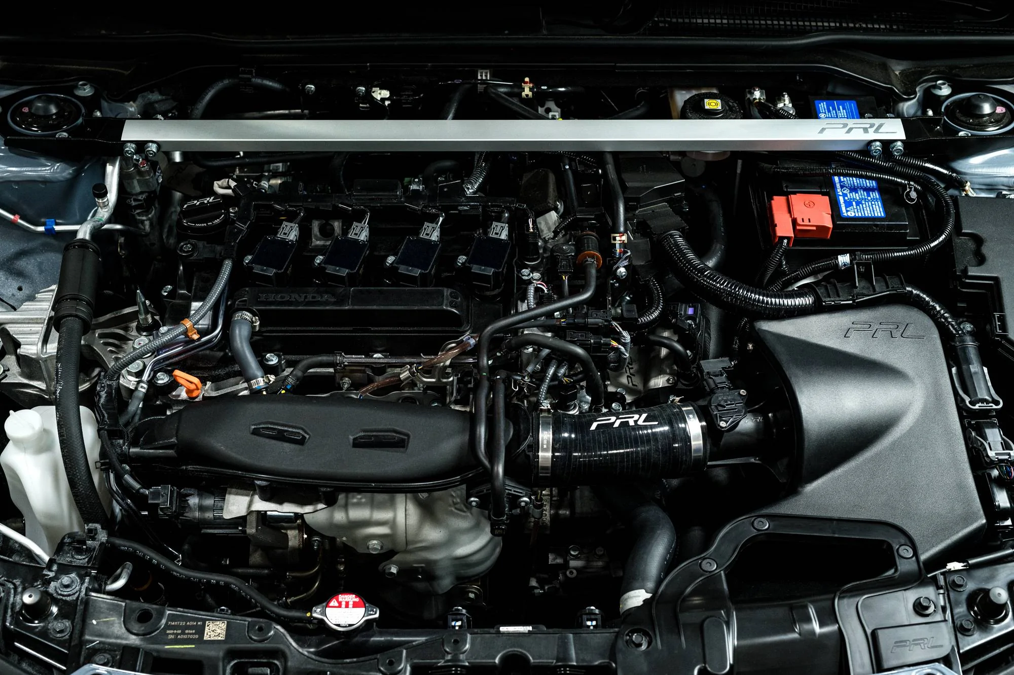

Our team has also confirmed fitment of our 11th Gen Civic 1.5T HVI with the 2023+ 5th Gen Acura Integra 1.5T. We plan to release pre-orders within the next month. Customers can click "Notify When Available" on our product listings to receive an alert when pre-orders are live!
