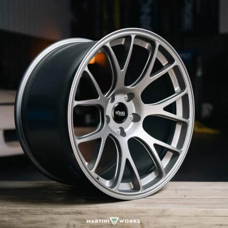

Thanks everyone for the feedback. I know the increase to 35 series is doable on stock wheels, but i wasn't sure if the 44mm offset would push that outer corner into a conflict zone with the body.
I've made the decision to go forward with the plan: Konig F1M wheels (19x9.5 et44)
11th Gen Honda Civic Will it Rub? The Plan: 19x9.5 et44 wheels, 265/35-19 Michelin / Continental all seasons 1747237809602-a8
And Continental DWS06 (265/35-19). That will give me an extra half inch of sidewall for potholes and filling out the wheel wells, and the offset change will get rid of the old milk truck look. I should have them in 10-14 days. I'm very excited.
