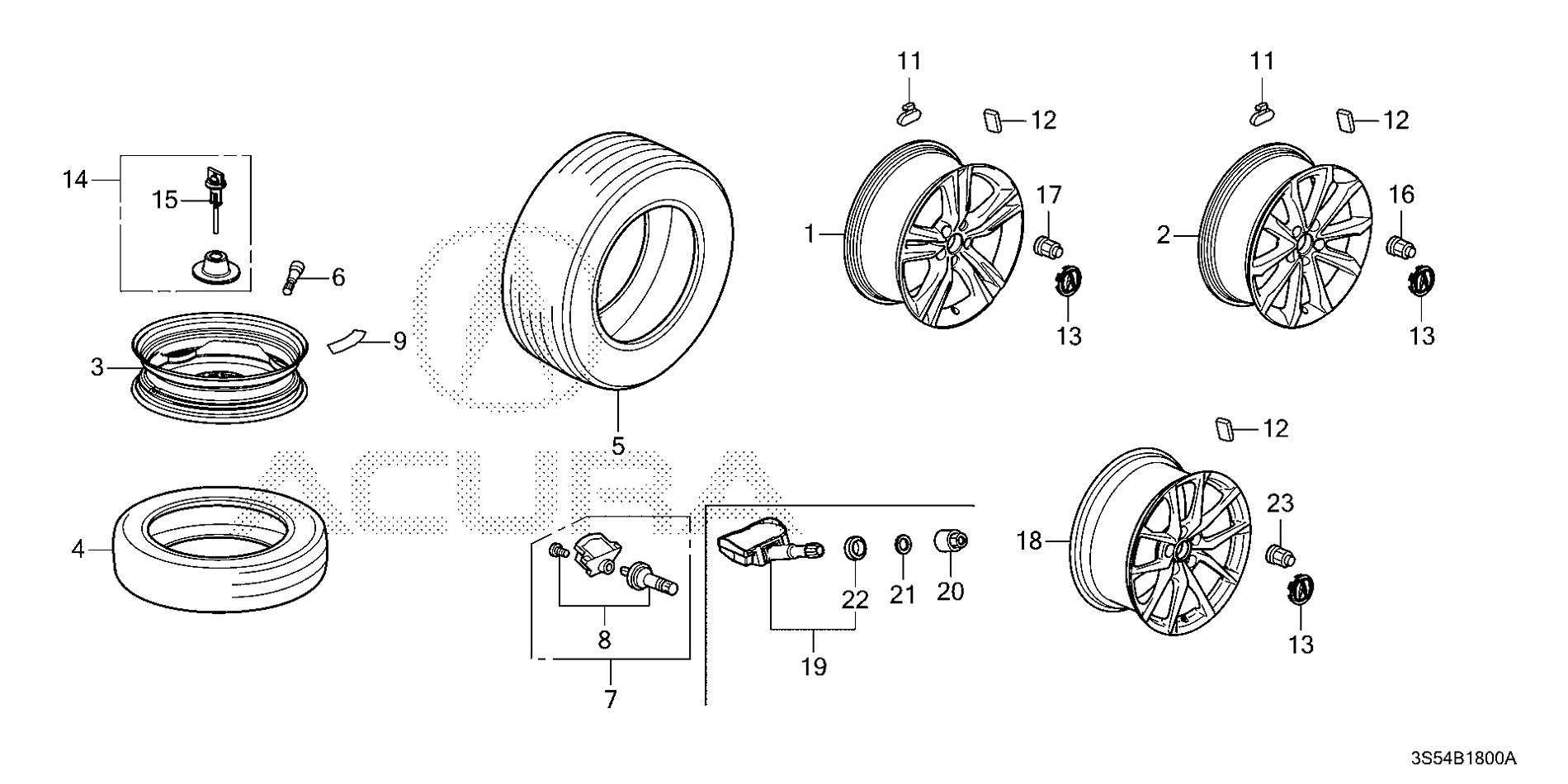

I am looking at picking up a set of bronze ITS wheels for my 2nd set and want to know if the 90 degree valve stems from the stock FL5 wheels would work on them?
Also, does anyone happen to know that part number?

17.VALVE ASSY., ALUMINUM WHEEL
Part Number: 42753-T60-A91
MSRP : $12.53
18.O-RING
Part Number: 42756-T60-A91
MSRP : $2.55
19.PLUG, VALVE
Part Number: 42757-T60-A91
MSRP : $4.65
20.CAP, VALVE
Part Number: 42758-T60-A91

ITS wheels use a straight stem. Ninety degree CTR stems won't work. Google the respective wheel images and you'll see the differences.
As requested.
19.SENSOR ASSY., TPMS
Part Number: 42753-T6N-E03
MSRP : $46.47
20.NUT, TPMS VALVE
Part Number: 42754-TP6-A81
MSRP : $2.74
21.WASHER, TPMS VALVE
Part Number: 42755-TP6-A81
MSRP : $6.23
22.SEAL, VALVE
Part Number: 42756-TP6-A81
MSRP : $1.63
