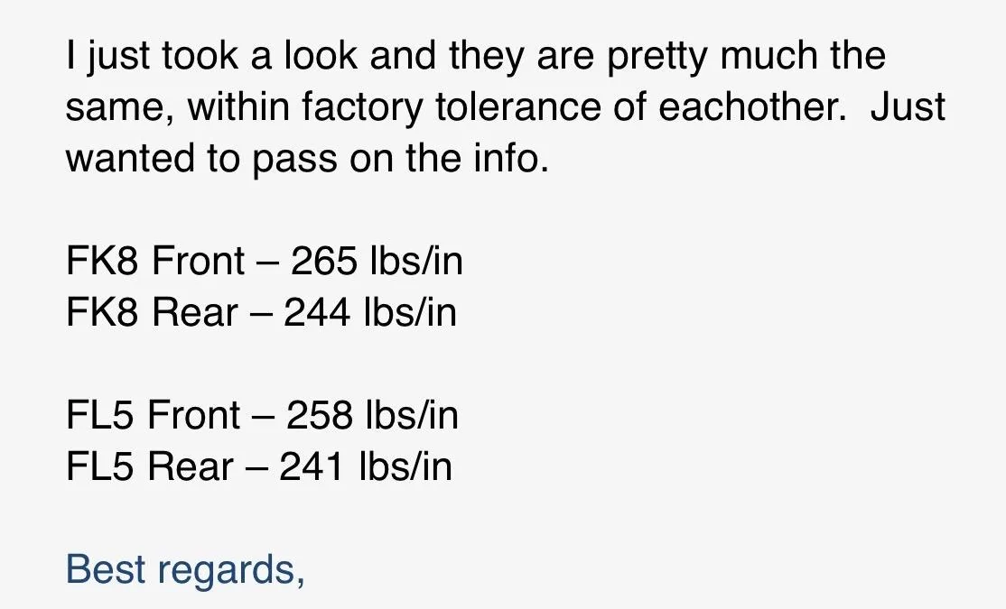

Agreed … I love the ride and drop on my FL5 with the H&R springs…
And here are the spring rates that Eibach tested out FK8 vs FL5…..
Pretty much the same spring rates.:wave:

Interesting. Definitely no need to wait for dedicated FL5 springs then.
Just because the stock spring rate is the same for both FK8 and FL5 does not mean there is no point of waiting for FL5-specific springs. People who develop springs for FL5 may have a different take on what they believe is good with this chassis. At least the FL5 is slightly heavier than FK8. So it's not a bad thing to wait, but you can still get the FK8 springs if you want to lower a FL5 now.
