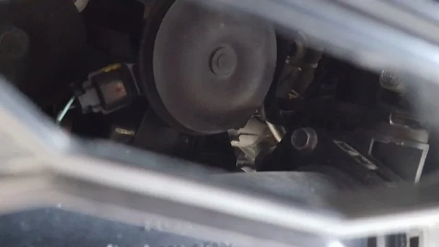

What is the best way to access the ECT2 sensor to unplug the harness from the radiator? I have an all white connector and pulled on it and it wouldn't come off. What do I do to get it off? I pulled off the long black floor pan to access it. Should I have bent the short floor pan flap in the corner down instead? I tried to install it twice and still am out of luck.

you take the undertray off and you have access to it. no need to bend anything
That plug is usually not much trouble. Remember that it is plugged directly into the radiator.

Which under tray? The aluminum one? The long black plastic one? Or the short square one in the corner?

There's only one undertray... the big aluminum tray one to access your engine bay

I was wrong in that the white thing I showed in my photo was not the ECT2 connector.
