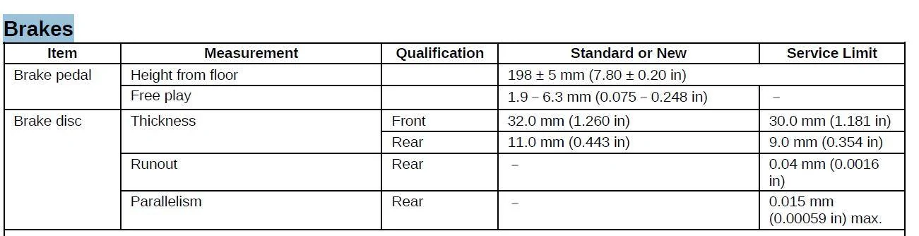

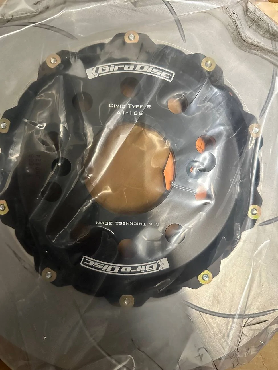

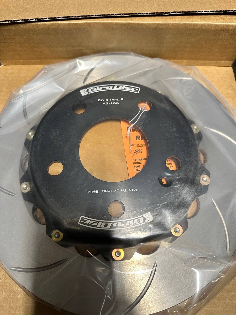

Do you know of measurement of when its time to replace the OE or the Gridisodic rotors? I bought a rotor measurement tool so I can start measuring mine
The Goodyear website would be only of the Goodyear Supercar3 (SC3), not the Continental ECF. You'd need to go to TireRack or TrackDayTire for the ECF.
I do not know the min thickness for the OE Rotors. I believe the Girodisc Min thickness is 30MM, but you'd have to double check what the rotor hat says -- it's printed on it.
