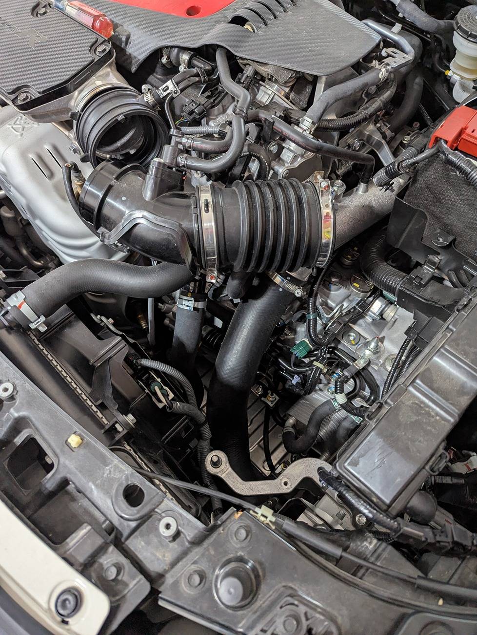

It's a quick install *until you destroy that goofy 1-time-use hose clamp on the intake for the breather hose and don't have quite the right size in your garage inventory, and need to run to O'Vance Autopartszone, and then it's about double the time it should be. ?

This is also about the time some sales guy tries to schedule me for a conference call in 10 minutes ?
