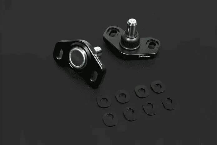

Optimum camber does vary on the tyre - I'd call myself a track veteran with the fastest posted FL5 times on the major race tracks in my state. The Log R calls me an S+ driver if its anything to go by. The below has been my personal experience on the FL5 so far - running RE71RS 275/35R18 on TE37SL 18x9.5 +45 on stock suspension.
I ran -1.8 front on the first time I went out (which was stock just with the pins removed like yours) and found it was definitely not enough - with a lot of feathering on the outside shoulders.
I installed the hardrace lower ball joint for FK8 which works perfectly on the FL5, set to the middle sitting, to achieve -2.7 and found the tyre wear much improved on the 2nd time out. It could have done with a touch more camber by maxing out the ball joint setting and bringing the strut tops back out however I believe this would have the effect of pushing the wheel outwards and minimizing the tyre to fender clearance. The other option is to go coilovers with adjustable strut tops to give you greater range of adjustment. Or the balade FK8 camber plates which will work however it would introduce some NVH as all pillow ball tops tend to do - so at that point you might as well have gone coilovers. It took me around an hour a corner to install the ball joints being my first time - it could be done in less.

At least on the FK8, those camber plates won't work with stock springs. It's better to get lower ball joints instead.

As a side note - the hardrace lower ball joint is advertised to increase negative camber in 1 degree increments - however I have found it closer to 0.9 degree's per increment. This however could be due to inaccuracies in my camber gauge or discrepancies during installation (some potential slop between the bolt and the bolt holes of the flip chip).
