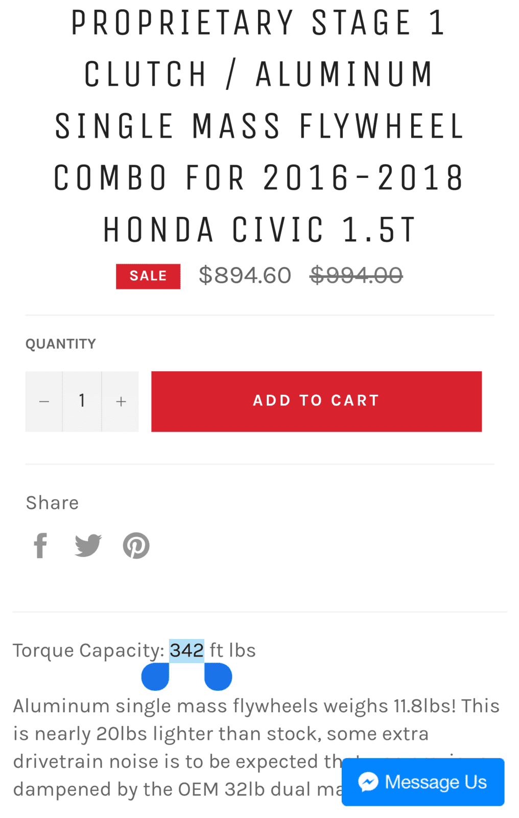

The stage 1 clutch only holds 236lbs of torque.

Something tells me the Stage 1 can't hold that much torque, that's a lot, but then 236 is very little.
This is the "normal / factory style" Stage 1 for the factory dual mass flywheel. I would not recommend this one.
This is the "Proprietary" Stage 1, for use only with a matched SPEC single mass flywheel. It will indeed hold 342lbs at the flywheel, but remember this translates to about 290ft lbs at the wheels.
For most people I am recommending the Proprietary Stage 2+, which will conservatively hold 380ft lbs at the wheels while still being very street friendly.
See above. :)
