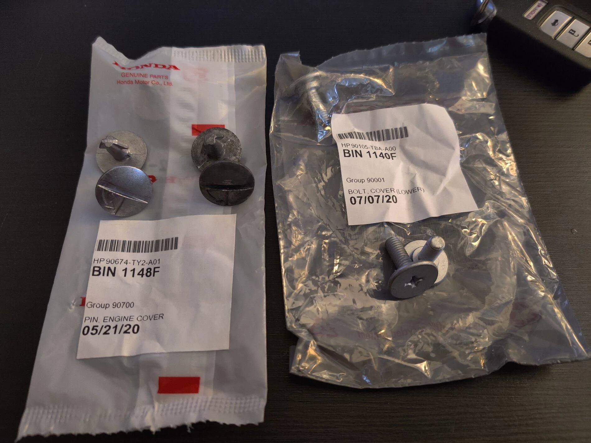

Working on the car last night and the original metal screws were in extremely tight. One of the phillips head screws stripped.
Does anyone have part number for the phillips and flat metal screws for the metal skid plate?
The only ones I've found were from a 10th gen, which look to be the same:
Here's the part numbers:
(need 6) Quarter turn fastener: PIN, ENGINE COVER 90674-TY2-A01
(need 2) Front screws: BOLT, COVER 90105-TBA-A00
11th Gen Honda Civic Skid Plate Screw Part#s img_20200725_175325-jpg

They should be the same, I notice one of mine was missing, so I bought set from ebay. but in FL5 you would need 4 screws instead of 2.

They're still the same between the 2 generations. I always buy mine off of Amazon, I get a couple sets at a time just so I have a few extras.
