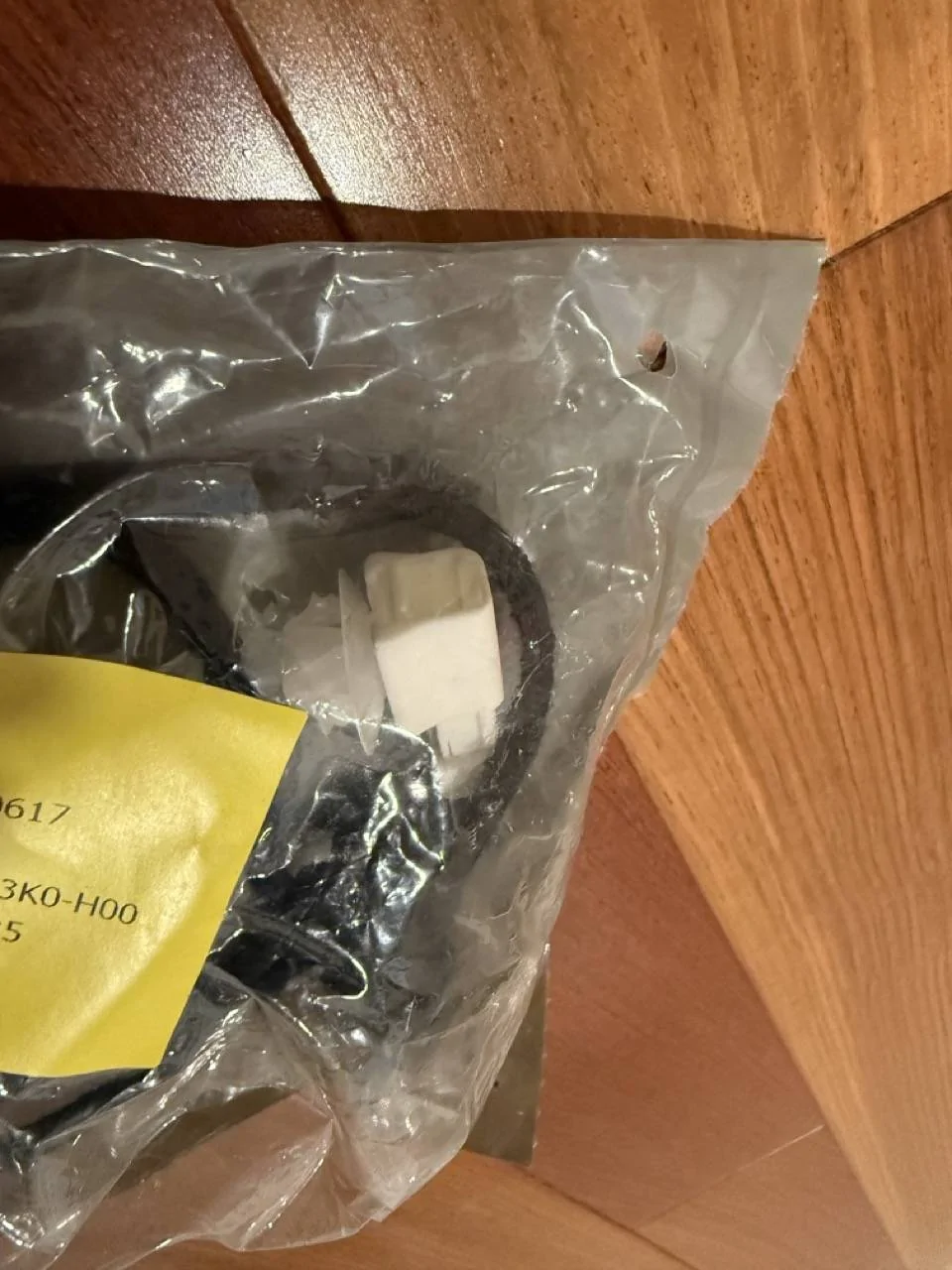

Not yet, I just received the parts. The problem is that the harness, 32114-3K0-H00, doesn't fit the USB-C. I plan to stop by the dealer next week and hope one of the technician can help me to find the right harness.

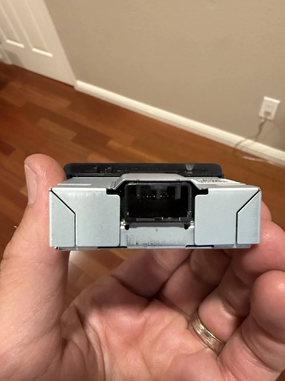

Mind taking a picture of the rear connector of the USB hub and the harness so we can see the difference?

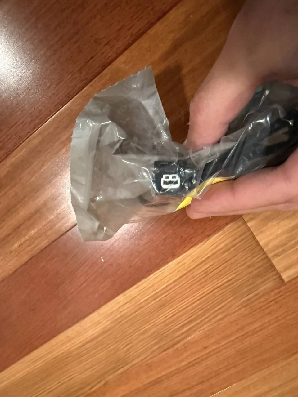

I noticed the Integra A-Spec has different harness: 32114-T20-A40.
Maybe that harness has the right connector.

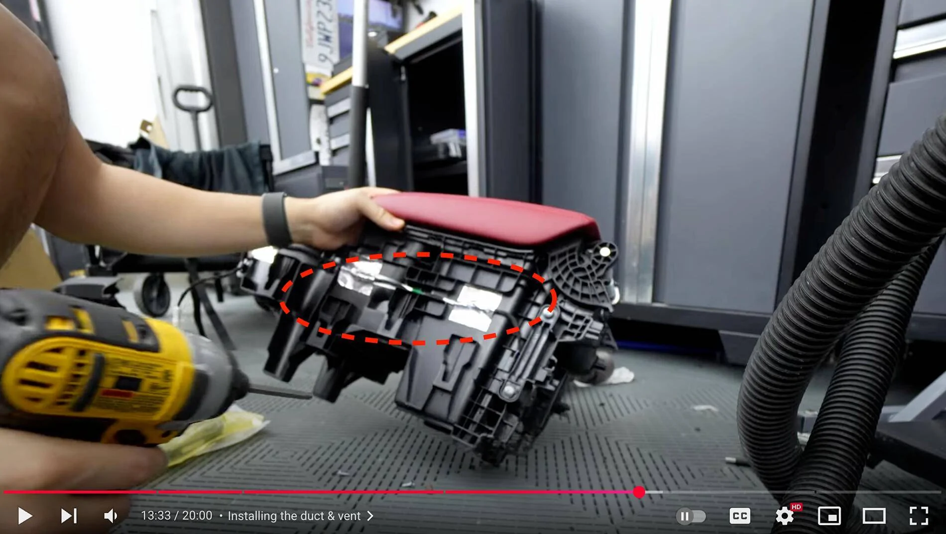

- I saw this video (scroll to 13:00 min) posted by a member from Integra forum. He took apart the rear console and it looks like there is a cable inside the panel that came from factory. I wonder if it's the harness to supply power for rear USB-C?

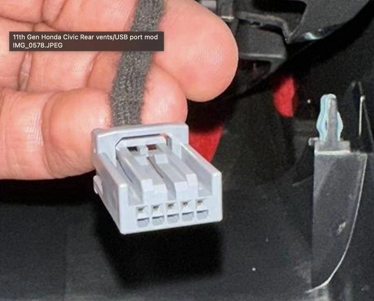

The connector at the back of the USB USB looks same as mine. The harness end looks the same as well.
How did you pull the connector out? I took off the rear panel and I see the cable on the side. But is it connected to some plastic to hold it?
I plan to remove the whole console in a few days anyway. Just curious now :)

I ordered the 32114-T20-A40 harness. It should arrive in a week or so.

One more note:
This cable is not related to the USB/rear vents. This goes to the immobilizer/key sensor held in by those two screws just outside/below the circle.
Right, I just read about it recently. It's still unclear how the rear USB-C is wired in Integra A-Spec with Tech Package. I thought that 32114-T20-A40 harness have some split cables, one part goes to the immobilizer/key sensor, and second goes to the rear USB-C. That's why I ordered the 32114-T20-A40 harness to try. Unfortunately, the dealer advice of using 32114-3K0-H00 was incorrect.
