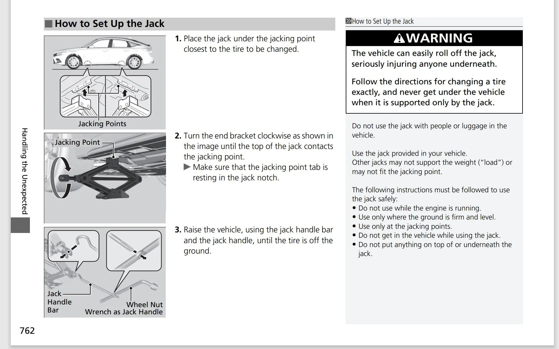

I have to ask, though, where are you seeing that Honda doesn't recommend using a jack on the pinch welds? I checked in the owners manual (PDF version) and it seems to show the use of a jack on the pinch weld for tire changes. (Granted, this seems to be a universal manual for all 2023 Civics so I guess the Type R might be different?)

Hmmm…click that link I posted earlier and read the fine print (in the diagram). It says that if you don’t use those 2 jack points you could cause deformation / damage. Clearly the diagram is the underside of the FL5 too.?
I assume that the pinch welds are OK for use on a lift, as you’re applying equal pressure at 4 areas. But for jacking the car up, I think you need to use the 2 specific locations. This tracks with what others were saying ; Use the pinch welds to lift the car up enough to allow some clearance to then slide another jack under the car to reach the jack point.
Our owner’s manuals leave a lot to be desired. They don’t even list the break-in procedure, while EU manuals do. I wouldn’t trust what’s shown here for use with the FL5, but that’s just me. It’s in a section called “Handling the Unexpected” and is citing the use of specific tools (including the spare) that come with other Civics. To me, this means this section of the manual doesn’t apply to the FL5, but I am not an expert.

No issue with using the pinch welds to jack up the car. Since the pinch welds are present on lesser Civics and can be used to lift the car, it stands to reason you can do the same on the FL5. The spare tire kit is optional for the FL5 - how else would you use the scissor jack to swap out the wheel? That would be a senseless design flaw otherwise. Plus, you're only lifting up a percentage of the car's total weight. To me, that diagram in that other link is just ignoring the obvious, since many cars have jack points inboard of the wheels. The two points that are explicitly shown may differ among cars in their locations, hence the indication.
If the manual doesn't distinguish models, it is for all models in the book.
If anything, the added glue/welds on the FL5 would make it easier to lift two wheels from the pinch welds, but I wouldn't do it that way.
Drive up on 2x4s or if you don't want to risk it slipping out or placing it right, use your jack under the pinch welds to put one or two 2x8s under the front wheels (depending on how low your jack is), then jack the center point. Or get race ramps, etc.
