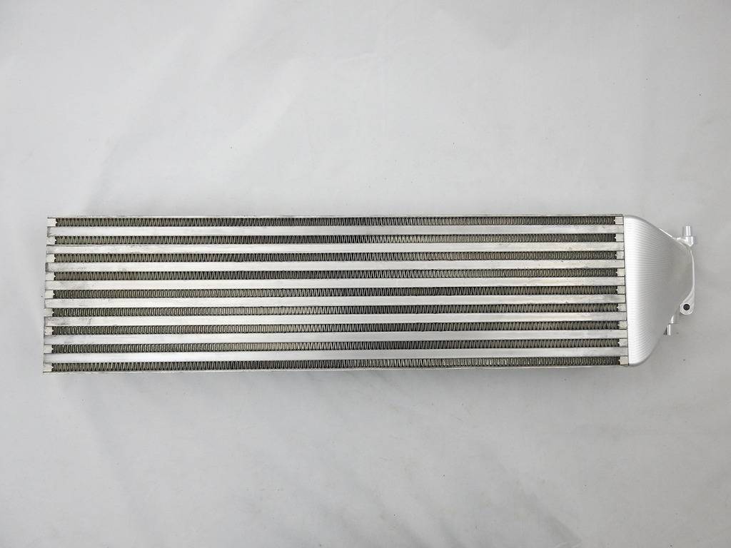

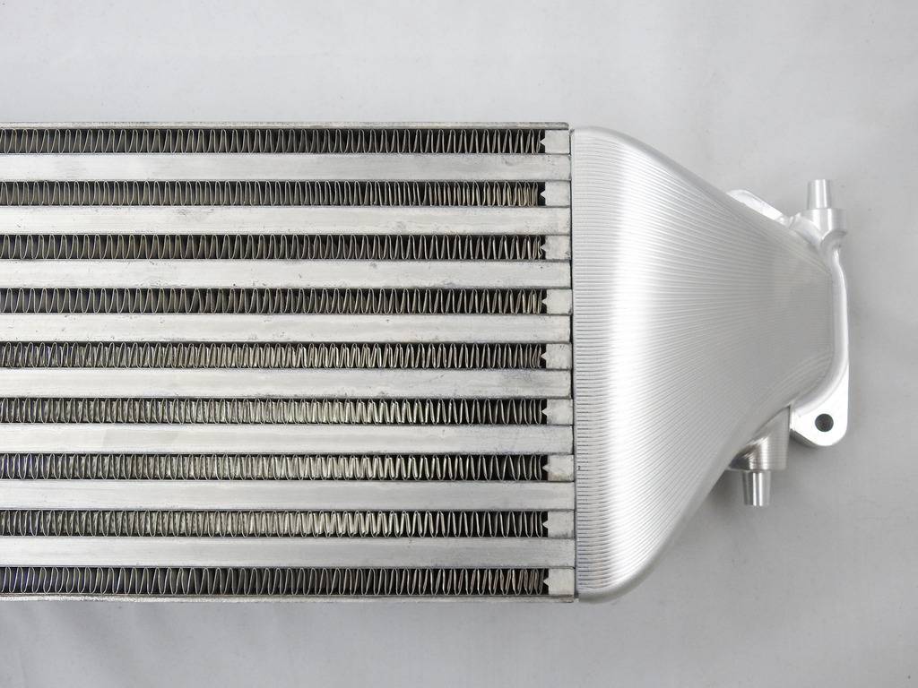

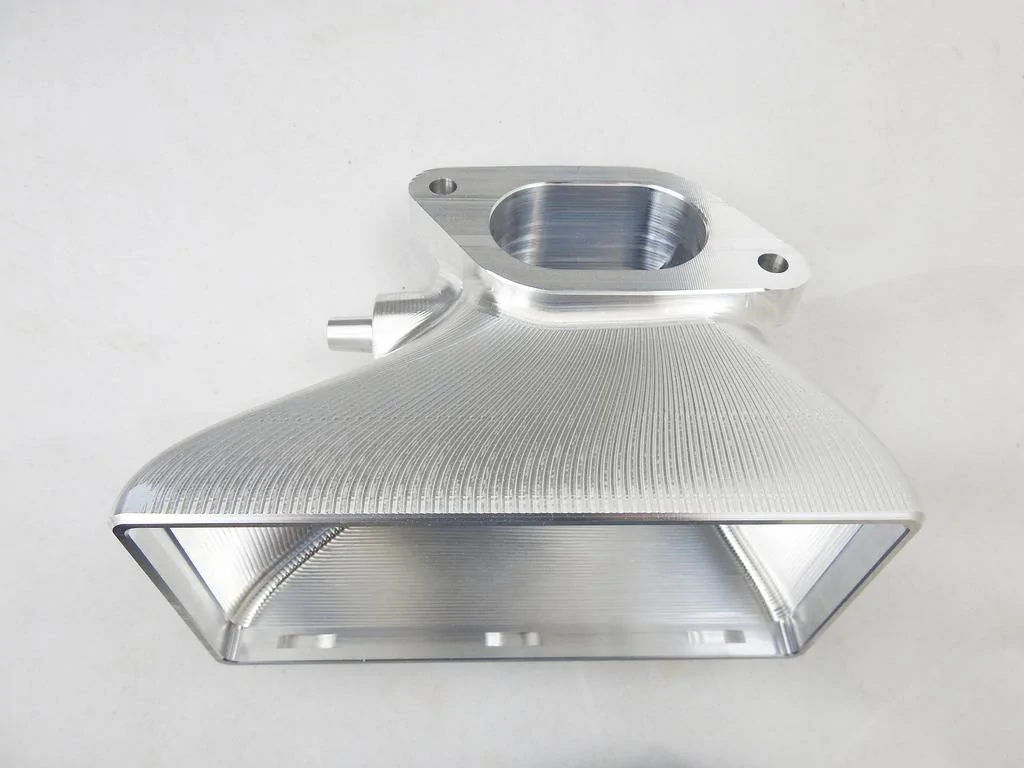

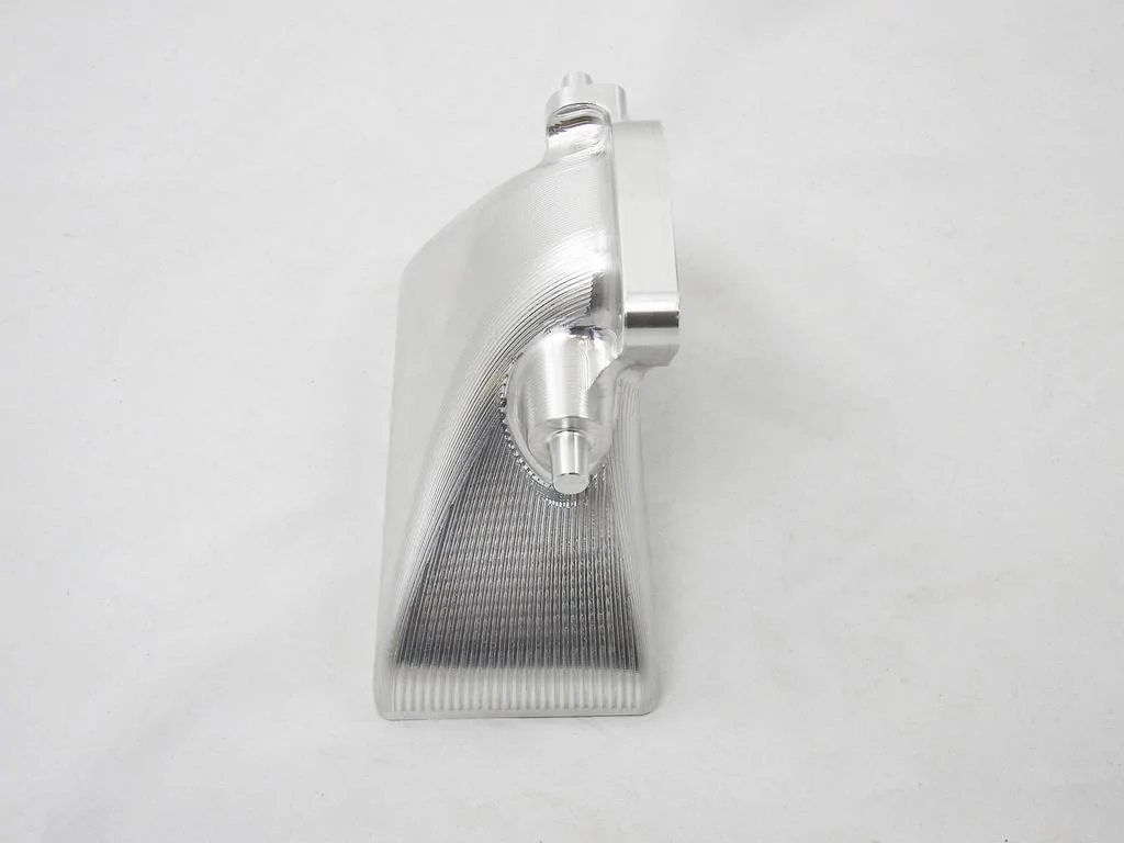

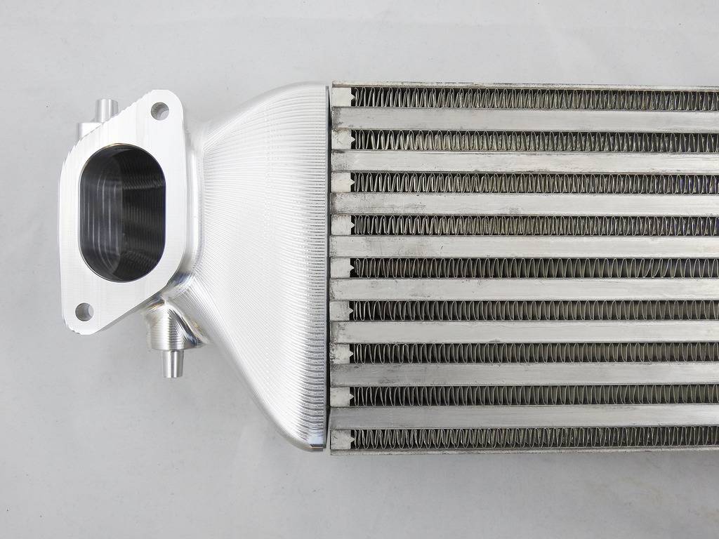

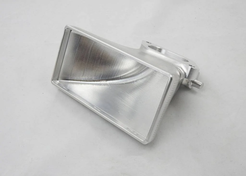

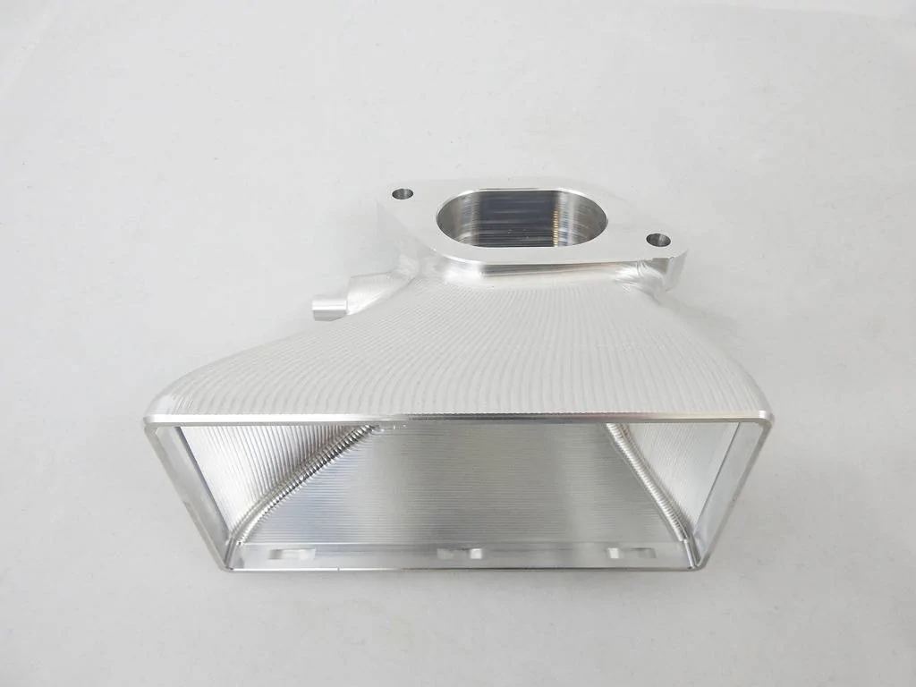

Prototype intercooler cores have arrived as of a bit over a week ago. Here's a sneak peak an unfinished prototype end tank. ;) We are still working on tweaking final machining for a bit of a smoother look. Stay tuned for more pictures and testing!

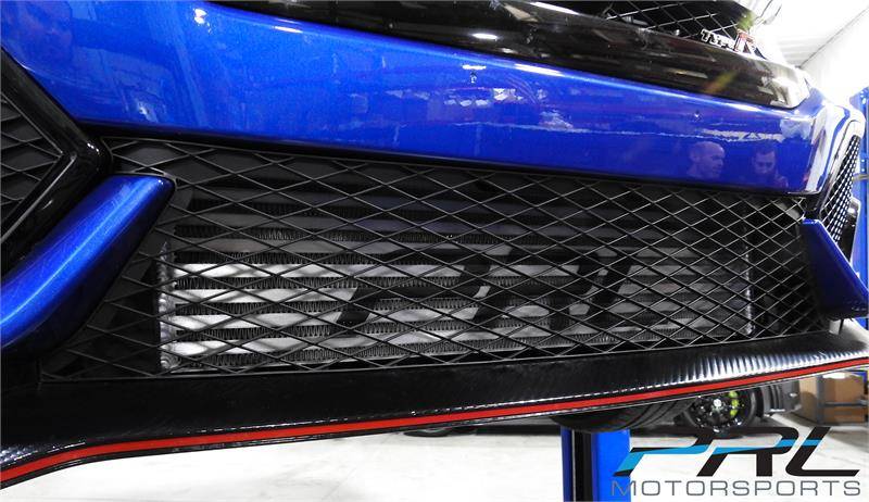

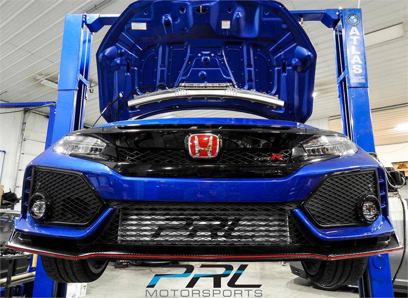

We've decided to kick off our FK8 Pre-Order Sale, so here are some installed pics! :thumbsup::headbang:

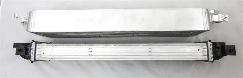

Now onto the technical stuff.

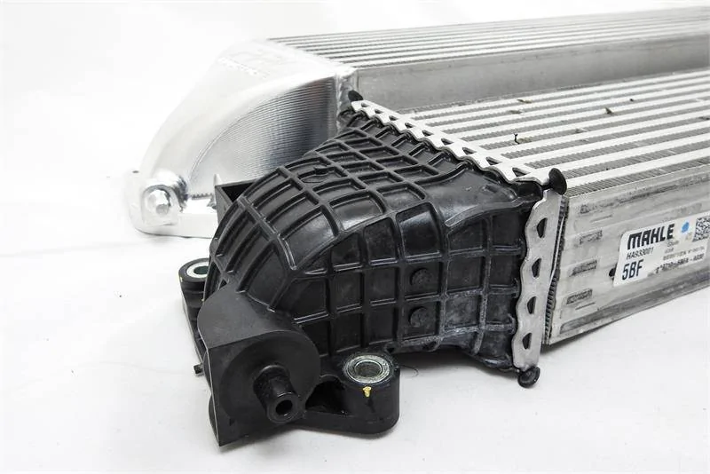

Our 2017+ Honda Civic Type-R FK8 intercooler upgrade features a dense 550 HP bar-and-plate intercooler core which increases surface area by 85% and internal flow by 83%. We designed this core for optimal efficiency size for a variety of power goals. Spool/response is actually increased with the factory turbocharger and there is still plenty of head room for future big power goals.
No cutting or trimming is required. FMIC bolts up to factory charge pipes and air guides.
Specs:
  • Power Rating: 550 HP
  • Core Size: 26.5" x 3.5" x 7.0"
  • Fin Style: Bar-and-Plate
  • End Tank Design: 5-Axis CNC'd Billet Aluminum

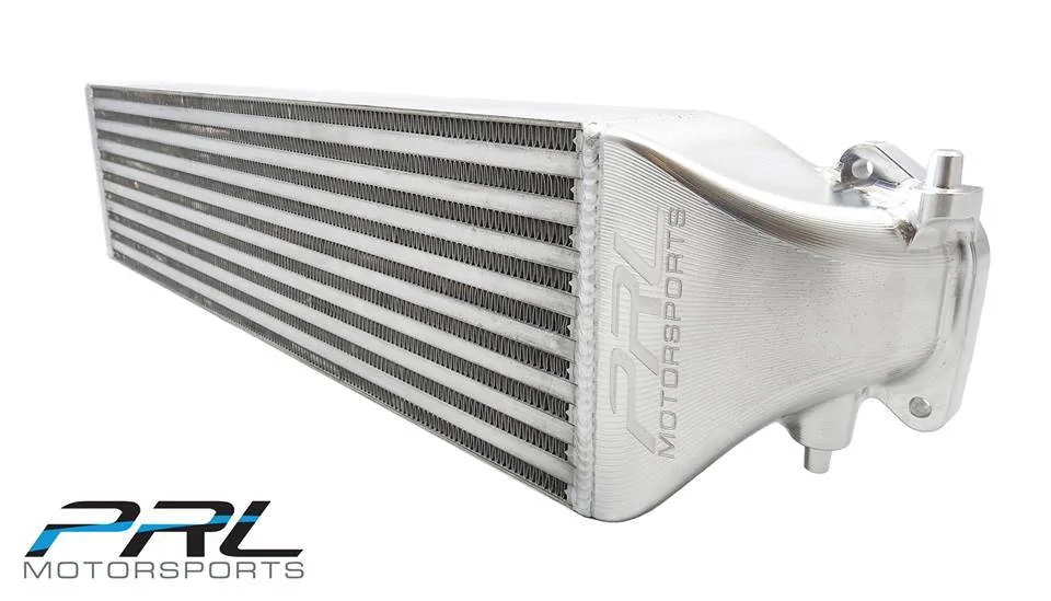

Type R Intercoolers are in stock now!!! Since we've added another 5-axis machine we are able to ramp up production here at the shop to meet demand.
