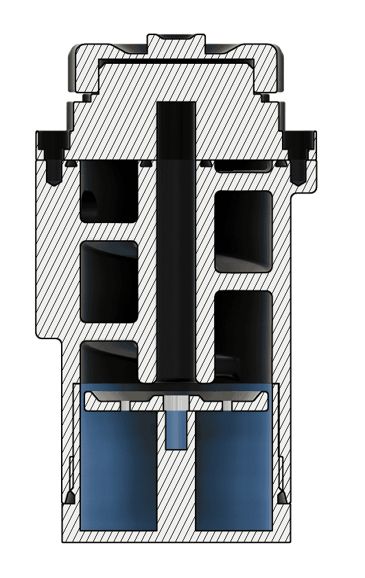

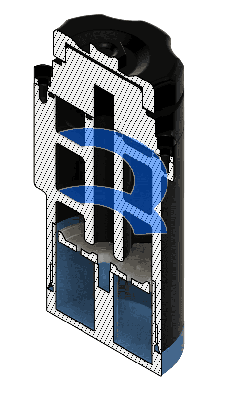

So, what makes our catch can different? There can’t really be much innovation in a product that’s so commonly sold in the automotive aftermarket can there? Besides looking into ways to make the AOS universal and easy to maintain as possible, the key was to look outside of our industry and into other applications, where air-oil separation is much more critical to maintaining a healthy system. Specifically, we’ve looked into industrial applications like air conditioning, and gas pipelines. This research has led us to design a catch can with a helical cross section, where some industries report helical oil separators offering 99% to 100% efficiency in oil separation with low pressure drop.
11th Gen Honda Civic PRL Motorsports Air / Oil Separator Product Development - Revisited CC10.PNG
Upon entering the oil separator, air-oil mixture encounters the leading edge of a helical flighting. The mixture is centrifugally forced down along the spiral path of the helix, causing the heavier oil particles to spin to the perimeter, where it encounters a wall. The separated oil then flows downward along the boundary of the shell through a baffle and into an oil collection reservoir threaded into the bottom of the separator. The specially designed baffle isolates the oil collection and eliminates oil re-entry by stripping excess oil particles from the air and preventing turbulence.

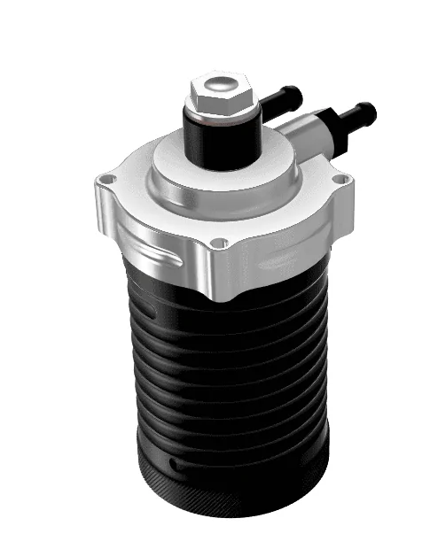

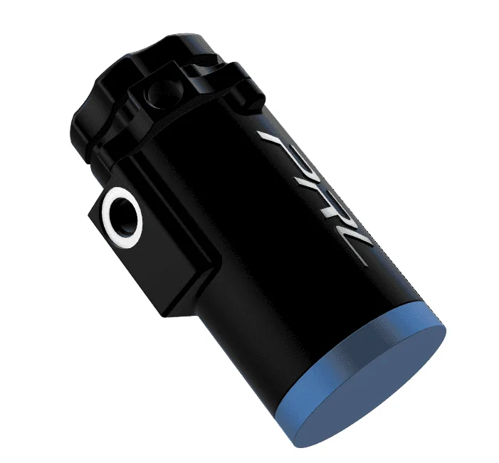

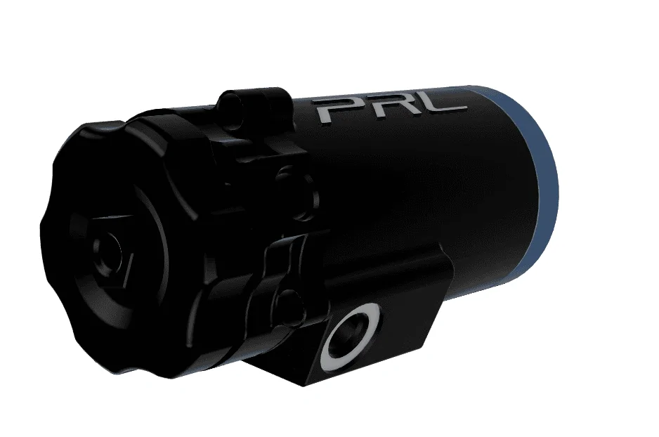

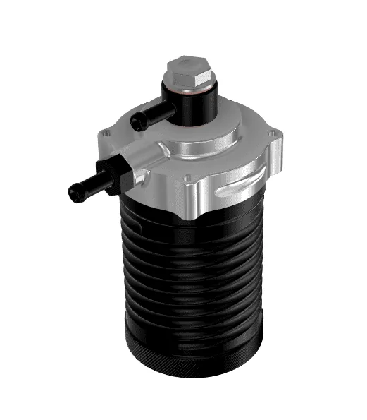

You may notice that the visual design of our catch can looks much different than it did in the previous blog post. This is because we have decided to switch manufacturing techniques to help expedite the production timeline and allow us to bring more production in-house. We redesigned the canister body to be billet 6061 aluminum, as well as accept a separate billet helix center section with an integrated spiral baffle plate. This design change, however, wasn’t just to offer more billet bling (although it does that pretty effectively now), the functionality has also been improved. Due to the divorced helix, as opposed to integrated with the previous design, we will have clearance between the edge of the helix and the interior walls of the can. This means that excess oil vapor, in addition to collecting on and running down the helix, now has the ability to sling outwards, collect on the walls, and drip down to the baffle plate. This maximizes the amount of oil separated from the intake air. We also added some slick external helical profiling and knurling on the out side of the can for aesthetics and function.
First article prototypes are currently in production so that we can begin final test fitting and data collection. This AOS should be available this summer - stay tuned for pricing expected release date!

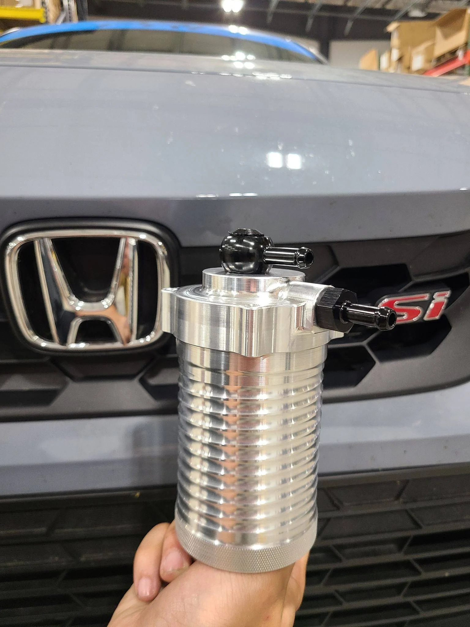

Here's a first official look
11th Gen Honda Civic PRL Motorsports Air / Oil Separator Product Development - Revisited 1f440
at our Helix Air Oil Separator (patent pending) functioning prototype! This AOS will be compatible with most modern Honda/Acura applications. We are still on target to have these available by the end of this summer. Stay tuned for pricing and expected release date.
