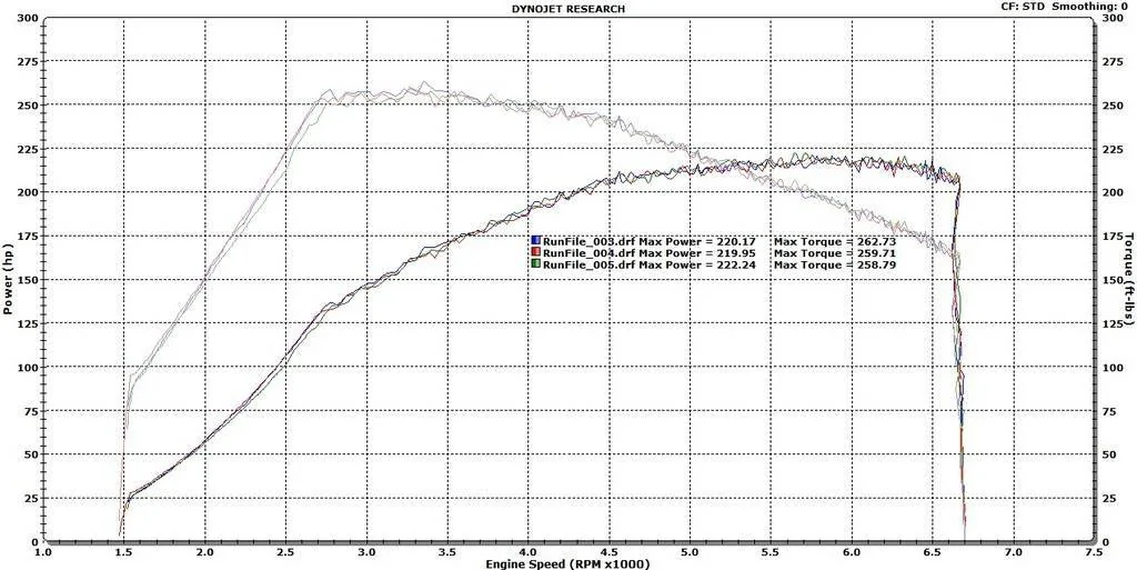

11th Gen Honda Civic PRL Motorsports 1.5T Cold Air Intake Development / Pre-Order Eric%20Street%20MAF_zpsjsgpfj6l
We performed 3 consecutive dyno pulls with the Street MAF housing starting at 175 degree coolant temps to around 180 degrees. The car put down similar consistent numbers within a 3 horsepower and 4 ft/lb tq window.

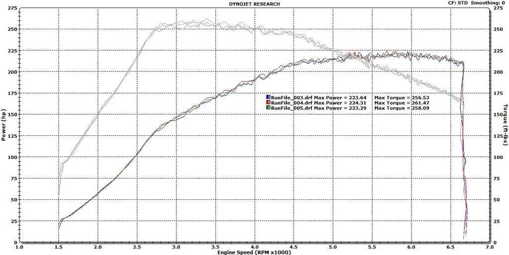

11th Gen Honda Civic PRL Motorsports 1.5T Cold Air Intake Development / Pre-Order Eric%20Race%20MAF_zpsqijaoiv
We performed 3 consecutive dyno pulls with the Race MAF housing using KTuner's Race MAF basemap starting at 175 degree coolant temps to around 180 degrees. The car put down similar consistent numbers within a 1 horsepower and 5 ft/lb tq window.

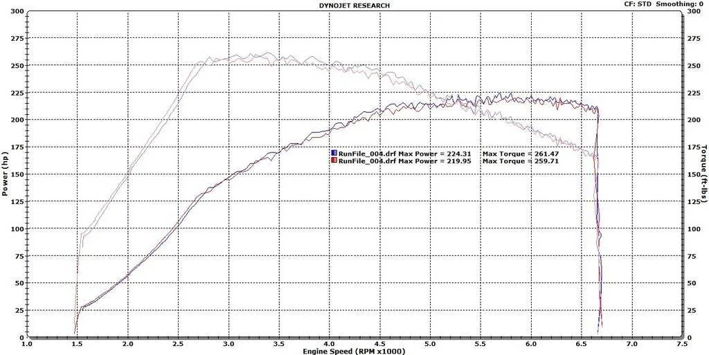

11th Gen Honda Civic PRL Motorsports 1.5T Cold Air Intake Development / Pre-Order Eric%20Street%20vs%20Race_zpsyslecs0y
We used "Run 4" as an average comparison due to identical run conditions. The Race MAF provide a 4-5 hp and 2 ft/lb tq gain at peak and 10hp/10tq gains throughout the midrange over-top of the Street MAF. Another thing to note is the fact that knock control continued to decrease with the Race MAF housing. We started the runs at .65 knock control and continued improve to .45.
In case anyone was unaware, KTuner now offers safe and effective Race MAF housing-specific basemaps for our cold air and short ram intake systems. The Race MAF housing provides nice little gains up top and very notable gains throughout the midrange.
