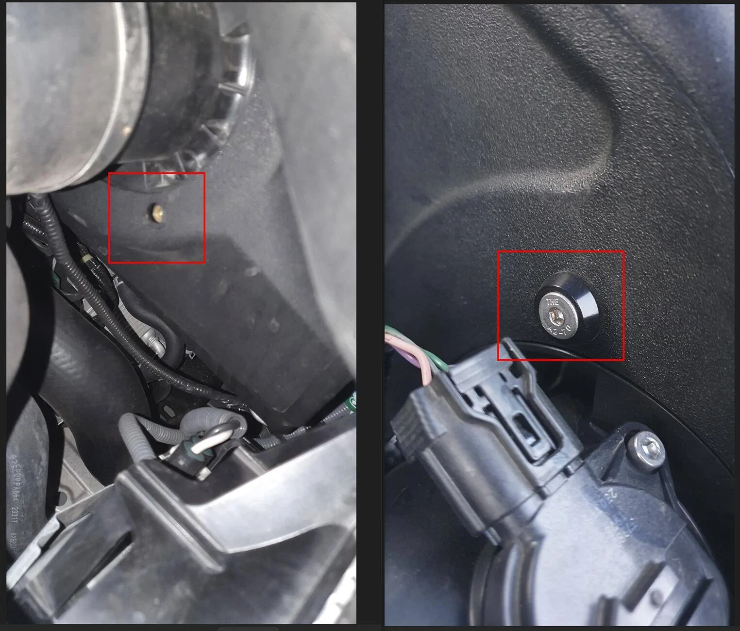

Has anyone lost a PRL HVI filter mounting screw and knows where to get one identical to the one PRL uses in their set?

Yep happened to me. I contacted PRL for new ones but they took a while so ended up just getting some from amazon instead. I used blue thread-locker and it has been good so far.

Anyone missing screws shoot [email protected] an email & ask for a set of PRL2.1032.12.0. We will get you taken care of! Due to the high amount of CS tickets, sales will be able to get you guys taken care of much faster.

I reached out as Im missing a couple of bolts and one is loose. They wanted to create an invoice and bill me. I will just find something local that will work.

You should not be charged! DM your email to me & I will get it taken care of personally.

I've heard of the issues with the screws falling out, which is not good at all and not confidence inspiring, but to add to it by charging you, or having to wait 6+ months for a design defect, that's crazy.

I have. You can find the actual screw on Amazon. I have like 100 of them now. Finding the same washer was tough so I just bought new ones that look similar.

just to clarify here, when you open the screw page the default shown specification is M5 x 12mm, is that the correct screw or do I need to navigate to a different specification of screw shown on the page?
lost my first one today off of the air filter mounting side on the PRL HVI. looking to pick some of these up to keep on-hand along with some blue loctite...

Yeah they are M5 X 0.8 X 12

The correct screw specs are M5x0.80x16mm. We made the bolts longer. The issue with the 12mm is that the threads did not go deep enough to get the loctite to bite in the threads.

Ahh the instructions on your instructions (still on your site) lost it as 12mm.
