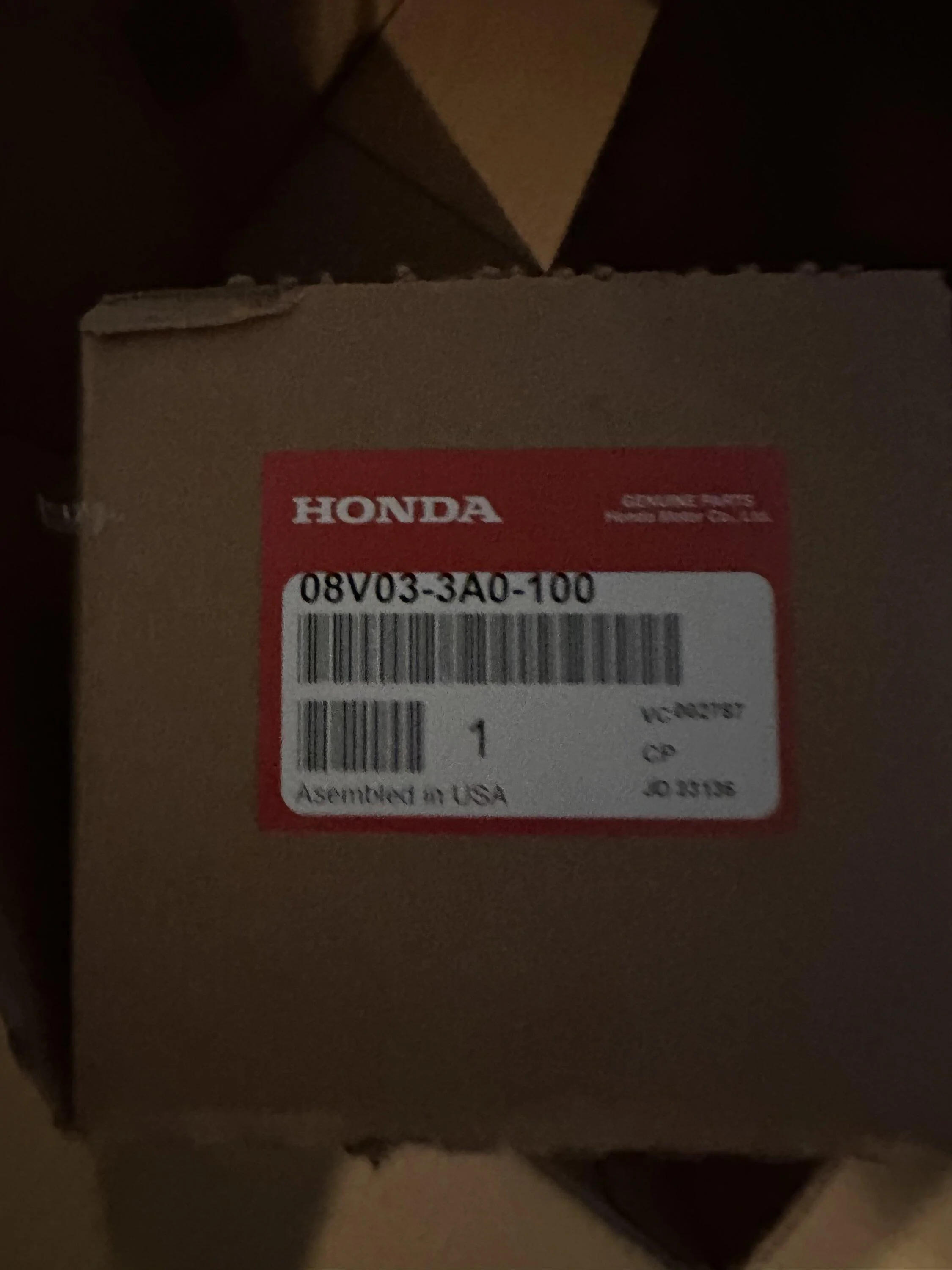

PNs are in the OP. If you order from college hills Honda, you order the mirror and the harness is a check box with no listed number - until you get the confirmation email.
Here is what will be needed.
Plug and play harness 08V03-30A-100
Homelink Mirror 08V03-3A0-100

Thanks for confirming. Items on the way!

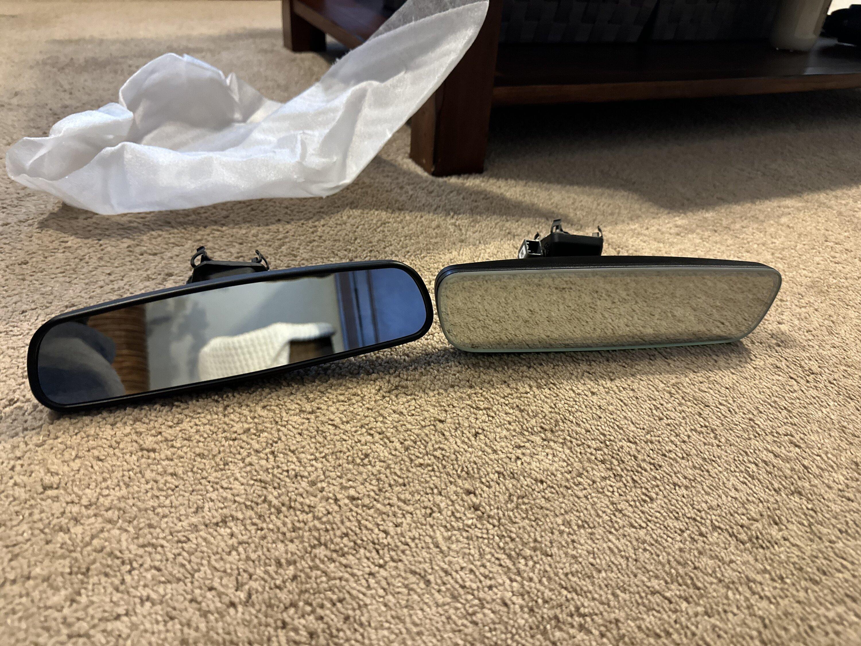

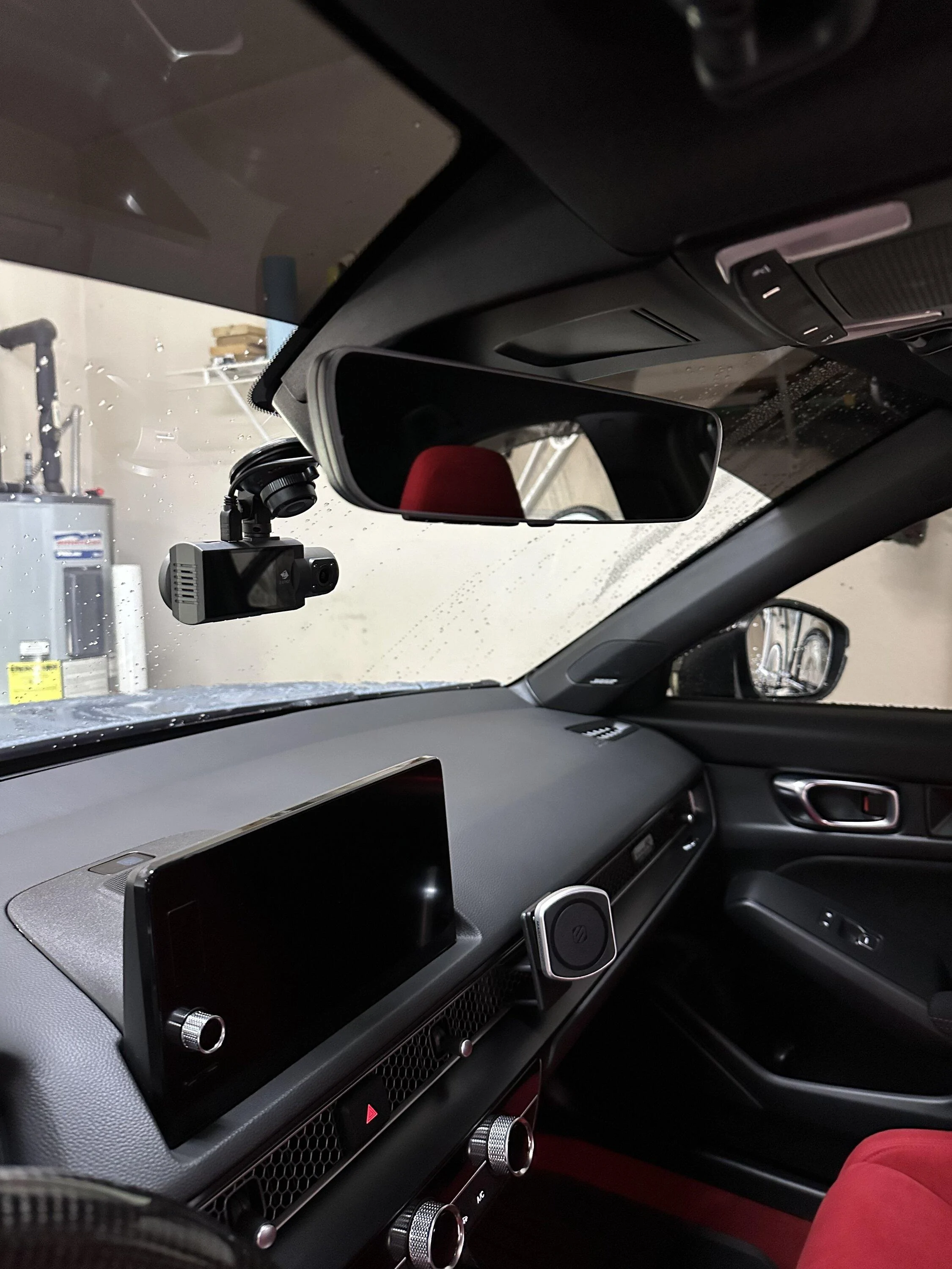

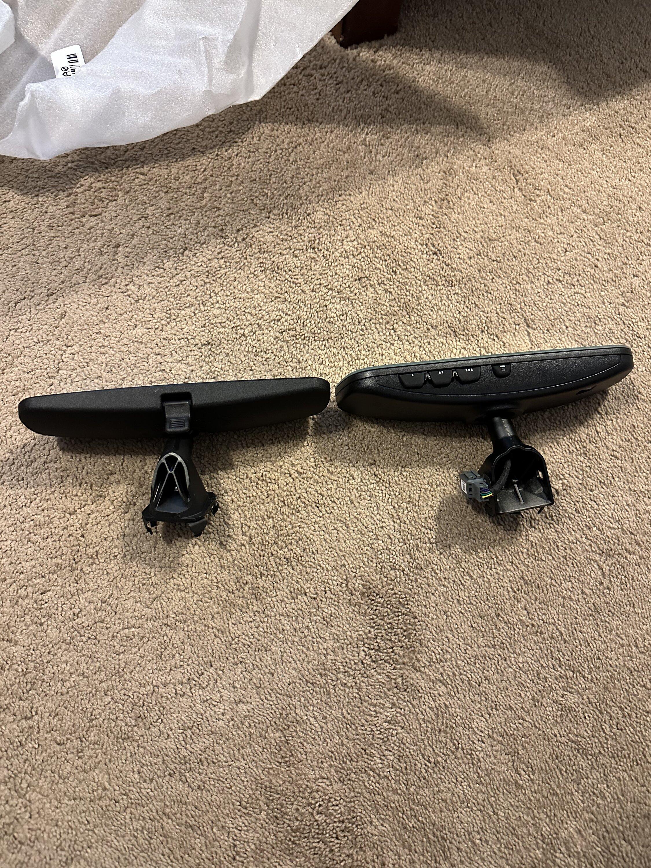

Did the same mod today! Took me about an hour. Absolutely love it. Might be a dumb mod to some lol but not only does frameless look better, no more keeping a garage door opener in car. Plus it’s auto dimming. It’s great that it’s also plug and play. No wire splicing.

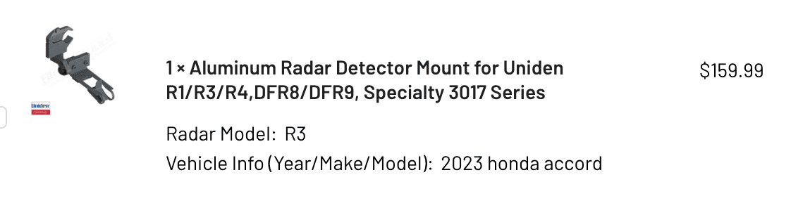

Blendmount is a very tight fit.
I had to use https://blendmount.com/aluminum-rad...den-r1-r3-r4-dfr8-dfr9-specialty-3017-series/
Notice the mount touching the plastic trim piece has a felt to prevent rattles.

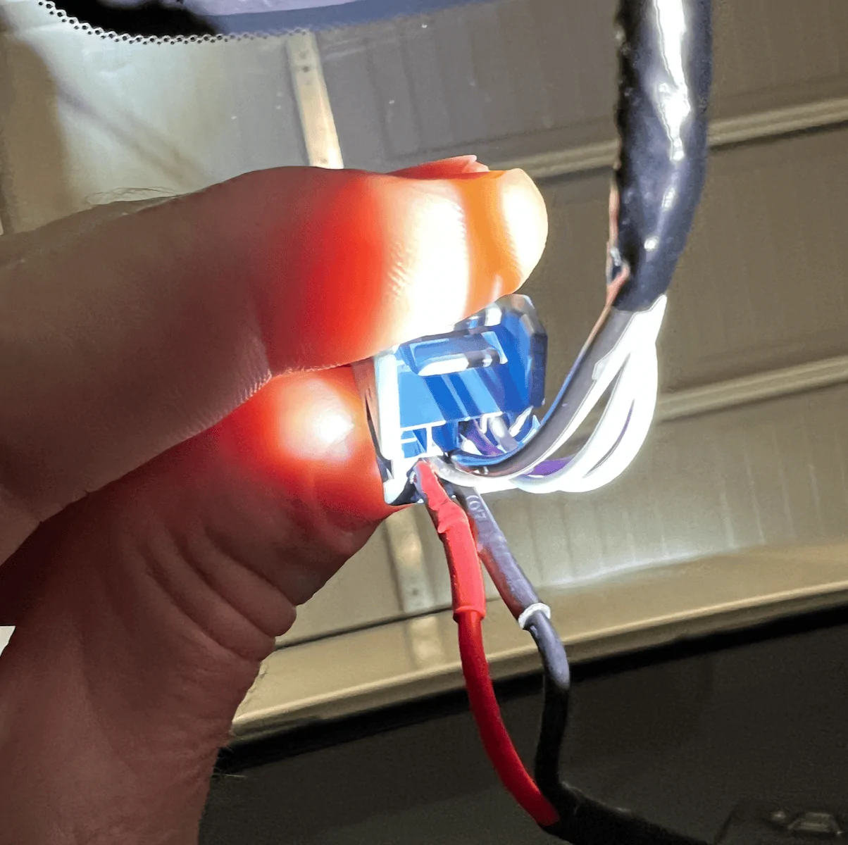

This is how I got power that was switched.

Just installed this, anyone feel like the home link mirror doesn’t clip on as strong as the original one? (Those 4 prongs holding the mirror onto the base)
