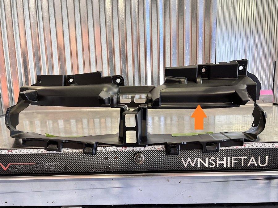

The ducting to the intake box on the EX was the most “basic” setup we’ve seen. It mounts to the crash bar and header panel and has two chambers to help guide air that comes through the grill. The driver side of the “upper plate’ does have a very small bump (orange arrow in image below) to direct air into the airbox. If you were not looking for it then you might miss it! So while it’s small. at least there is something there.

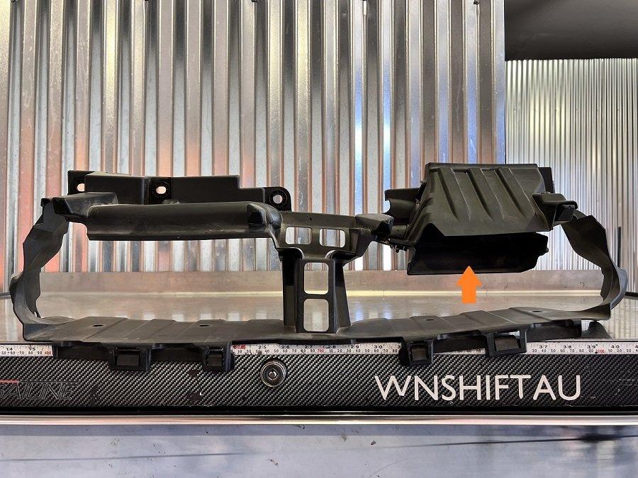

For the 2022+ Civic Si the inlet ducting design is better than on the EX.
Again you see the two main chambers to direct air but this time we see a larger path for intake air. There is a sealed channel to direct air into the inlet of the air box. This duct forces cool outside air into the intake to make power. This is the kind of design we like to see. It gives an easy path to get air into our engine to let it breathe.

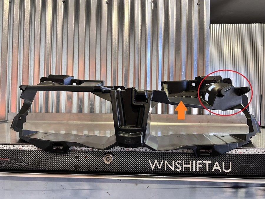

On the 5th Gen Integra A-Spec you see the same two primary chambers but this time the air intake channel is kind of in the middle between the EX and Si. The intake duct does not provide a fully enclosed path for air like the Si so it’s closer to the EX. One thing in the way however is the car horn. The red circle highlights where the car horn sits behind in the grill. We will likely relocate the horn to get a better and more direct air path.

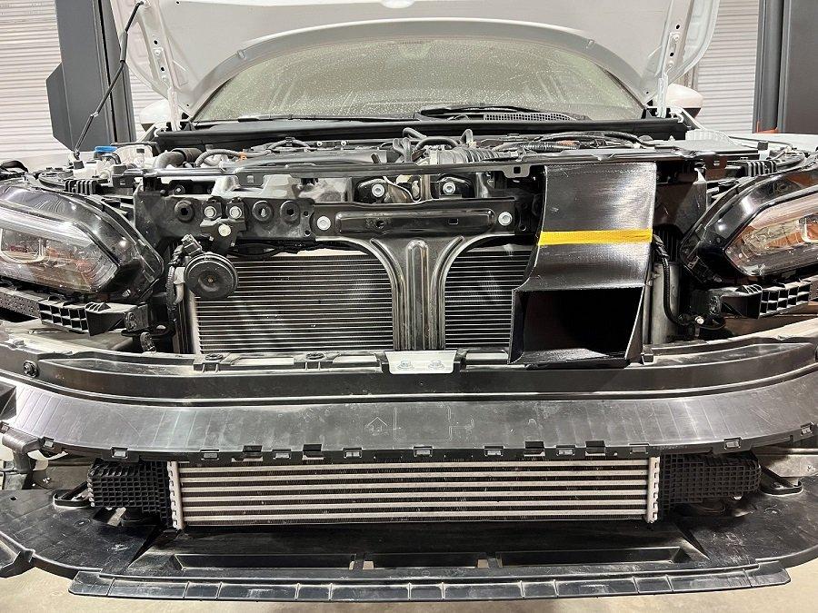

Now you have seen three different OEM set-ups for 2022+ Honda/Acura L15 engines. What are we thinking? Well, OPEN WIDE. We want a big mouth for optimal sucking. Check out this very early sneak peek at our prototype snorkel design in glorious 3D printed fashion.
IN OUR NEXT BLOG, WE’LL DIVE INTO THE DETAILS AND SHARE WITH YOU EARLY PRODUCTION SAMPLES.
